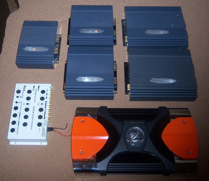

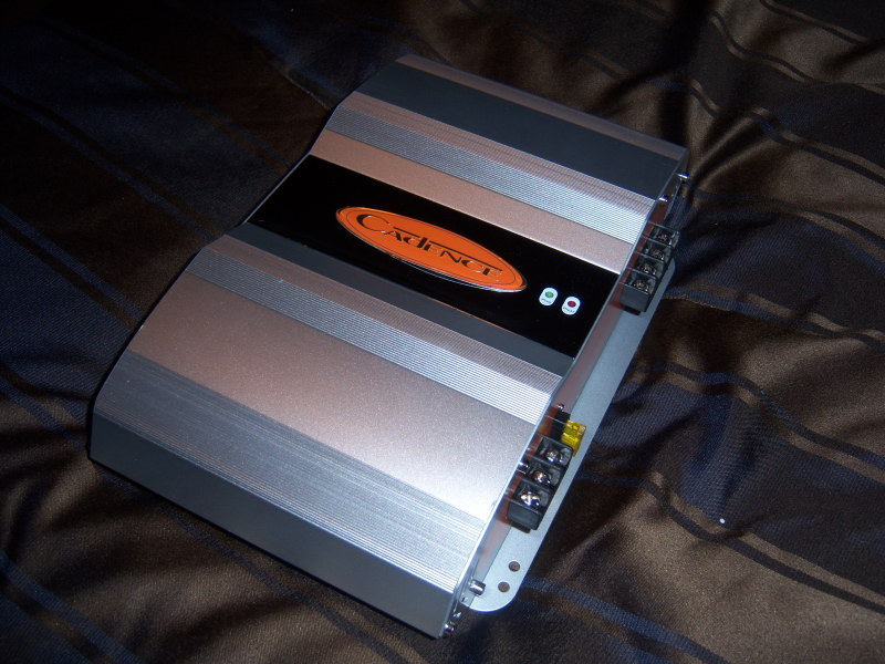

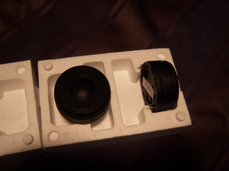

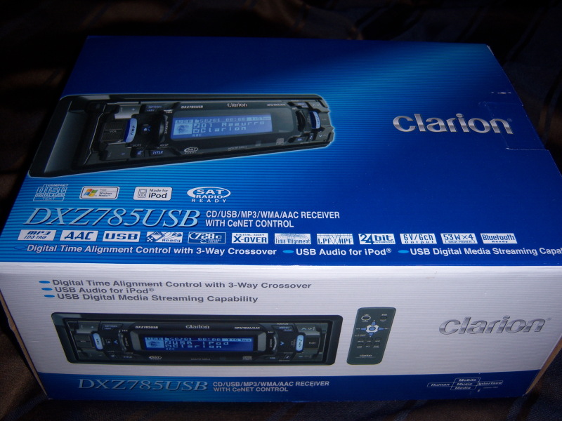

Alright, I was going to wait till I had a bit more done but I couldn't help it. I started work today on my e28 535is. I got the power wire run although I didn't get pics of it. I also started fab on my custom rear deck IB setup. The setup will be:
Clarion DXZ785usb
2 US Acoustics USX2100's
1 Cadence VA300
1 Cadence Z9000
Vifa/Peerless d26nc-05 tweets

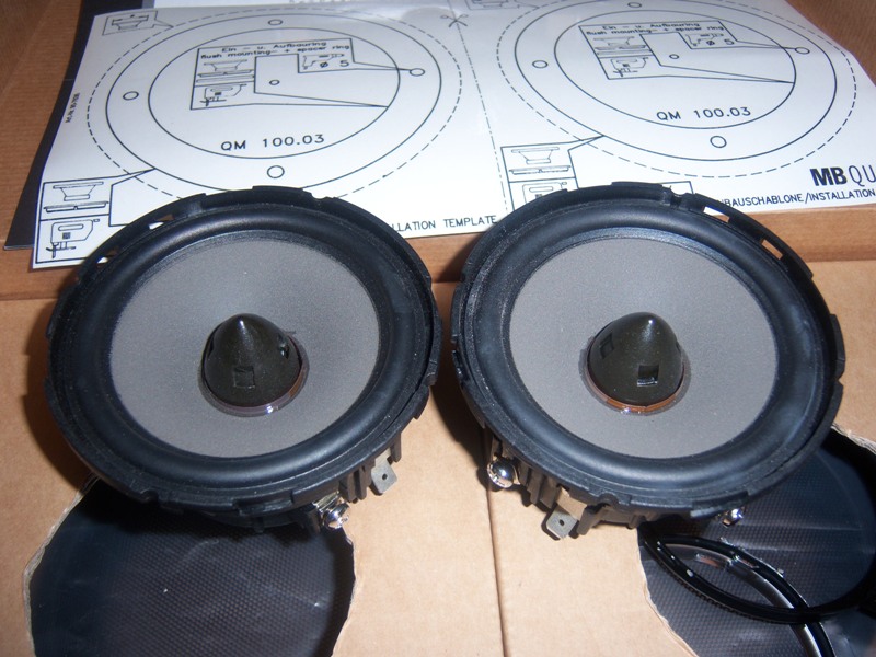

MBQ PWE100 4" Mids
Seas L22RN4X/P 8" Midbass

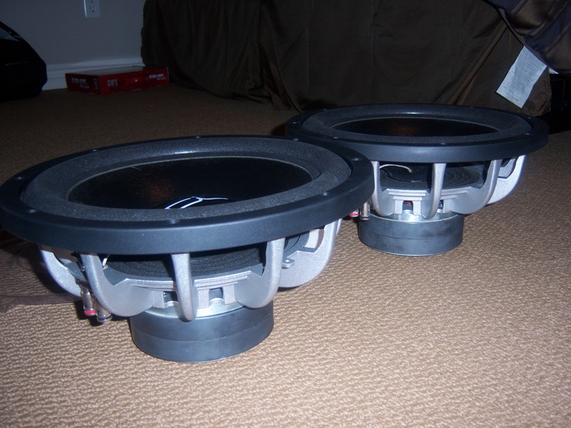

2 Fi X 12" subs
Plus I am making all my own cable's RCA's included.
Right now I am pretty tapped so there isn't much going on for sound deadening yet. Planning on some mlv topped with 1/2 of neoprene pretty much covering everything.
So on to the pics of the equipment:

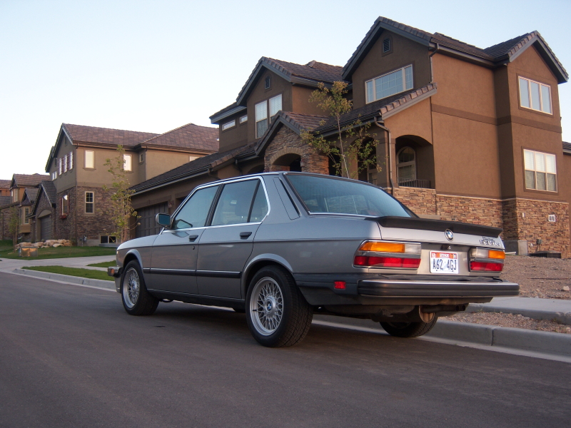

The car
Equipment
Kpg2713 is offline   Reply With Quote

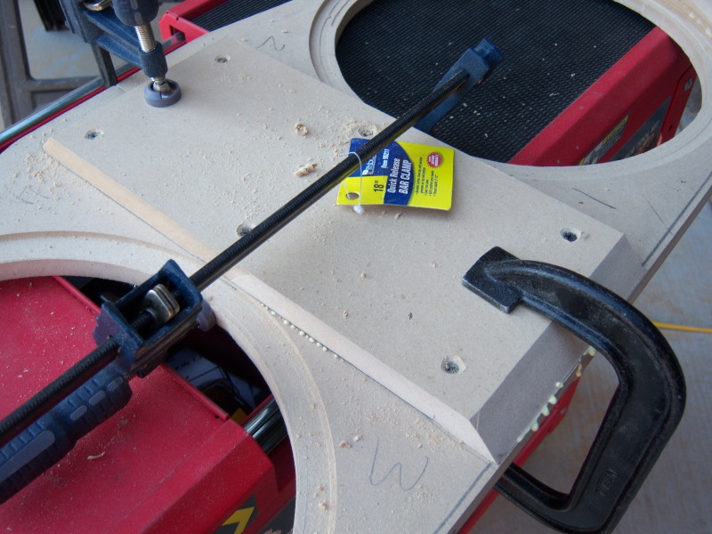

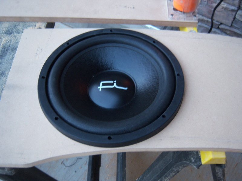

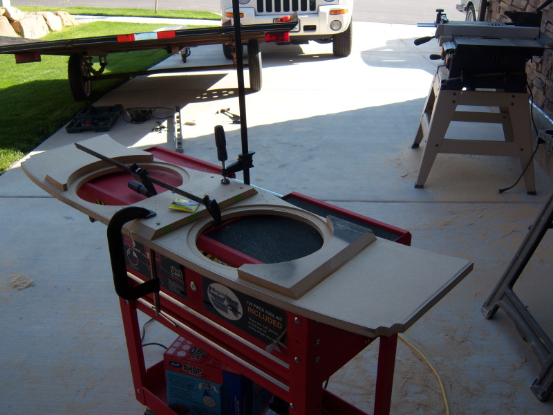

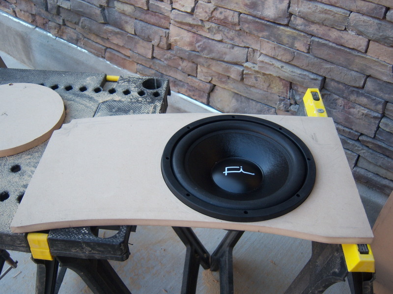

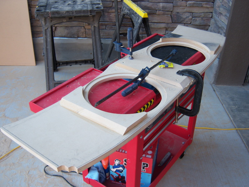

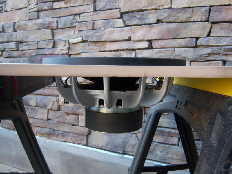

This is what I got done today:

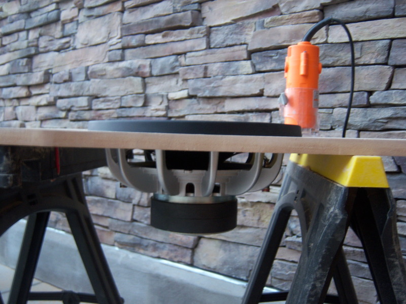

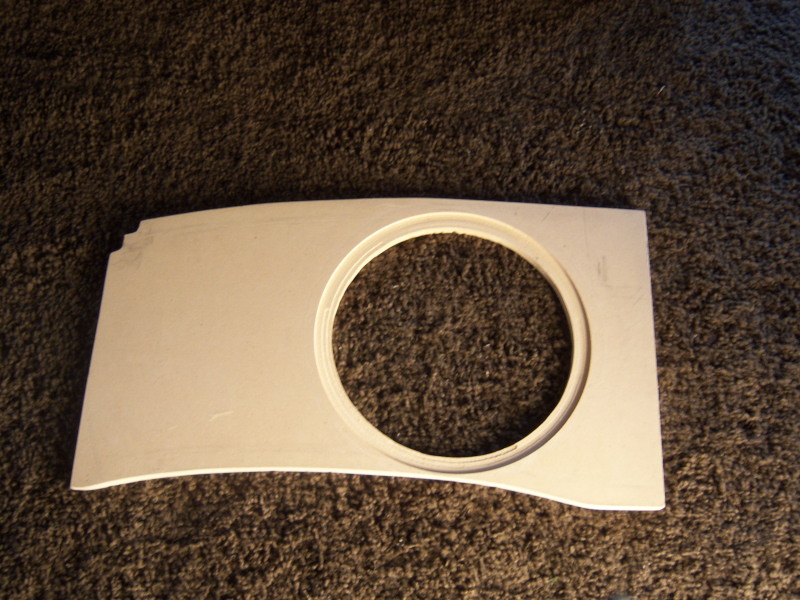

Here is the first side of the rear shelf baffles. I routed them down 1/4" so the sub will sit in a bit. Then I am going to do another 3/4" mdf layer on top so the entire shelf once carpeted will be flat and you do not see the subs underneath. I will probably need to fab up some grills to cover them and maybe find some really thin carpet so it doesn't muffle the subs, but that is later.
Here you can see my $20 router from harbor freight. I had to fab up a little jig but it worked out well. On the first baffle pic you can see the bit came loose, but if you make sure it is tight before every run the thing works a hell of a lot better then I thought it would.
This is the rear shelf as it sits. The baffles will be bolted and sealed here.
I also have to re-include the rear center tail light. I am going to mount that on the first layer of mdf that way it will be a bit counter sunk and maybe look cool.
Anyway, more to follow tomorrow.

Well I asked around here and on SSA forum and really didn't get much. I figure I have them so wtf, might as well try 'em. I am limited on space to nothing bigger than 12's will fit. I personally think they will do alright, especially since I don't listen to much bass heavy music. More metal, and more sane volumes. If they sound tight and clear I will be happy
Thanks btw, I like your car as well. I didn't know you had a pair of Fi X's as well. Let me know what you think if you beat me out.

Well I have barely even gotten past the planning portion of my install, so most everything is either in the mail or hasn't been ordered (for the front stage/car pc), but I have the subs and sub amp of course, you can see the old box they were in in the thread. I haven't gotten past measuring and making sure it will fit yet, so hopefully I'll be able to start cutting everything apart this week or next weekend. You'll probably beat me out.
That said if you dont like it, you can always do a front mount aperiodic membrane over it with almost NO modifications, which should suffice if you really don't listen to loud bass
But with the way these sound in the sealed box, I can safely call these the SUB deal of the century for SQ! (i'm assuming you got them in the clearance too )

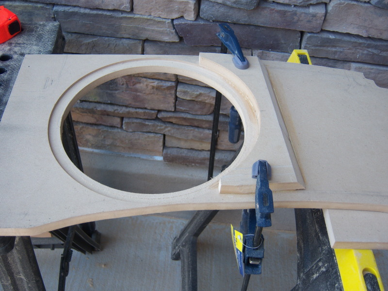

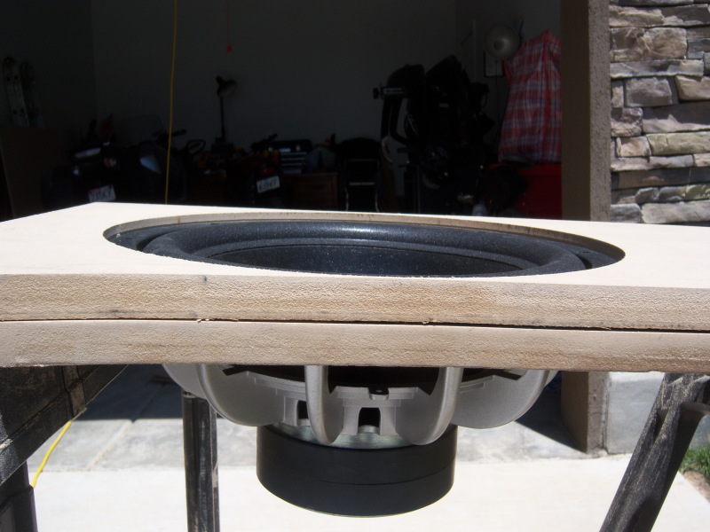

So today I did not have a lot of time. At first I made the second layer for the rear deck.
Turns out the edges did not clear the window and were too thin to route them down to fit. I decided to make a different surround for the subs. I made a mounting area and I am going to make a mesh grill that covers the raised section. I am going to cover that in speaker cloth and carpet the rest.

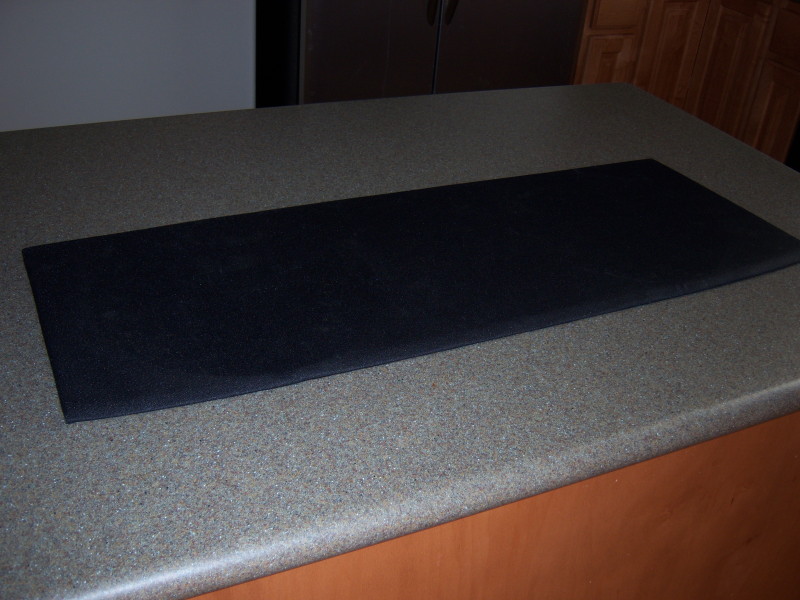

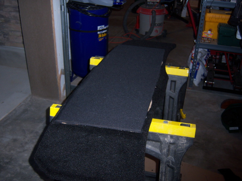

I got some more progress. The rear shelf is cut, covered, and ready to mount. When I get it mounted tonight, I will post up the pics. From there I have to make the amp rack and some cables.

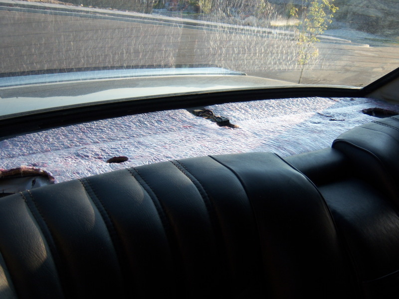

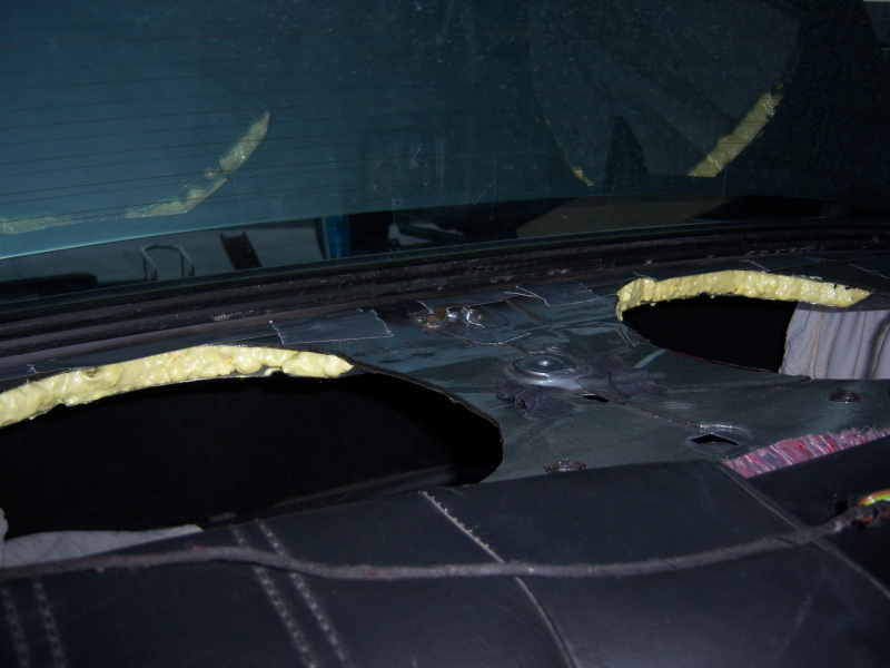

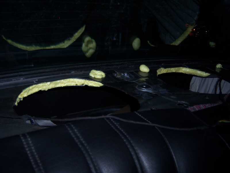

So I have been laid up with the flu... Here is the expandable foam in the rear deck, and the deck finished.
