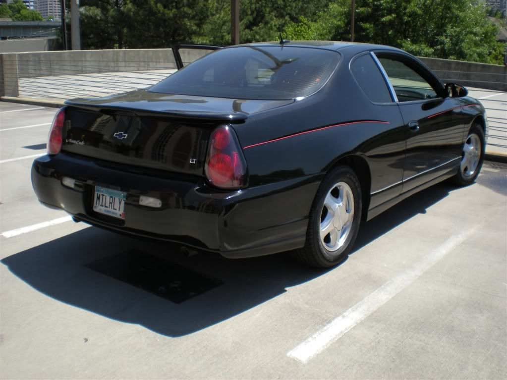

Finally starting a build log for my 05 Monte Carlo LT. A little bit about the car: I decided to go with the red/black/chrome theme, and began adding little accents soon after I got the car.

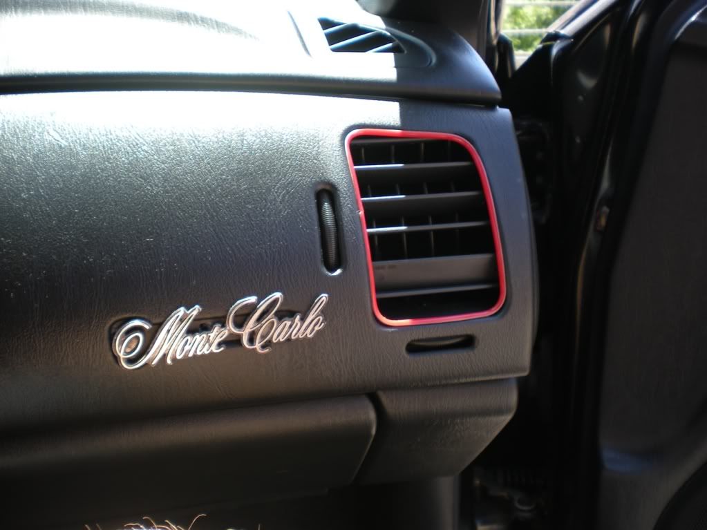

Red stripe:

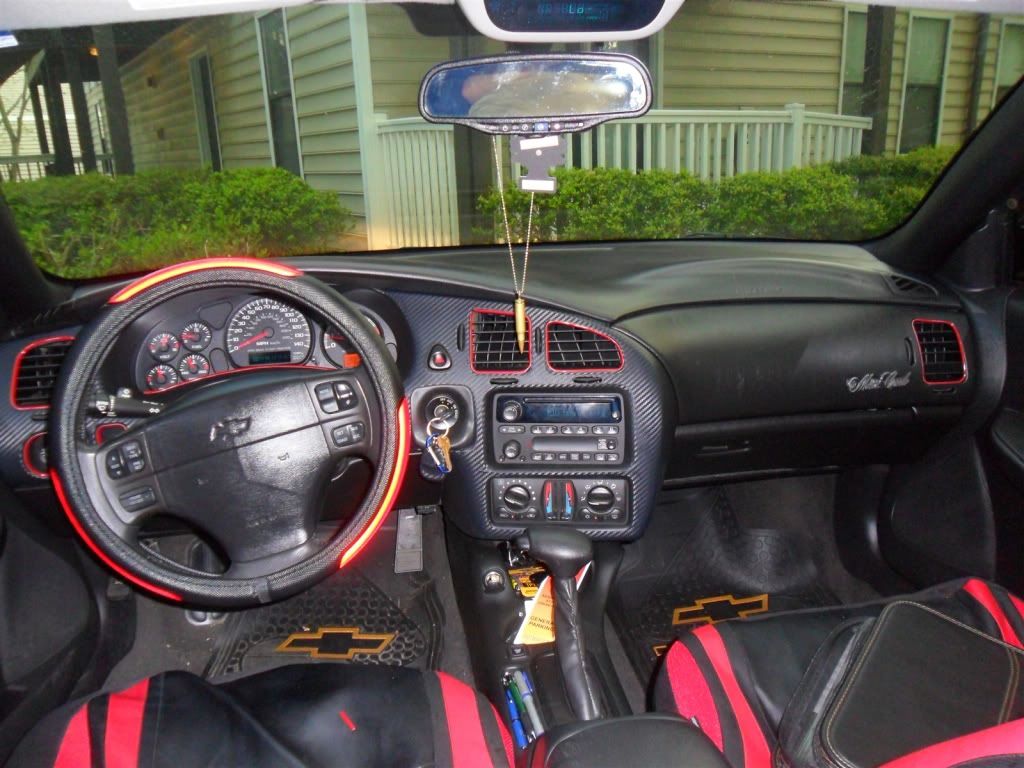

Seat/steering wheel covers:

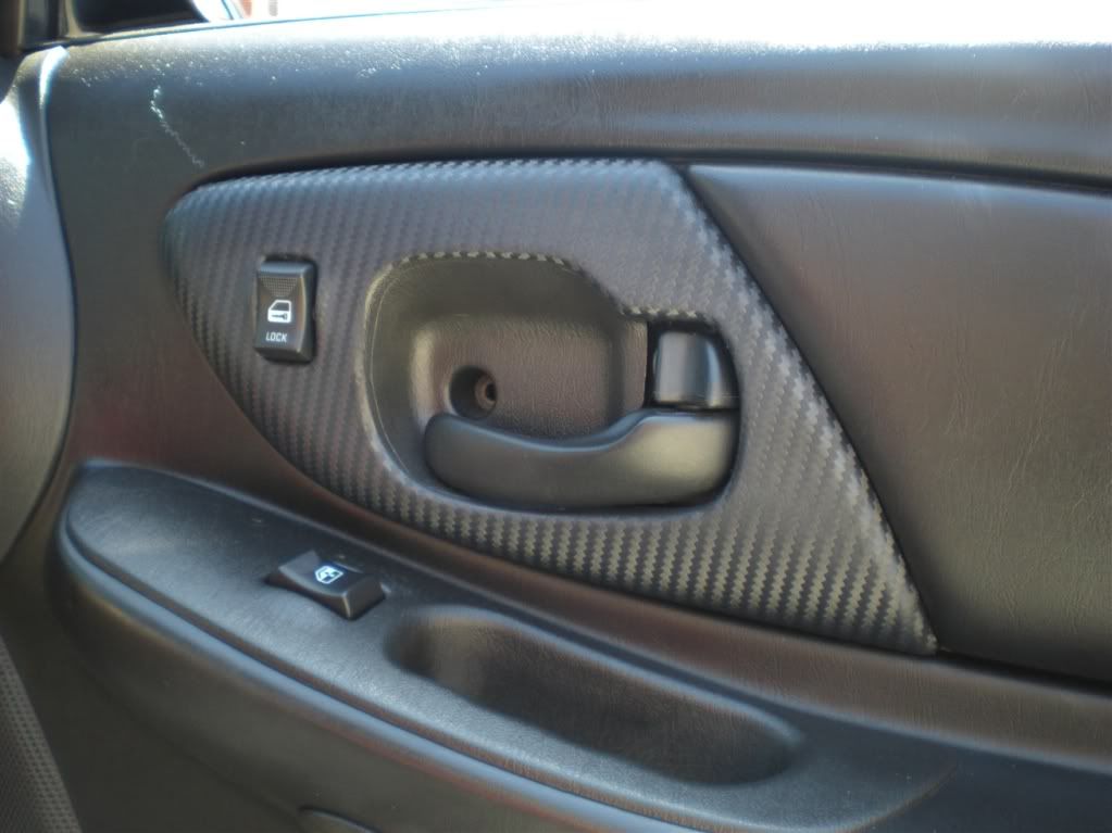

Carbon fiber Di-Noc /vent trim:

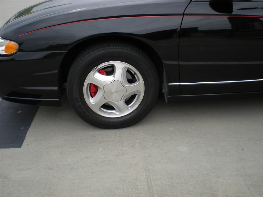

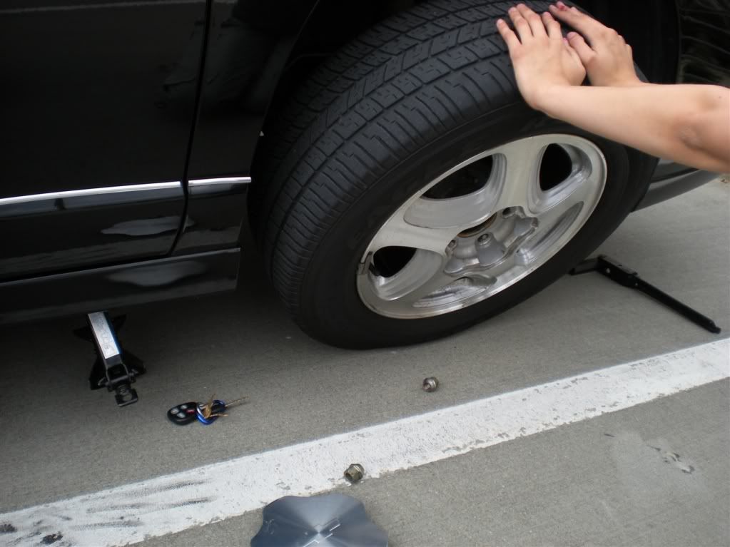

Brake calipers. While working on painting the front two calipers, I did a stupid thing and jacked up both wheels. The tire jacks caved as I was taking off one of the front wheels and the weight of the car was resting on one corner of the jacks and the tire. See here :
But it all turned out alright:
