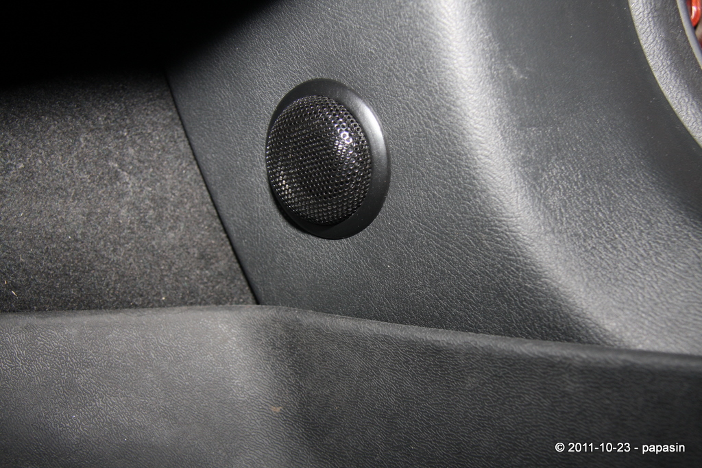

Well, had some time last weekend. The mids will be upgraded with a set of Image Dynamics X65 and the tweeters to a set of Image Dynamics XS28.
First, some comparisons. The mids, from left to right: Stock, Infinity Kappas, Image Dynamics X65
Depth of the X65 mid as you can see is a bit deeper, not to mention won't fit in the stock door location without modifications. The hole needed to be enlarged by cutting into the sheet metal, and a half inch wood baffle was cut to offset the depth. As I've learned from this forum, one of the things good to do is to protect against the elements, so the baffle was coated in truck bedliner. Here's the final result.
Driver's side:
Passenger side:
The door card needed a little trimming, and was treated with vibration dampener to prevent buzzing.
Finally, comparison of the tweeters to go into the stock location. From left to right: Stock, Infinity Kappas, Image Dynamics XS28
Spent time retuning the MS-8. At first, I had a center image that was off to the left. I tried various things, including adjusting the crossover frequency, moving the EQ curve around. I checked the speaker polarity and made sure things were wired correctly. I also played around with the tweeter locations just for the heck of it. Wow, everything sounds amazing with the tweeters off-axis just sitting at the little window. Maybe another upgrade for later? .
Anyway, I restored the tweeters to the stock location, and retuned with the MS-8. After about 5 days now, and a bit of a break-in, I can definitely say there is a significant improvement. Midrange/midbass is much crisper, and the highs are so much more detailed, without being harsh or bright compared with the Kappas. I was also able to get a better center image, but can't say exactly what I did to get there since I tried a variety of things and not sure which step got me to the final result. Overall, I'm quite happy with the outcome. Probably need to fully seal the doors next to get maximum impact with the mids.

Originally Posted by Babs View Post
I meant to ask over at 8thcivic... Did you cut out and flush those much larger ID's into your tweet grills? I'd love to see pics of that for reference if you took any. I ended up using my D26's in the rear deck instead of front because I was afraid I wouldn't have enough grill to frame around the larger diameter tweet but suspect it's superior to the OX I have in there now.
After much debate as to how to permanently mount the tweeters in the stock location, I decided perhaps the stock location isn't the best place. For one, I could not come up with a good way to mount it. With the XS-28 grill cover on, it will sit flush in the stock location, but leaves very little clearance against the windshield (probably less than an inch). It's also impossible to aim it, not to mention I was getting nasty imaging issues as I mentioned previously. Often times, the stage was off to the left even after recalibration with the MS-8.
So that got me to thinking and decided to do a little research where others mount their tweeters in the 8th gen Civic. After looking at the various options (thanks to many others on this forum!), I decided to mount the XS-28s in the kicks. If for anything, if I change my mind later, I can replace both kick panels for less than $10!
With the right tools (a 2" hole saw for the case of the ID XS-28), the entire process took less than an hour.
See below.
Kick pulled out with tweeter mounted:
Driver's side:
Passenger's side:
I went ahead and retuned the MS-8. I was initially worried that the stage would be very low and it would be obvious to the listener that the tweeters were down at the kicks vs. up high in the stock location or the pillars for many others that mount tweets up there. Suffice it to say I was pleasantly shocked! It appears to me that there are tweeters actually in the dash, when there isn't. Stage isn't as high as when the tweets were in the stock location, but the stage is wider, the center is much better, and things aren't as bright as they were (no surprise since I'm not getting the on-axis reflections off the windshield).
Will spend some time listening more carefully and tweaking. My initial thought is that if I'm going to make another change on the front-stage, it will probably be considering getting the Audible Physics XR Duo set, and mounting the XR3M in the little windows on the sides .

now some people may understand why i mount tweeters in this location on some passive setups :P
with your interior though...i think you will still get some rainbowing...

"Rainbowing" ??
Yeah this is making me want to pull my grills and place the tweets in different spots just to see what happens. Looks like I managed to pop one of the OX's (only fain't output), so I'm now thinking tweets again myself in an Si sedan.
I've often looked at the face of the kicks below the hood release (more on-axis), and thought about a flush-mount there. Seen it done only once though strangely.
After a couple weeks listening, I see what you mean. I can reduce it by adjusting my seating position before and after calibration. With this set of speakers though, probably the best tradeoff I could come up with other than possibly putting the tweeters where the small windows are. If I am going to go through with that, might as well go the next step, which is...
Over the next month or two, I have some down time at work and my plan is to install a set of Audible Physics XR3Ms in the small windows in fiberglass enclosures, and changing out the ID X65s with a set of Audible Physics XR6.5Ms. I'm counting the days, stay tuned... .

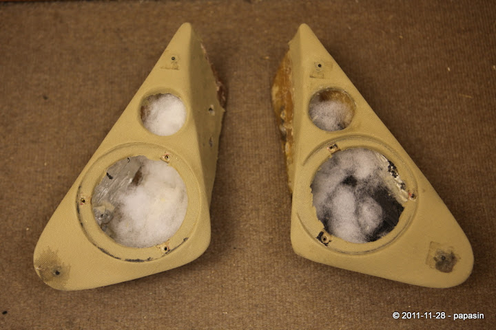

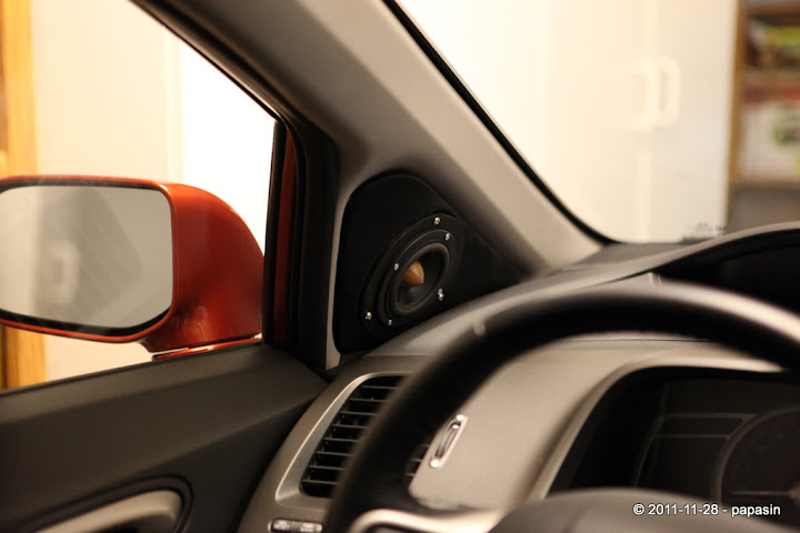

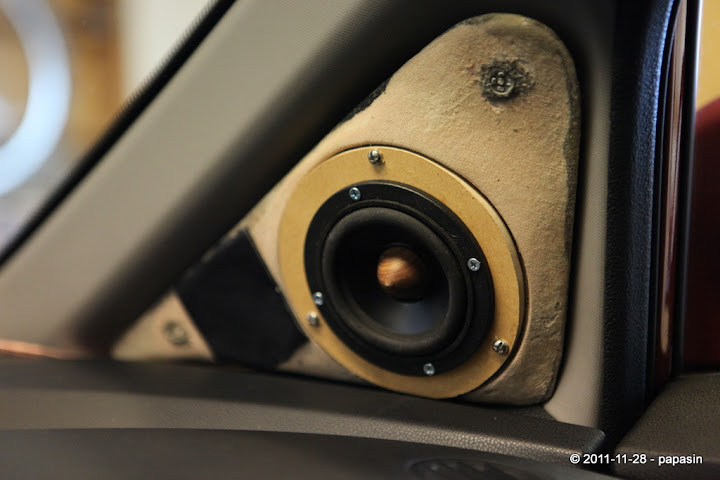

Talking Wideband Audible Physics XR Duo front-stage upgrade
Out went the Image Dynamics X-65 and XS-28s (will be re-used for our other car) and in went a set of Audible Physics XR Duo. A set of XR6.5Ms were placed in the front doors in the stock location.
The XR6.5Ms are band passed to handle 70Hz-280Hz crossed at 24db.
A set of Audible Physics XR3M-LEs went into fiberglass pods that sit within the small windows up front in an 8th gen Civic sedan. The pods were purchased from this forum's own Babs, but as I understand was glassed by bikinpunk. Many thanks to both, definitely putting them to good use!
Here's the build pics of the pods. How I got them:
First order of business, need to cut some baffles for the XR3Ms since these are 3" drivers and the pods look to be designed for 4" mids. So a little measuring and cutting.
and a test fit.
Next step is to take off the tan cloth since I have a Civic SI and my pillars are gray and the dash is black.
Also needed to cover the tweeter hole, so decided to cut a little Damplifier Pro to "patch" it and tested it on the window with the baffle and speaker.
I then painted the entire pod black, and wrapped it in black grill cloth.
Some pics of how it turned out.
Here's a wide-angle shot of the current and hopefully final (knock on wood) front-stage.
I'm still contemplating covers for the XR3M-LEs. A co-worker of mine saw them today and said he likes it the way it is. My install thus far has been focused on stealth, so to be consistent with the theme, I'm debating whether to cut out some rings and wrap them in black grill cloth and use speaker grill pegs, or some other solution. The phase plug definitely is opposite to stealth as it jumps out at you with it being wood, but I have to agree with my co-worker that it does add a little bit of flair.
As for how the XR Duo sounds in my interior, I think they are fantastic with the XR3M-LEs up high. I noted that the XR6.5Ms midbass is superior compared to my previous front stage 6.5 choices, and the XR3M-LEs midrange resolution is...WOW. I don't notice a lack of sparkle at the top end despite not having a tweeter which is my preference. I was first a little worried as it seems to be a concern by a couple folks using MS-8s and AP XR Duos that I've read about in the forum. I think they were using stock locations though, and I think the pods and the aiming of the XR3s make a huge difference. I've only had a chance to do a quick auto tune with the MS-8, and an hour or so of listening. So far I am very pleased!

Why fire the midrange directly into the dash? it would seem like dealing with reflections would be killer
azngotskills is offline   Reply With Quote
Was actually wondering why nobody said anything yet...
There is a bit of angle to them, and they're not directly into the dash...but I went with a solution that was within my skills at this time. That is, the pods weren't something I glassed per the post above and the directionality of the mid openings was already that way...so kind of working with what I got. Perhaps there's an easy solution to change the angle to them given the constraints. I'd be happy to hear suggestions.
Even if they are not directed directly into the dash, the instrument cluster hump WILL mess with your mids creating peaks and dips in the freq response...
Of course I can't tell from the pics how it sounds but I would try to find a way to go over that hump... or away from it (more on-axis with the listener)
Angled rings should work great although you might have to clear the dash since the pods are so close to it already.
Perhaps you guys should ask Erin .
Kelvin
Thanks, I'll have to look into this. Appreciate the constructive feedback.
