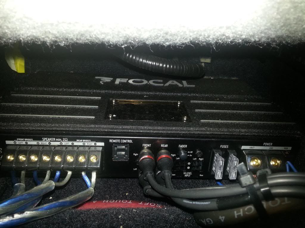

Well the time has come. I am doing some major overhauls on the car in preparation for next year's Meca build (Modified Class), but I still need to stay in my class restrictions for now (Stock Class).
What it's going in:
Most of this stuff is coming out, the sub and HU will stay, as will the Soundstream Reference amp:

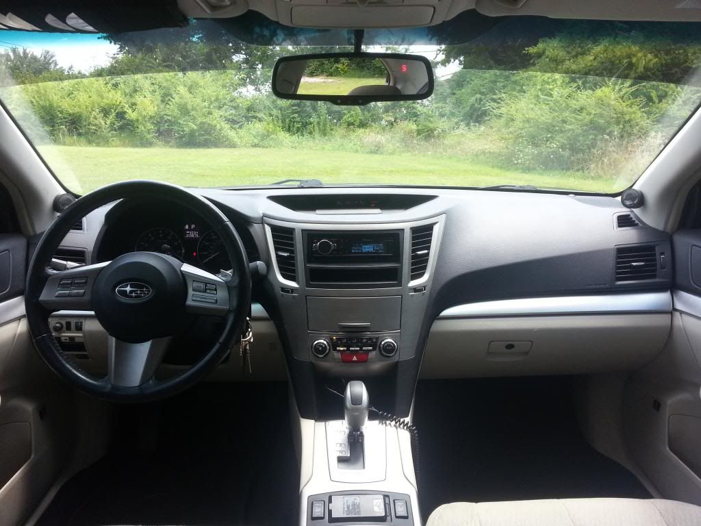

And a pic of the dash where the A-pillar pods will be mounted:
And here is the equipment list of what is going in for now:
Head Unit
- Pioneer 80 PRS
Amps
- Soundstream Reference 370.2 (Tweeters)
- Rockford Fosgate T600-4 - Bridged (Midrange)
- Rockford Fosgate T600-4 - Bridged (MidBass)
- Rockford Fosgate T1000-1BDCP (Sub)
- 100 Farad Hybrid Capacitor (Possibly)
Speakers
- Soundstream TWT.6 (Tweeters)
- Fountek FR88ex (Midrange) (might be getting changed to the Tang Band Bamboo 3", will depend on how the amps sound)
- Peerless HDS GFC 6.5" (Midbass)
- JL Audio 12W6v2

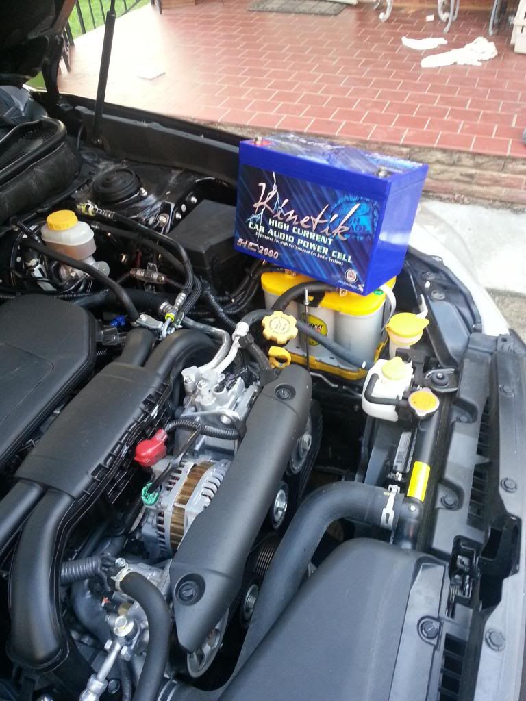

Battery
- Kinetic HC2000
- Toolmaker Metalworks Battery Posts {(4) 1/0 and (2) 4ga)}
Wiring
- 1/0 OFC Front to back
- 2 Gauge OFC front to back
- (2) Toolmaker Metalworks ANL Fuse Holders
- Solid Copper Custom Distribution Plate
- 4 Gauge from distro to Amps
- DB Link Competition Series RCA Cables
- 12ga OFC to speakers
Sound Deadener
Alpha Damp
Fat Mat
Cheap Ebay Sound Deadener

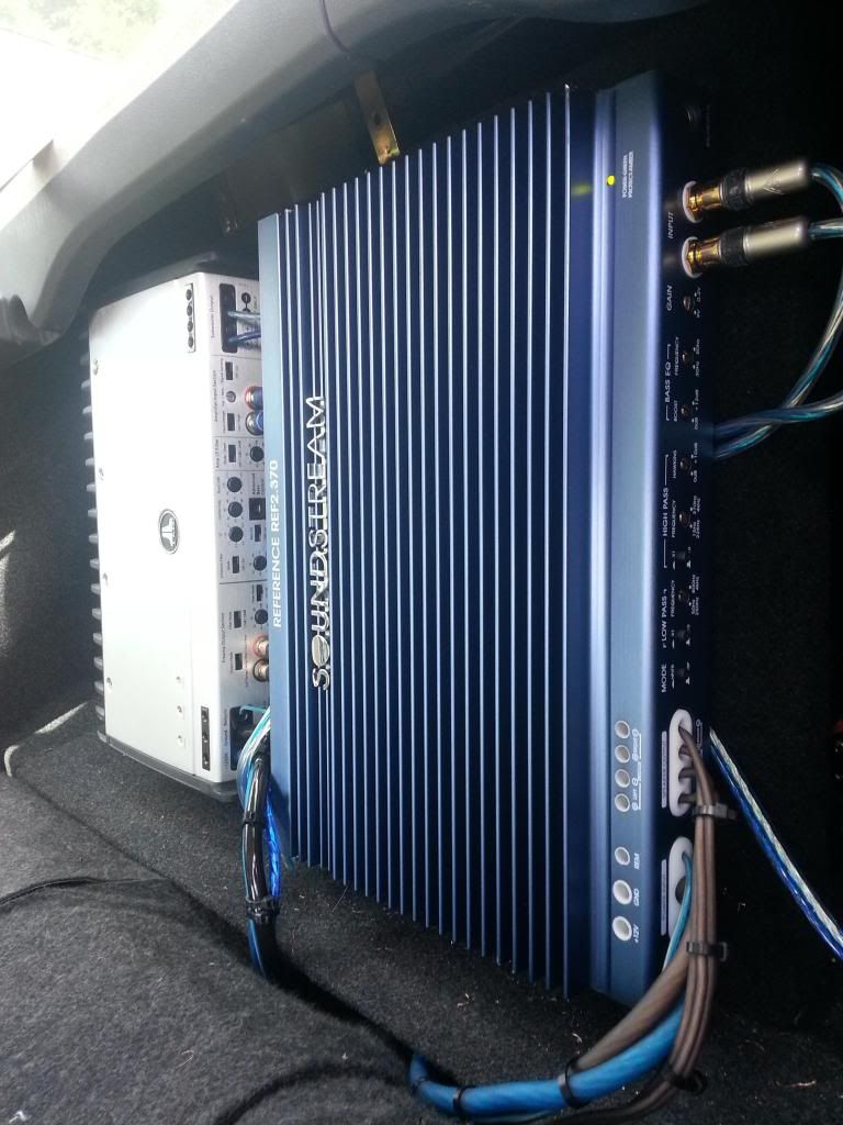

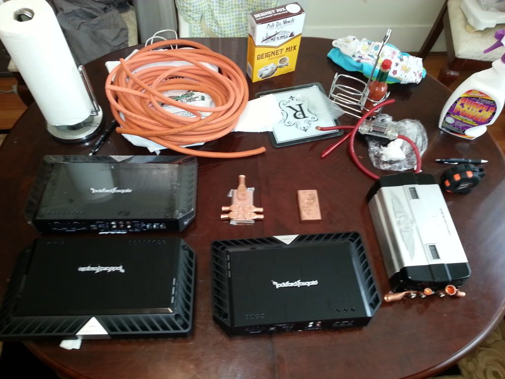

And Pictures of some of it:
Time to get to work, I will keep you guys updated on my progress. Here's to hoping I don't burn down my car!

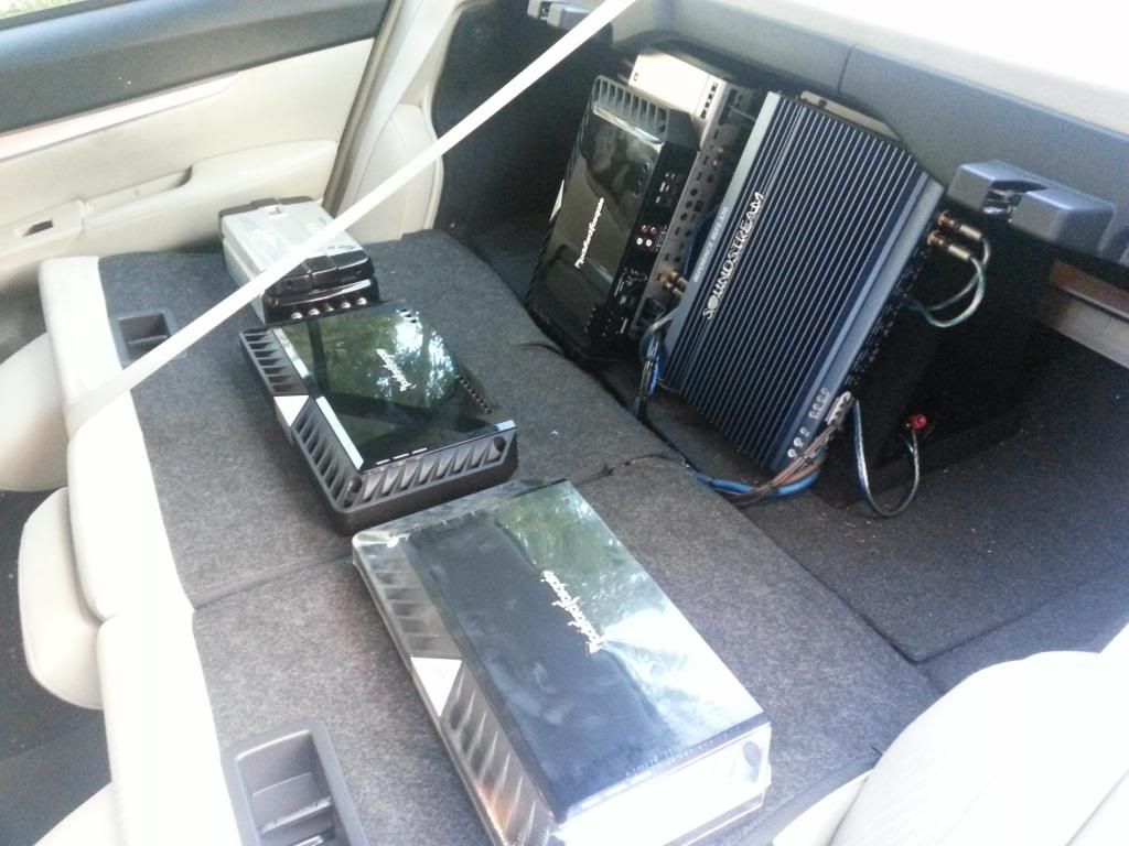

I decided to go with an "amp rack" mounted to the back of my back seats, but there was just plastic sheeting back there. I got some 3/4" MDF and made a new back for the amps to hold on to.
You can see where the my JL 500/1 used to be mounted, and also where it pulled out of the plastic:
Mocking up a template from cardboard:
I know a lot of people have problems with the Parts Express brand bar clamps, saying that they break very easily... They do. However for light jobs, they work out great!
I cut the board at a 30 degree angle to help the fabric on the back lay nicer, so it didn't look so bulged up

Default Re: 2nd SQ Install - First Log - 2011 Subaru Legacy - Modified MECA
Got the first one set in, it doesn't look bad, and holds pretty well. I will have to figure something out about the wires when I re-wire everything, the board is slightly pushing against the false floor where the power wires are ran right now. Here is where it sits, I'll get the other side and some more prep work done tomorrow morning, or tomorrow afternoon if I go to the lake in the morning.
This is what I am thinking, with the SS Ref amp on the other side, then mount the T1000-1 to the back of the box, or against a wall. I don't think it will look as good, but it will be more functional, I guess. Thoughts? Should I mount the 3 similar amps together and make it look good, or keep the stages together for wiring purposes? I have always gone function>form, but I would be interested to see what other people think.

Originally Posted by simplicityinsound View Post
i wanna see the battery swap when you get to it, i am debating on what i should do with mine.
Me too, I'm just waiting on the hardware to come in. I ordered 2 of these http://toolmakermetalworkz.com/viewi...p?productid=20 and a pair of http://toolmakermetalworkz.com/viewi...p?productid=13 also. Should look pretty slick.
