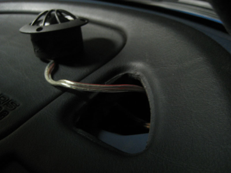

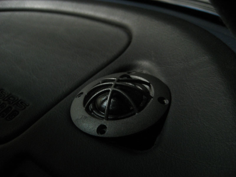

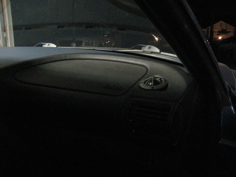

Small update.
Moved the tweeters to the dash and put the iridium midranges behind new stock kickpanels. I'm not sure if they're being useful down there or not, but its nice having the car look stock, I'll experiment more with them later.
Moving the tweeters up high really raised the sound stage and helped with top end extension but now the center image is really wide, that might be a result of the midranges still being in the kickpanels, will have to play more with it later.
These holes use to be vents.

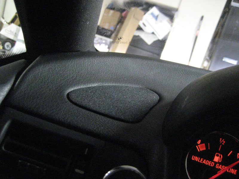

Finished product, dremeled out the original vent (removable part, dash was left stock) and then wrapped it with grill cloth.

subwoofer still needs a grill
Why did you dremel out the inside of the vent? was that necessary?
Yes, it's what the grill cloth is stretched around and also what the tweeters are attached to. Here is a photo of the vent, it is shallow and attached to a bendy rubber tube that was able to just be pushed out of the way. They should be a cheap part to replace if I change my mind, which I very well might
