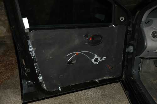

First the front stage and most noticeable the doors.
My Car comes with no Power anything..so to fit the M6+ midbasses I needed to remove the window crank and convert my windows to Power windows....
On that note...there are many (read 4) layers of Dynamat and 1 layer of SS Overkill pro on those doors. 1 on the outside panel. 1 on the inside of the inside panel (follow) and 2 in the outside of the inside panel with the SS over that. That is the black foam you see on that above picture. Once that was done. I covered the whole door in painters tape (no pics) then light spray of
3m #77 adhesive and a layer of aly foil. THen a couple of layers of Fiberglass.

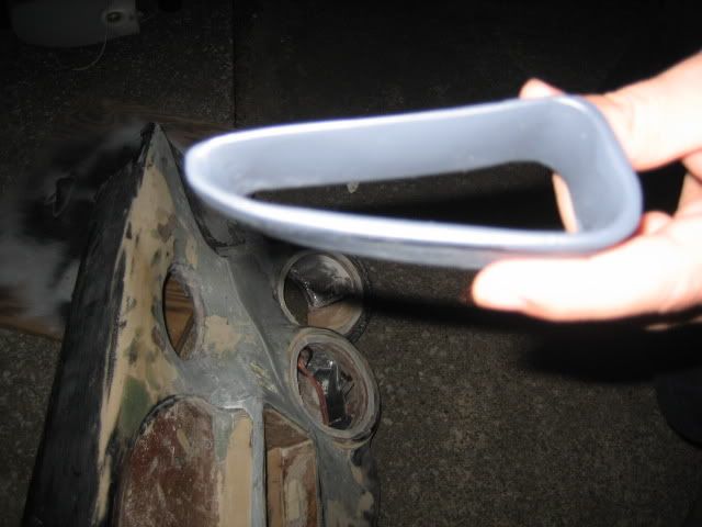

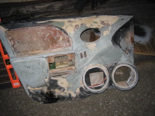

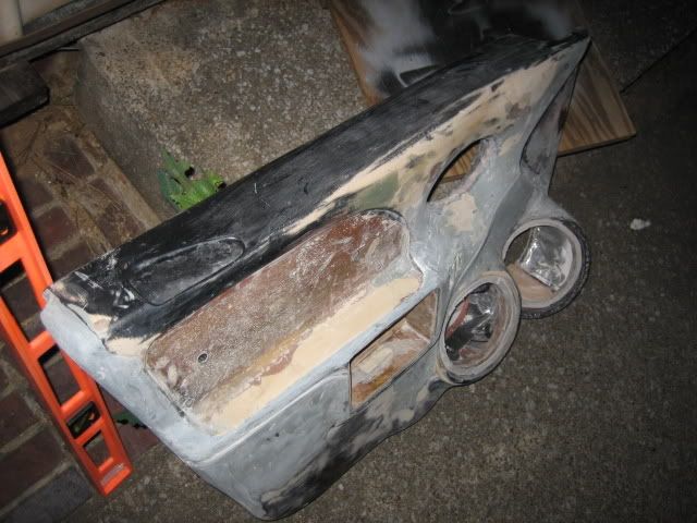

Now that pic shows the fiberglass mold of the door once skeleton framing has been added..or the start of the framing. Once I pried off the mold of the door, duh, framing was added. Lots of it. ALot of time was spend on the Speaker rings and aiming those with rods and hot glue. As you can see before I got too far I added and resined fleece around the front driver just to make sure it was right. The square in the middle was originally for the JBL GTI comps which were going into the door with the CDT's. CDT's for SQ and JBL's for just rocking. Once I realized the CDT's do a fine job of both...I found the M6+ midbass around the same time and wanted to keep it brand coherent and the little M6+ are so badass. So the GTI crossover was scrapped but the sqaure for it was already there. Plus thats also a bolt point for the door panel. (I think I'll be putting a "tube preamp" in there for a pretty light show.) Anywhoo, as you may or may not be able to see from the picture....the whole door panel is the enclosure for the midbass driver. All of the cross braces that braces both the flat top (front part of the door that faces you) and ties the back panel to the front have holes drilled in them to be open as possible. The enclosure goes from the bottom of the door all the way up to the top of the door, albeit only about 2 inches thick at that point. Once all the bracing was done (and there was alot more than shown in the pictures. Plus many flat peices of MDF to make up the flat portion of the doors (armrest area, bottom back section) Fleece was stretched over the entire skeleton to give the relative shape. Lots of FG etc..Then stupid amounts of body filler and such. Which brings me to this point.

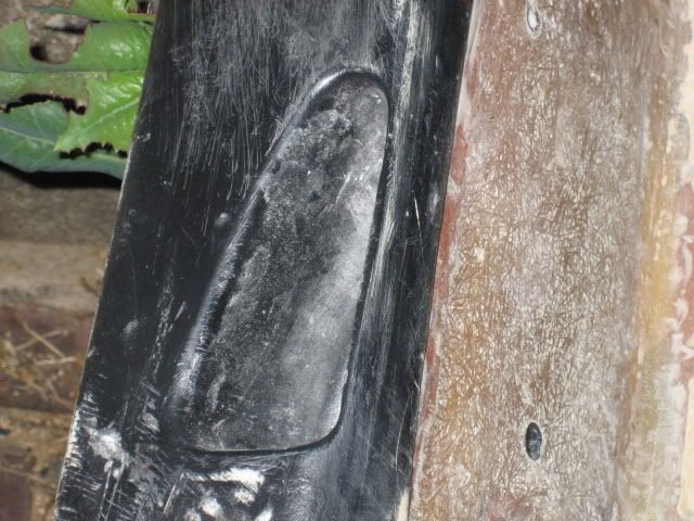

You can see that I used Body filler to make a line that follows the curve right above the driver. This is where the top half of the cabinet which will be leather grained vinyl will be tucked and where the bottom half, paint will start. I needed to make a groove to tuck the vinyl into so it would flow seamlessly to the paint. Hopefully this will work. Fingers crossed.
At the back of the door you can see where the new handle is. I had to make a insert for this since the vinyl will tuck into this pocket, this insert will hold it there and look seamless...this was a bitch to make...
