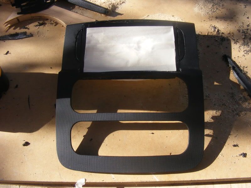

Ok, so i had alota time today to work on stuff, so i got 2 obs done i needed to go for some local guys. This one first, Double din dash conversion in a dodge ram.
Started out with the factory bezel, cut to make a double din kit fit and inserts of the side and glued them in

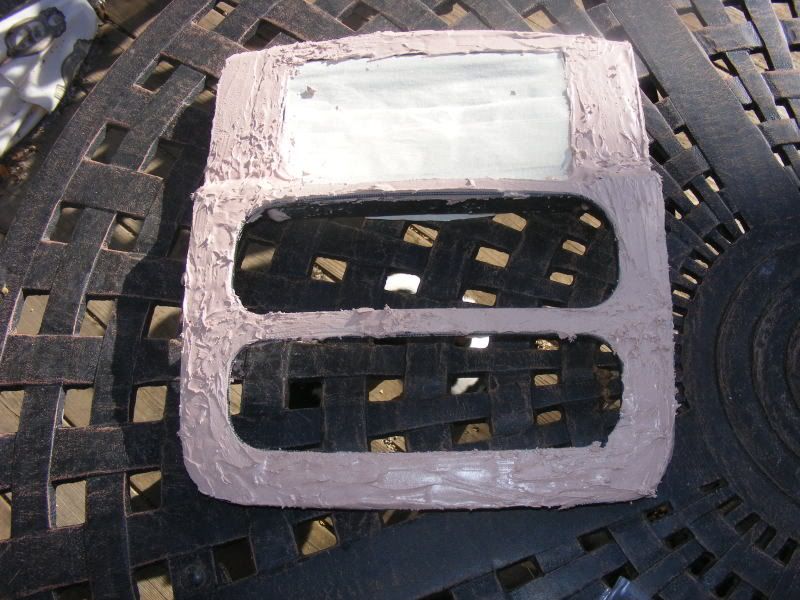

Masked off the lip of the kit and applied some filler, i chose to do the whole panel because it is all being painted a new color.

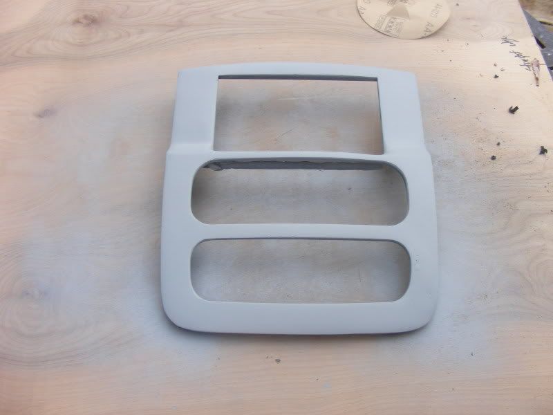

3 hours of sanding later and its ready for paint, i touched up a few spots after this pic
primed

Looks good but I gotta ask, why so much filler? You like sanding?? lol

No I hate sanding, i did it on thanksgiving, just mixed up the rest of the filler i had, added too much hardener. So i just threw it on to just get it on there, sucked but at least i got it done.

I am going to have to do the same thing to my 03 dodge ram, except I am using a single din unit in place.
Hav you ever had body filler crack after applying it?

It shouldn't as long as you don't bend it and contort it.

Ive only had it crack when too much was used, just dont try to build it up too much.
Do you not like the look of the dash kits? If you want to make it easy, use the dodge dash kit and just use body filler to cover the seams.
Unlike i did use thin coats to cut down on your sanding.
And ive seen and used the double din nav panels for the durangos and others and ive heard of them making one for a Ram, however I do not see how as dash cutting is required to get a double din to fit.
