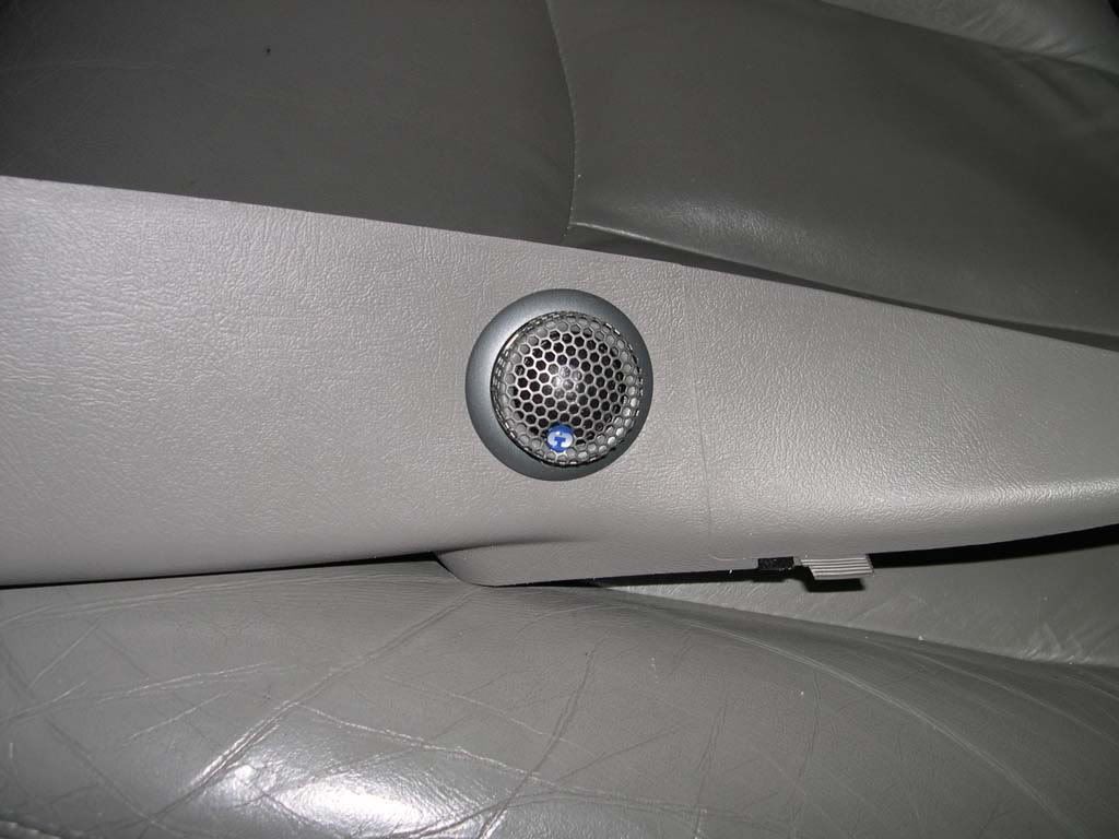

Tweeter in stock location only minor modification needed

Finished Tweeter
