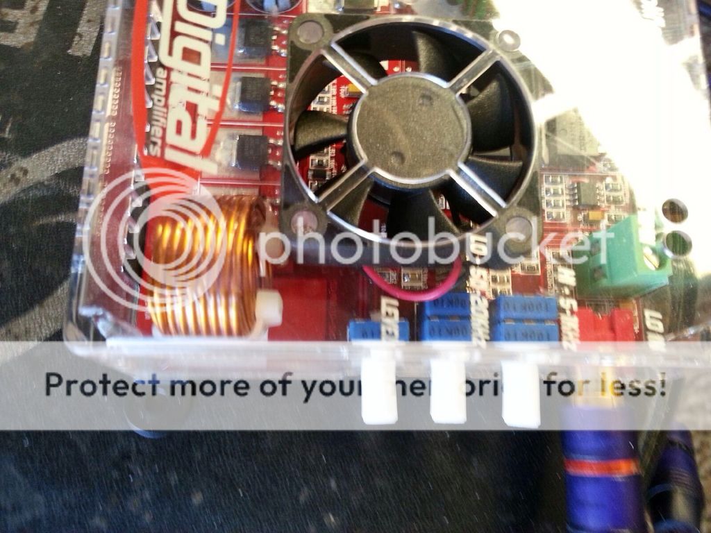

It's really difficult to get an idea of how small this thing really is until you get one in your hands. It's tiny. I love it. No frills. It's just a circuit board in a plexi box. Very cool. I've heard others say the fan is kinda loud. I didn't even hear it so take that for what it's worth.

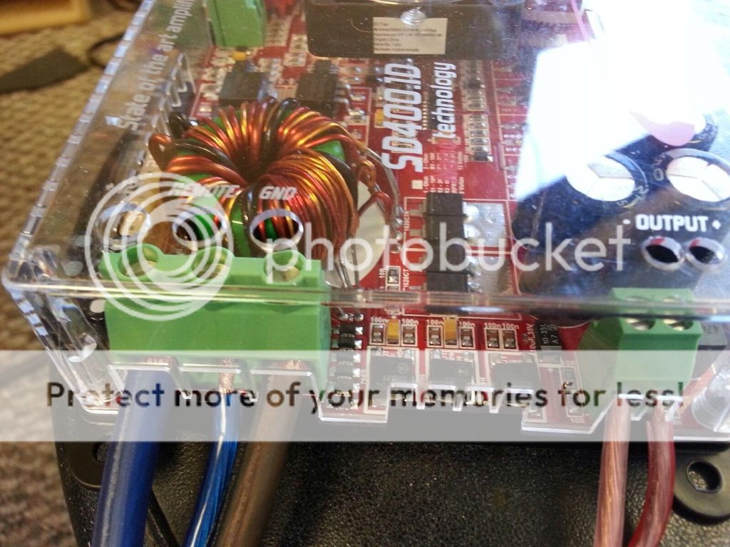

The input side will seem rather anemic if you're used to 4awg inputs and 8awg outputs from other highs amps, but I actually like these little terminals. All you need is a little micro screwdriver that you probably already have to set your gains. Or, if you're like I am and set your gains with your pocketknife, a teeny tiny flathead is cheap. That's AudioTechnix 10awg Speaker Wire for Power and ground. I don't think much bigger would go. And I think those Speaker outs might hold 12awg. Maybe.

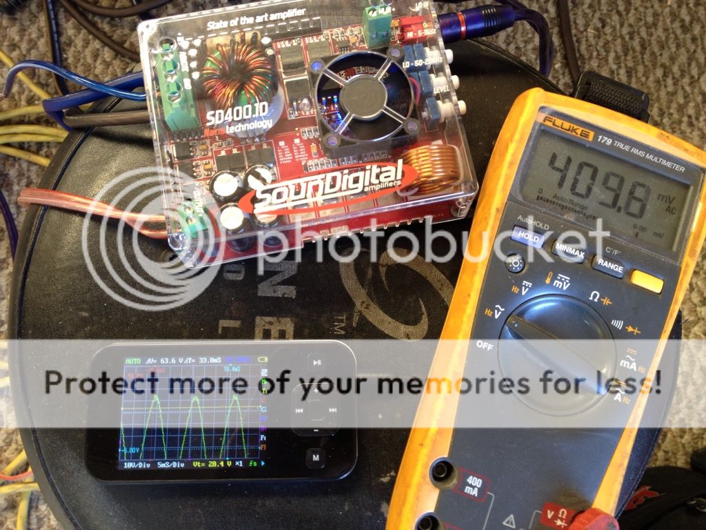

Anyway... I hooked up the scope unloaded. I was curious about what kind of voltage it was going to make, but all I was getting was millivolts. Either the thing needs a load or I'm a retard and one of the DMM leads came out of the itsy bitsy speaker wire. I suppose we should go with retard there. Either way... this was as "clean" as I could get it. I quote "clean" because it's kinda... fuzzy. But it resembled a round wave. Scope says 28.4v, so let's go with that.

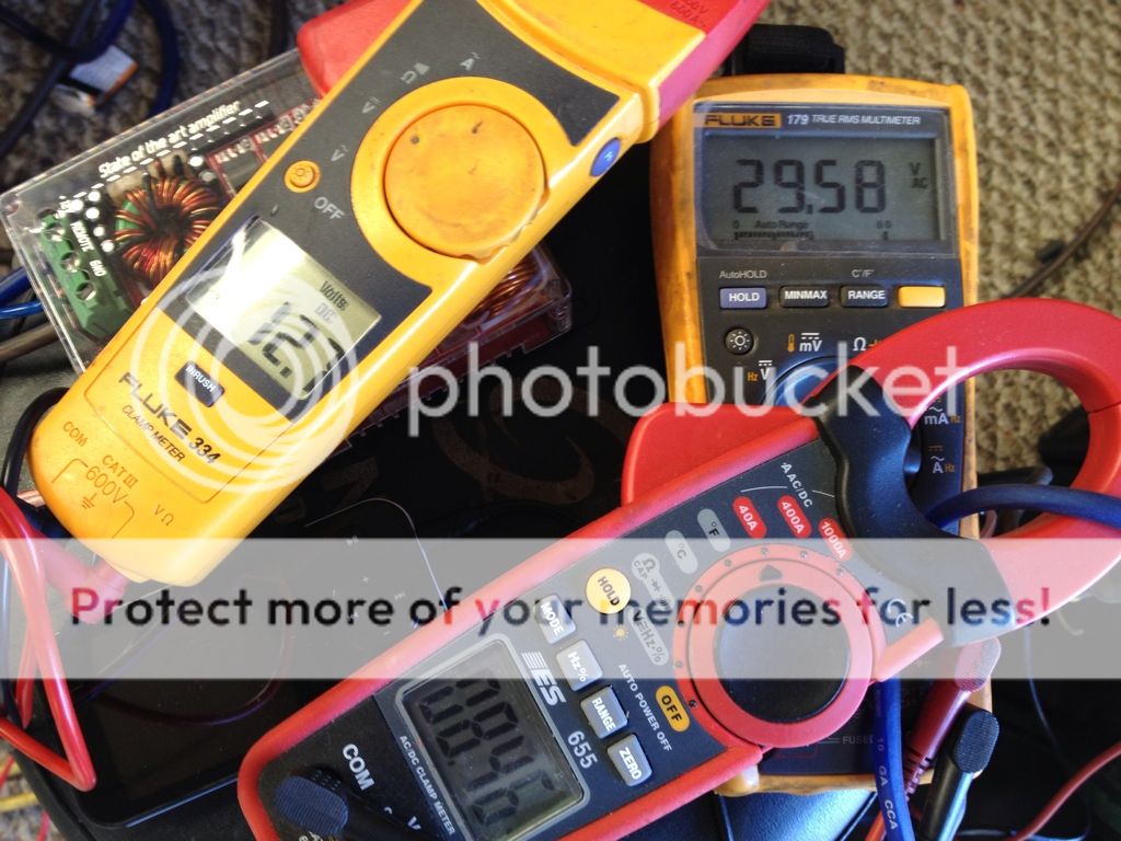

So, using different notes to get different reactive...
5.8 amps & 26 volts = 151w rising to 4.5ohms.
8 amps & 24.5 volts = 251w rising to 3.5ohms.
I drove it into a soft clip and got 6.2 amps & 33 volts = 204w rising to 5.3ohms.
All of these barely got into the battery and were all around 12.7vdc. SD says 400w @ 2ohm @ 12.6v. No doubt that at alternator charging levels or at actual rated impedance, you would get close to 2ohm rated power AFTER rise. That's a good thing.
