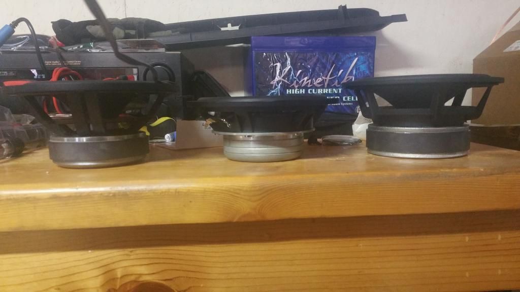

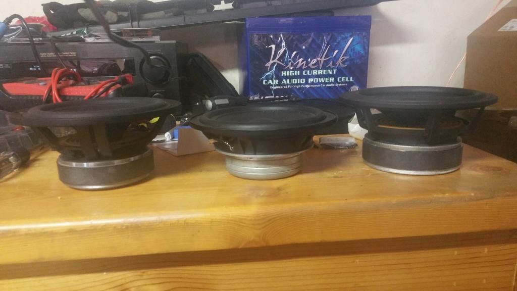

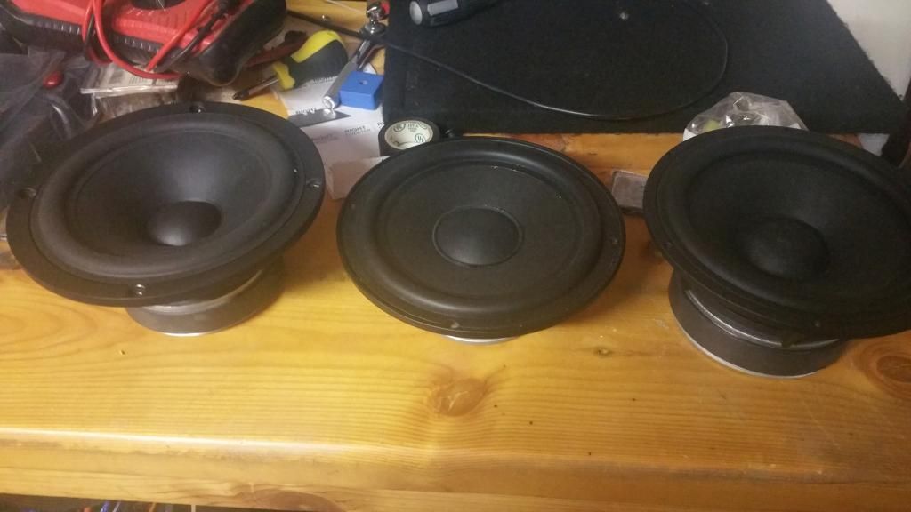

IT IS ALIVE!!! I know a few people here have been following my re-build, and I just want to say that it is in and playing. And now, on to the really cool part!
STEREO INTEGRITY TM65 Midbass/midrange. I was fortunate enough to get THE (one and only) prototype set of these drivers for some evaluation. Now that I got the car playing this past weekend, I got these drivers in, and did some very slight tuning tonight. I must say, these things ROCK. I haven't beat on them TOO hard (They are Nick's only prototype set), and I've only done light tuning on them, but the amount of detail and control that these drivers have at lower frequencies is astounding. They are rated at 9mm Xmax, and still have (IIRC) 85% motor strength at over 5.5mm. This is usually only found in very high end drivers, and one main factor of higher end drivers, is still having almost all of the motor force at higher excursions.
I am still evaluating these, as I am just getting them tuned in, but I must say that I am thoroughly impressed. One thing that was my main concern of these drivers, is I was not sure that I would want these in a 2-way setup. Looking at the initial graphs, they looked like they wouldn't have much output above 1k or so. Having a 3 way front and a full processor, I knew that I would be using them solely as a midbass, and this wasn't a deciding factor for me. I have not got to do any RTA measurements with them in car yet, however I muted my midrange, and lowered my tweeter crossover from 7k down to 2k and brought up the TM65's crossover likewise. Much to my surprise, they had absolutely no problem playing up that high. I decided to do some quick listening tests, and playing around with different crossover points, I learned that they would (with no EQ boosting) play up with the tweeter crossing over at 3k with no problem. With the tweeter at 3.5k, it was pushing it, and with the tweeters crossed over at 4k, there was some slight information starting to get lost. I was also using LR crossovers, where the driver is at -6db at the crossover point, instead of the -3db on BW filters, so this could have played a factor as well, but seeing how they would play up to 3k easily, I decided not to test it with BW filters, as most any reputable tweeter can play down to 3 or 3.5k.
I was very hesitant to recommend these in a 2 way front stage setup, however, after listening and testing, I would have no problem whatsoever using these in a 2 way front stage. I will get out the RTA and see exactly what is going on in vehicle soon, however the preliminary listening tests are going very well. So far the only downside I have found, (and is a slight one) is that with large female spade connectors and insulators, they stick out a good bit and make the driver difficult to fit width-wise, as they are slightly larger than the baffle cutout. This won't be an issue for me, as I will solder on my speaker wires, and wont have oversized spade connectors on there. I would even be willing to bet, with the proper size connectors, it probably still won't be an issue, as the only ones I had on hand were the large yellow ones. I can't wait to get my finished production set in and really hammer on these things. But so far, I may have a new favorite 6.5" driver. Ability to play up to 3k cleanly in car, 9mm Xmax in a XBL^2 motor, AND only 2.3" deep. I will post up when I learn more after more testing and more listening.
The set of drivers in the photo is from left to right: SB17NRX - TM65 - Silver Flute 6.5.

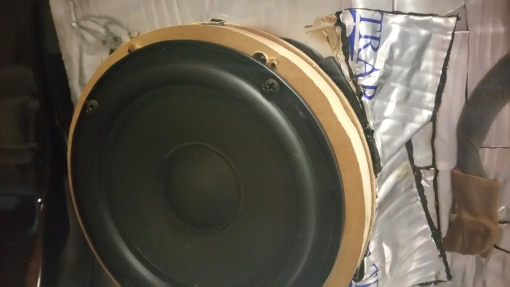

Ok, first to answer peoples response's.
BayBoy, I have some actual in vehicle response measurements, at the drivers headrest, as off axis as they will likely be, unless you have them playing towards the firewall or something crazy.
Babs - Compared to the SB, I believe the SB has slightly less distortion in the midrange. However, with that being said, the SI definitely has not only more low end output, but more control in the lower frequencies. It should be noted also that these are prototype drivers, one I know being built completely by hand, and not broken in, so that can play a large factor into the midrange clarity for sure, and I will re-test when I have my production drivers in hand, that I have already ordered.
On to the first part of the Objective part of the review, as I promised. Not much to talk about here, as it's hard data in the form of RTA readings. However, HOLY COW. I talked to Nick and he told me to open these things up, and man, what a surprise! As you can see from the graph below, these things have NO problem getting down in car. I actually had to bring the crossover of the TM65's UP, as they had TOO MUCH low end authority (Definitely not a problem, as this was a nice surprise). I had my sub at 50@36, and the TM65's at 60@12. I brought them up to 70@12, and I was still EQ'ing the 40, 50, and 63 eq bands DOWN. I don't know what Nick recommends, but I feel these things have the output to be ran without a sub. Obviously I didn't go playing Royals at full volume with the allpass filter on, as these aren't mine, but man, what a nice surprise!
As far as the midrange dips and peaks go:
PLEASE NOTE!!! The following reading were taken in MY car, with MY install, with MY stock mounting locations (Will provide a pic later if I don't have one on file). The 800hz midrange dip can easily be a product of my car, and the graphs is more to show the upper and lower end limits, again, in my vehicle. YOUR RESULTS WILL VARY vehicle and install depending.
This is where my factory mounting locations are, at the very front bottom of my doors. Again, this is probably about as far off axis as you would find in most cars. Still, you can see from the graph above, that they easily play up past 2k, and a tweeter crossover of 3k would play nicely like this, as shown in my subjective listening tests.
Now, off to bed. Some more tuning and listening done. Let me know what you guys think.
