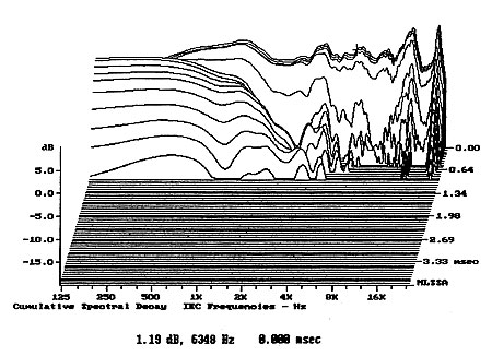

When a loudspeaker has a resonance, that resonance can be "EQ'd out", but there will still be two problems which remain.
The first problem is that the cone is ringing due to the resonance. This is no different than hitting a wine class with a fork; the ringing will remain for quite some time, even after EQ. (The EQ electronically changes the signal, but it can't PHYSICALLY alter the driver.)
In the pic above, we see this ringing in the high frequency response of the tweeter. See those two ridges in the top octave?
This is why a lot of tweeters sound awful to people with good high sensitive hearing.
If your high frequency hearing isn't so hot, you might not notice. A lot of this varies from person to person.
The second problem with loudspeaker resonances is the resonance at the Fb of the driver. That resonance delays the signal in time, and it can make the music sound out-of-sync or slow. If you've ever put a subwoofer into a box that's too small, and the sound is 'sluggish', then you know what I'm talking about.
But this isn't just a subwoofer problem; it affects the entire frequency range.
Some people obsess over drivers with very light diaphragms, but it's actually not the weight of the cone that causes these issues. It's a combination of the cone weight, the power of the loudspeaker motor, the weight of the surround, etc... IE, you can use a heavy cone and still have a driver that *doesn't* sound sluggish as long as you offset that weight with motor strength.
Also, one of the reasons that a lot of people like ribbons may be due to the fact that they're virtually resonance free, because the ratio of motor strength to diaphragm weight is off-the-charts with a ribbon or planar.

I always thought the Focal Ti-Oxide tweeters sounded pretty good, and it's one of the very few pairs of 'conventional' tweeters that I've held on to.
But the waterfall graph that I posted earlier was from a Wilson Audio speaker that used it, and it didn't look too hot.
Not sure if the dome was damaged, or if there's something else going on there.
Zalytron in New Jersey and speaker City in Burbank CA still stock them btw.
