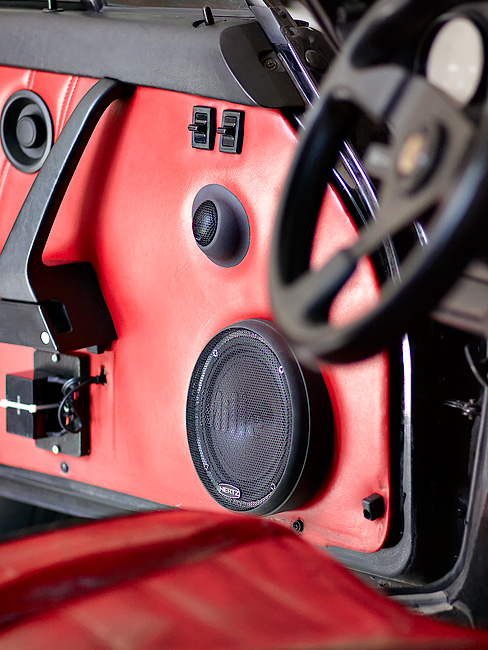

My understanding from all of this (and from prior experience in home and car audio) is that:
1. Avoidance of sharp edges through mounting the driver into a larger diametre sphere will assist in avoiding edge defraction. The pic below of keep_hope_alive's effort is the best execution of this principle in this whole thread - no edges because the driver is flush and the sphere gradually 'rounds away' from the driver edge.
Most people here in this thread mounting their drivers into spheres are still left with some form of small radius edge around the driver flange which, although edge defraction is minimised to a degree, it's still present as shown by the red lines in the second pic/diagram below. Regrettably, because of the size of my 3" mid, I'll be forced to end up with a similar result (I still need to be able to see out of my windscreen after all!) as I can go as big as a 5" diametre ball.
2. Mounting that driver/sphere as far away from glass, pillars, door trims, etc as realistically possible will also assist in avoiding disruptive and more immediate boundary defraction/reflections.
3. Because of physics (sphere size vs frequencies dealt with) the benefit is realised more with tweeters. Some here are mounting mids into spheres and being told that this, to a degree, will have a negligible effect, again because the spheres are too small for the lower frequencies coming from that driver.
My point and question comes about because my front stage will consist of a two way set up using wide band Audible Physics XR3M 3" cone drivers (point source ftw!) on the A-pillars and 5.25" Seas S16RNSL midbasses in the doors. I will have no tweeters as such!
The AP's will be highpassed from about 250Hz (yet to be finalised at this stage) and run all the way up to 20Khz. They'll be mounted within 15 degrees of axis to preserve their top end response. For internal volume and lower octave production they'll need to vent into the A-pillar, which in turn will vent down through the top of the dash. So far, it's looking like a 5" diametre sphere is the go for this driver.
The Seas' will be flush mounted with the door skin in the doors.
Again, it's been said that mids in spheres is a wasted effort to a degree, but what about those wide band mids that'll be producing all treble up to 20Khz?
Thanks for your help, and a massive credit to those who've contributed here in this thread.

Running midranges in spheres is pointless simply because the wavelengths are so long. For instance, if you have a 3" midrange in a sphere and it's lowpassed at 1350hz, then the shortest wavelength that it's reproducing is 10" long. So the 3" sphere will do a little to reduce diffraction, but not a whole lot. (This ignores output above the xover point; admittedly you should factor that in.)
On the other hand, if you do it with a tweeter, the shortest wavelength reproduced is 0.675" long! So you get some serious bang for the buck with a tweeter sphere. Almost anything you do to eliminate diffraction near the tweeter will make a difference, because it doesn't take much.
Also, you mentioned that you're listening to your full ranges on-axis to maximize the top end. Keep in mind this isn't necessary if you have EQ. It's perfectly valid to cross fire them and tip-up the top end to compensate for the rolloff that occurs due to their directivity.
In fact, I'd argue that contributes to a wider soundstage.
It doesn't really impact your power handling because excursion isn't a problem at high frequency, and there isn't a ton of energy in the top two octaves unless you're in the habit of listening to dog whistles.
The graph above shows the response of a Peerless 3" on and off-axis. You'll note that it's basically flat on-axis, but output drops quickly off axis above 10khz. You can listen to these off axis, by tipping up the top octave. Only catch is that the off-axis response needs to be well-behaved, but this driver fits the bill.
Play around with it in the car, because a lot of the magic depends on the implementation.

Thanks for the reply.
As I said on my post, I already understand that a 5" to 6" sphere will be of no benefit to mid frequencies.
My question was about whether a sphere of this size would benefit the higher frequencies normally the domain of dedicated tweeters, that a wide band mid is able to produce in my case.
My thinking is that it would benefit however, I'm just seeking confirmation from the experienced and knowledgable here.

Yes, a spherical enclosure reduces diffraction for a full range driver, as long as the driver is capable of playing to a frequency where the wavelengths are small enough.
IE, no real benefit in doing it if you have them low passed at 1350hz, but if you have them running full range, or even lowpassed at 2700 or 5400hz, you're going to hear a difference.
I guess I'd break up the candidates into three brackets:
Bracket one - great candidates for spherical enclosures are drivers with wide directivity that play to a very high frequency. Tweeters are an example of this. The smaller the better.
Bracket two - good candidates for spherical enclosures are drivers with wide directivity that play to a moderately high frequency, or drivers with narrow directivity that play to a very high frequency. Examples of this are 2" and 3" woofers.
Bracket three - poor candidates for spherical enclosures are drivers with wide directivity that play to a low frequency, or drivers with narrow directivity that play to a moderately high frequency. Examples of this are 5" and 6" woofers, or 3" and 4" woofers that are lowpassed below their upper limits. There are plenty of 3" and 4" woofers that can hit 10khz, so if you're using one without a lowpass, it's a good candidate, if you ARE using a lowpass, it's suitability for a sphere will be reduced as the crossover point gets lower and lower.
