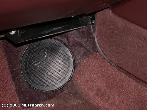

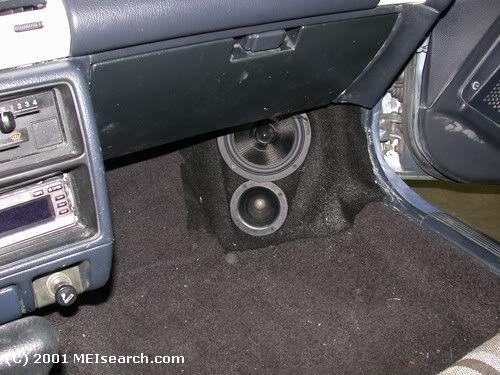

With enough questions around about how to mount horns etc...
If you have horns installed, please post pics.
If you want to post a couple pics of the install process, thats cool too
I'll Start
Version 2 of my Integra Install from around 2001
Most Recent version of BMW Install-MECA Finals Champion
BMW Install -IASCA Finals Champion 2005 (debut of the car)
Winslow's (hatedguy) install from 2001 IASCA Finals
My wife Lori's Install from her 1st IASCA Finals in 2001 (4th place)
Horn is a mini Tractrix horn, one off design, loaded with ID NX30 Tweets
