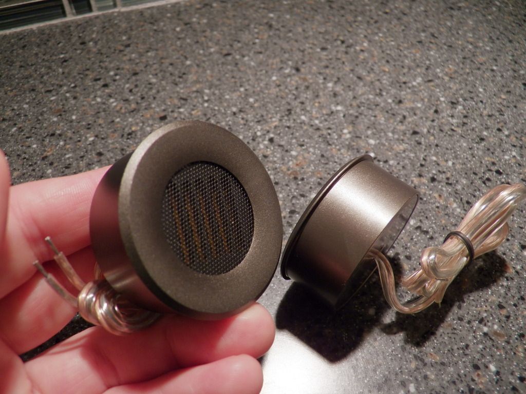

The housing is extruded aluminum with a nice textured finish on the front bezel. Dark silver almost grey in color (anodized). The back plate is glued in place, I wanted to pop them open to see inside but I don't see any real reason so I will leave them be.

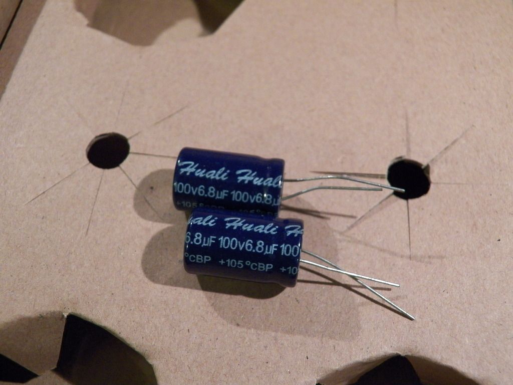

A set of caps came with the set.
