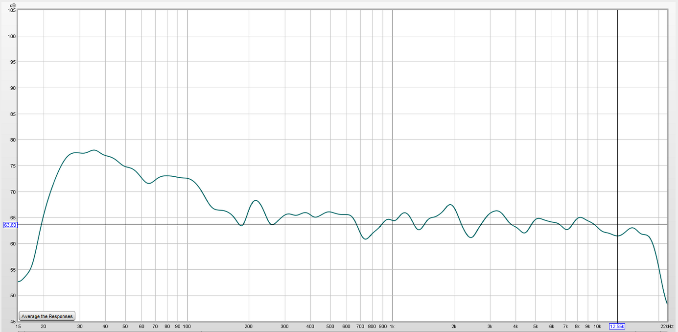

Originally Posted by naiku View Post
So, I tried a tune like this with simply L/R with the subwoofer mixed in, on this tune I am not using bass management. The results are good, on previous tunes I always found the sub-bass lacking, but this way it is not lacking at all and (to my ears at least) is blending really nicely with the mid-bass and is now right up on the dash. If you have time and a spare preset it's well worth a try of just L/R.
My other favorite tune I am running has the subwoofer separate, but on this particular tune the subwoofer level is a touch too low for my preference. With almost all of my previous tunes I found the subwoofer level lower than I would like. I need to do some more back to back comparisons between the two to determine which I really prefer though.
Originally Posted by ErinH View Post
I had better luck combining the sub in to channels left and right and running DL in 2 channel mode; not 3 channel. But, YMMV.
I will definitely try it... and would not mind at all if it turned out better, because it is pretty good right now.
This is from my drivers seat... dead center of my head... 1/6th smoothing. All of my DL measurements were right around were my head is... with the first being dead center of head.
