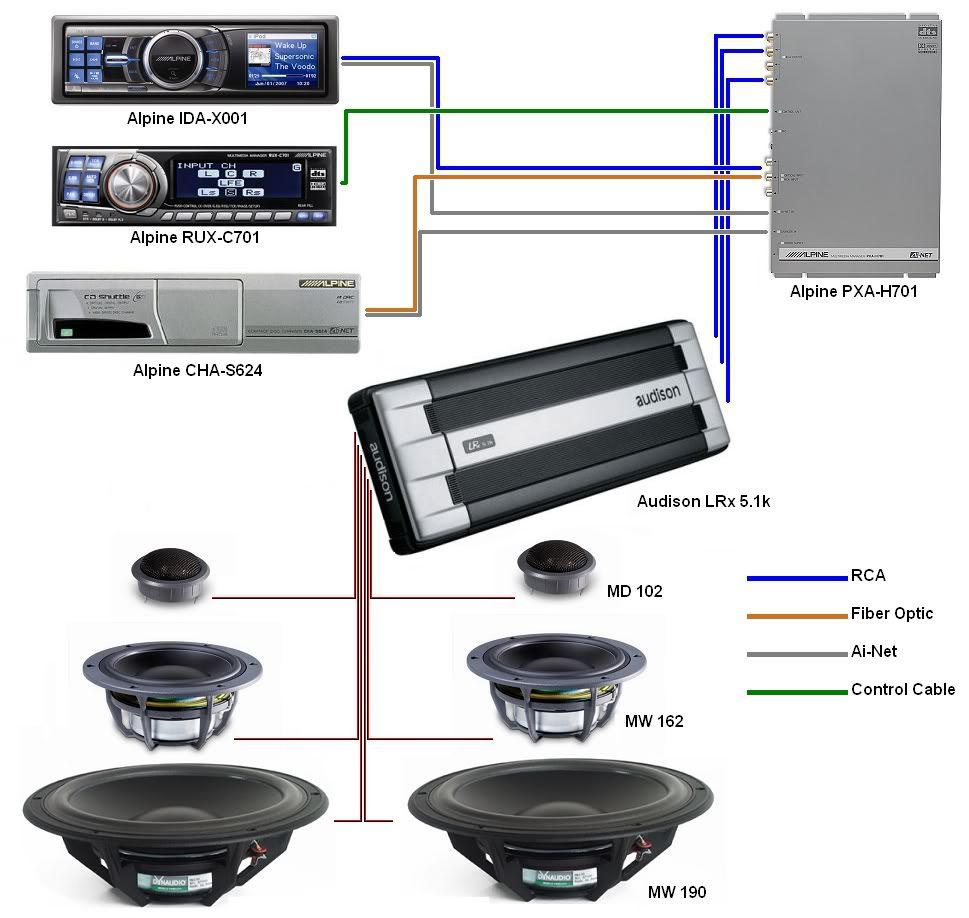

I feel sick. I've never dropped this much money on car audio at one time in my life, and I feel a little lightheaded. For those that haven't seen, here's the system diagram:
Install will technically start next week when I pay the local shop to run techflexed 16 gauge wire through the pain in the ass molex connectors in the door. For me, it's worth it to have them knock that out for me.
I'm going to take over my friend's garage over the Thanksgiving holiday and deaden the floor pan, roof, trunk, and rear deck with 160 square feet of Raammat BXT and ensolite. While the car is apart, I'm going to run and anchor all the wires and install the x001. Later, I'll tackle the doors individually, but I'll have to do the baffles for the mids, so I want to make sure i can take my time.
Then I have to get the tweeters mounted in the a-pillars. My pillars are already covered in cloth, so i'm going to cut the plastic away from the pillar around where the tweeter goes, then mount the tweeter with straps so it just pushes on the cloth when the pillar is secured. I'll have to test and make sure the cloth is acoustically transparant...if not, i'll have to buy some, but no biggie there.
After that, it's the custom baffles in the rear deck to mount the MW190's. I have 3/8" thick fatigue mat that I'm going to use as a thick gasket to help fill all the irregularities. I'll go back over the edges with silicone as well. The baffles will be a hybrid of 13 ply birch, mdf, and 1/2" oak plywood. I figure the more conflicting resonances, the better. After baffles are set up, I'm going to carpet them, as well as the rear deck, so everything looks clean.
The amp, 701, and distro blocks will be anchored in the floor of the trunk where the rear seats fold down. I'm going to anchor a panel between the struts, secure the gear down, then build a simple cover to go over it. Heavy duty mesh will go over the opening to provide air flow.

Congrats! Great equipment, cant wait to see the install. Couple of questions though.
Didnt you have a different HU? If so, why did you go X001? Just curious since I am still trying to decide if thats the way I want to go.
Second, could you (please) do a DIY on how you did your system diagram? I checked out the program you said you used in the other thread of yours and still didnt get it, so a simple step by step would be great! I'm sure others would love it too!!

Nice audio system diagram. I LOVE it!!! Can't wait to see it installed in your ride. Good luck
Head Unit: Alpine IVA-W505 Processor: PXA-H701 Drivers: Phass NT25 Tweets, DM52 Mids, MD1076 Mid-bass, SW1025 Subwoofer Amplifiers: DLS Ultimate A2, A4, JL Audio HD750/1

1. Open up MSPaint
2. Go to Image > Attributes
3. Make it any size you want (the larger the better)
4. Copy and paste the pictures you have and move as you like
5. Save as png.

what program did you use to make that diagram? any chance I can get you to do one for me?

You can do that in Paint.

For everyone asking about the program, that's all paint. I used the 2nd thickest line for the connections, then used the thinnest line with white to make the RCA's look like they're going under the other wires.
On the images, crutchfield can get you new pics, google images can get you others, and my Dyn pictures actually came from Dynaudio. I emailed them and they sent them.

I actually prefer to use Word, then take a screen capture and save that as a .jpg.
