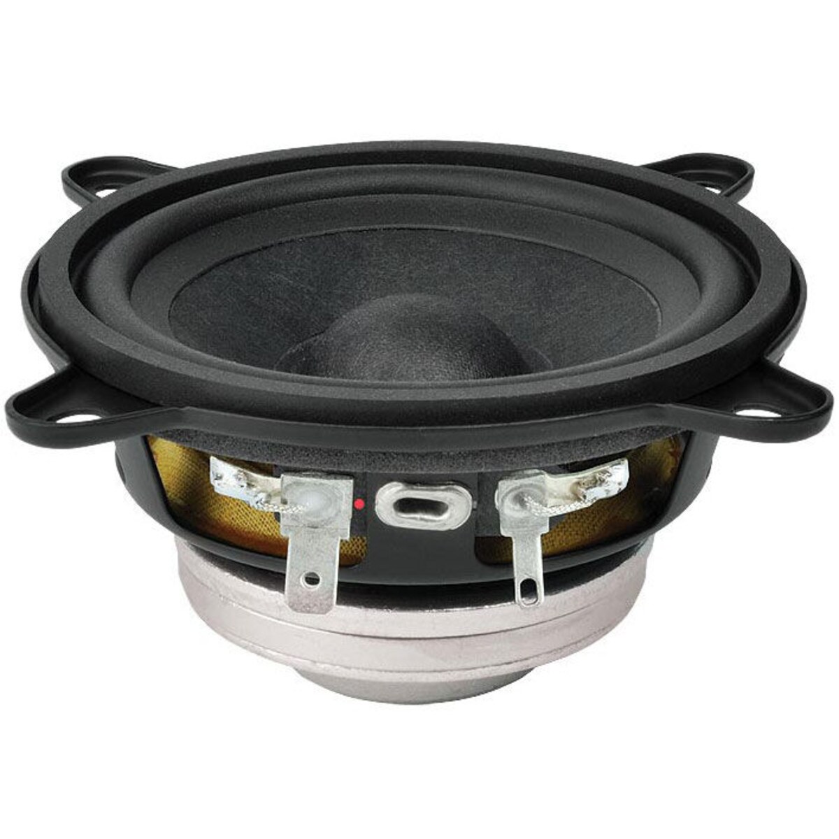

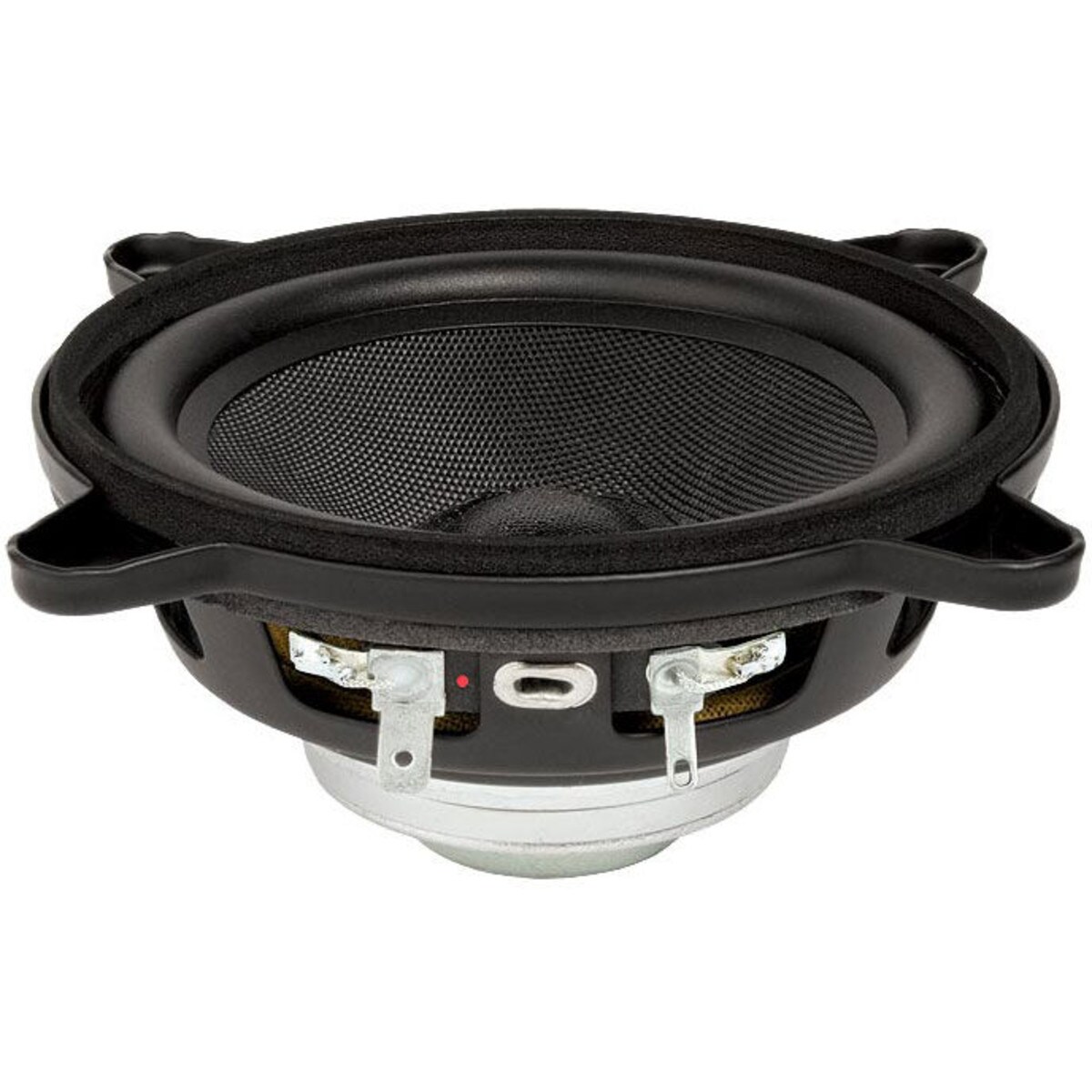

link to either the 3 or 4 inch faitalPRO fullrange. Might want to try 300 - 500 Hz HPF depending on how hard you push them.

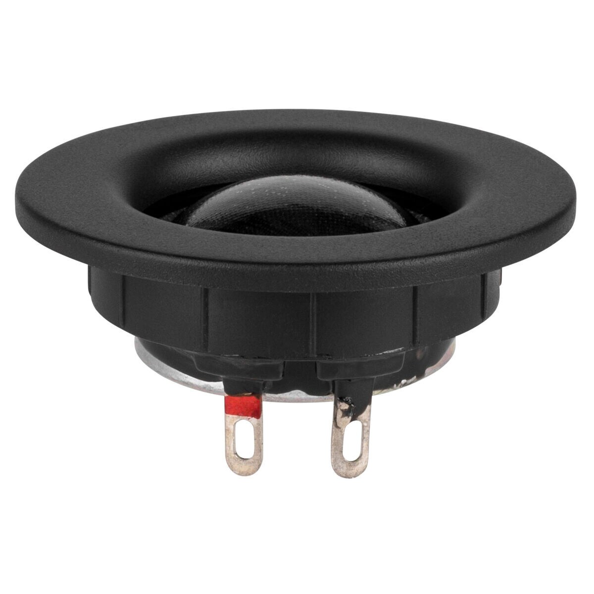

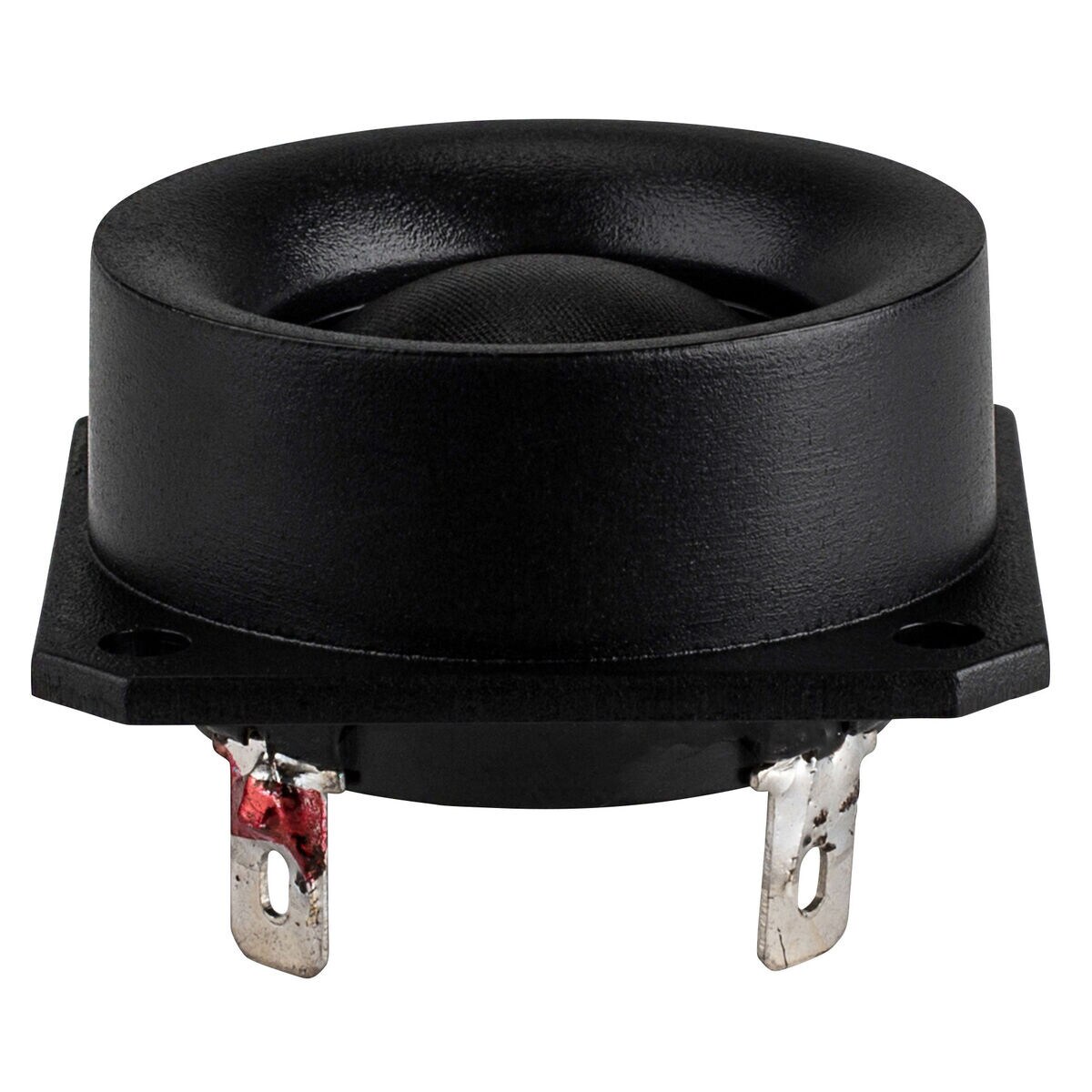

couple tweeter ideas, smaller format that might work well on the pillars or sail panels. If you have a ton of space then you could look at large format. These are 1inch or larger so they wont fall behind in output.
If you're going to stick with the 3 way idea and need a tweeter for the very top end check out the dayton nd20, cheap and they have a few install options. Just cross them high (4000 or 5000 Hz). They're playing such a small portion of the range up there they will only see a couple watts.
depending on your mounting option.
