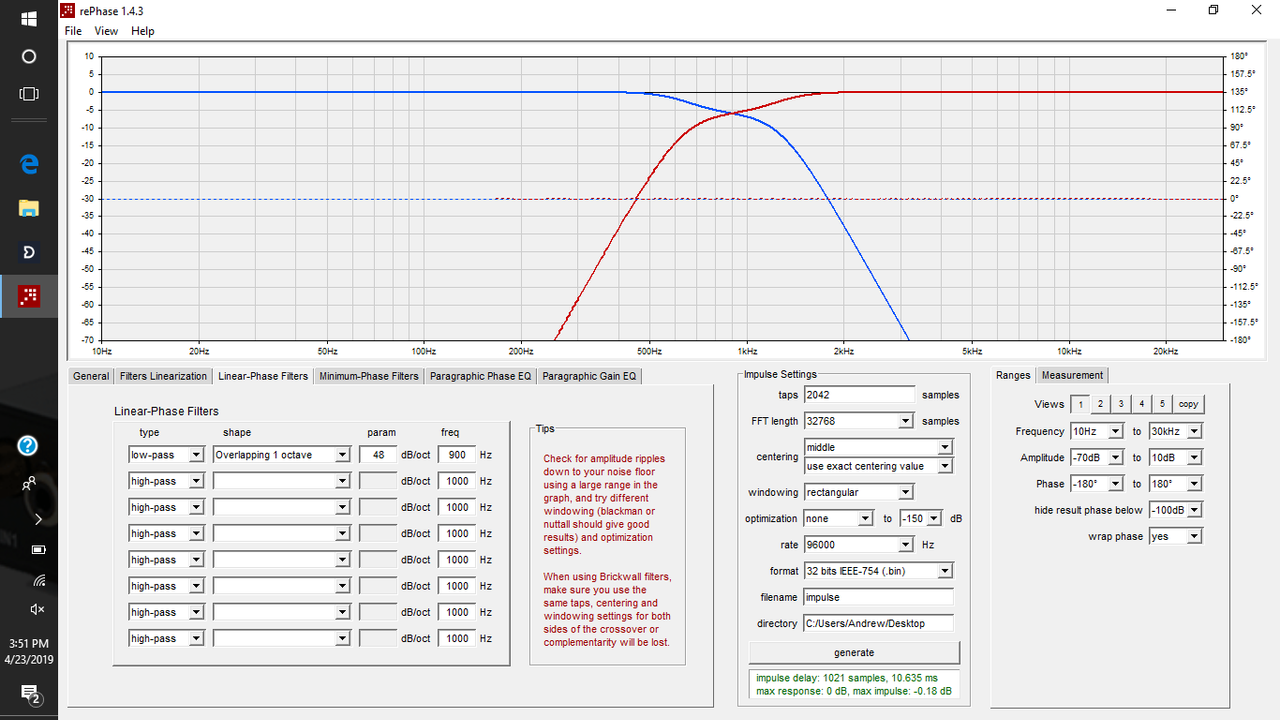

Okay here's the overlapping filter, the red shows the high pass and blue shows low pass

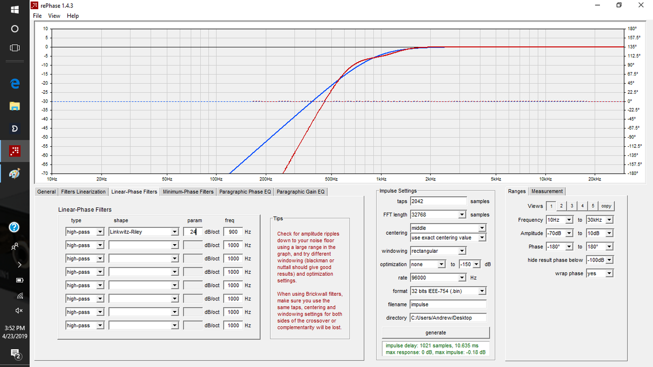

And the high pass with a standard LR4 at the same frequency, You can see the overlapping filter dosent add much, its super tiny but makes a big diffrence in SQ

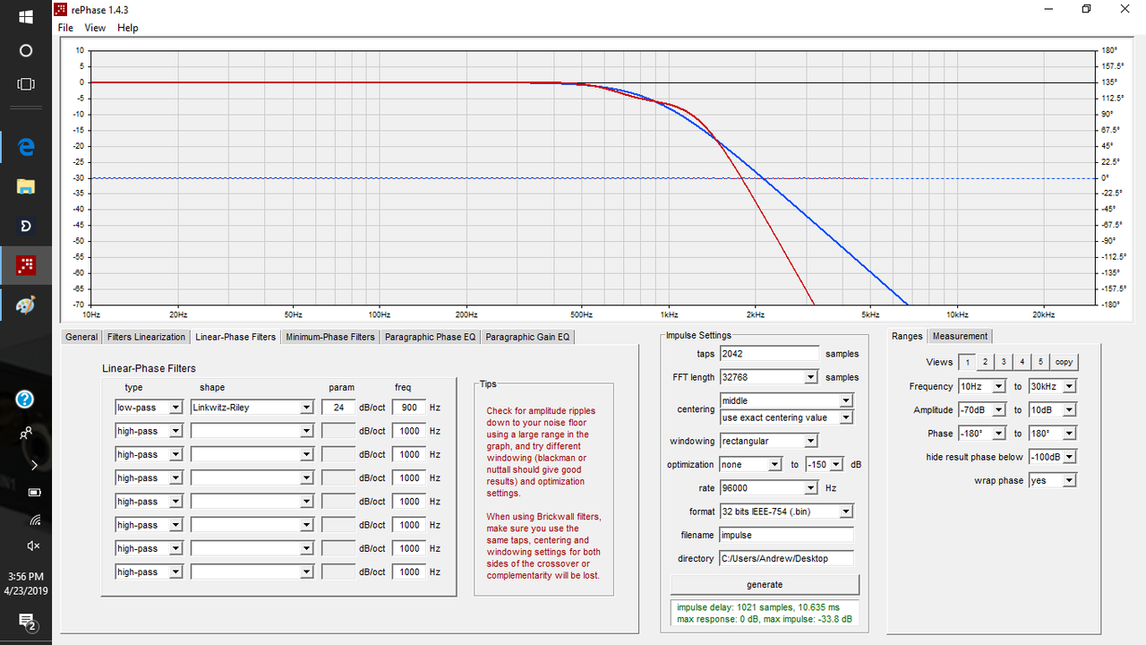

And the low Pass side

It definatly get rid of driver interaction with steeper slopes and has a oactave wide "crossover point" instead of the crossover point beinbg one frequency and everything under that is blending...
I like it because it attinuates the horn just enough so it can play down to the 600hz range and blend with the mid and the mid can play up to 1.6k and blend up there to reinforce imaging. the horn by itself sounds dry up in the 1k-1.6k range, and i like to hear the horns dynamics when it has small detail come out in the 500-600hz but not at full power....
its a excellent performing filter set for horns...I love it probably always use it

I get it now! Super interesting, full custom OX, almost an LR12, then 24 then 48.
Don't have much time right now but I'll try asap!
