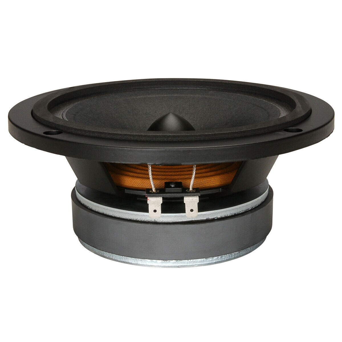

A safer bet would be something like the Visaton BG13P or Tang Band W5-2143. I don't know these brands though and I might just take a chance with the bigger Dayton.
I've used both in home audio projects over the years, no real issues. Tang Band does have a tendency to be a bit "optimistic" (i.e. higher listed than reality) with their specs. They're decently made and relatively decent sounding if used properly/within their limits. You project is definitely well within their capabilities.
Two that I have used before: The FaitalPRO M5N8-80 is an amazing mid with the right specs (12ohm nom, 99dB), but pricey and probably way too big around the magnet. The PRV 6MB250 (8ohm nom, 94dB) is ok if kept tamed (nasty 4K spike), but based on the info in daloudin's post that might not be an issue for your use.
Actually, I think the FaitalPRO would fit and I like the specs. I might end up getting that and in the meantime I can find out what it would take to restore the original speaker.
