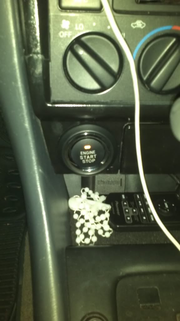

so long story short, my ignition harness burnt out last year. so instead of trying to repair it, i decided to convert the car to push start using an oem lexus button. i also added the smart key system, so when i walk up to the car it unlocks, and vice versa. the install itself was very simple overall, kind of like installing a remote start. the only hard part was finding a new place to install the button... i was going to put it where the factory key hole, but it was welded onto the steering column. after a couple of minutes, i installed it where one of the cig lighters were under the climate controls. i've had it for almost 10 months now, and i have no problems with is fortunately. the only thing i would complain about is when walking around the car the smart key arms and disarms frequently, setting off the siren all the time. here are some pics it installed. unfortunately i apparently deleted the pics off my phone. -___-

What the proxy sensor does is deactivates the alarm and also the start/ign kill that I installed. The push start controls the accessory, ignition, and also the starter like a new car with it. Nothing is activated then the sensor deactivates the alarm.
