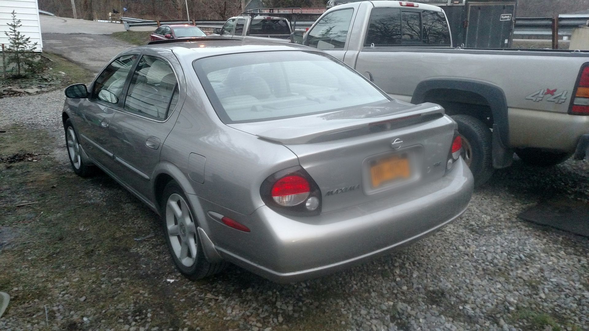

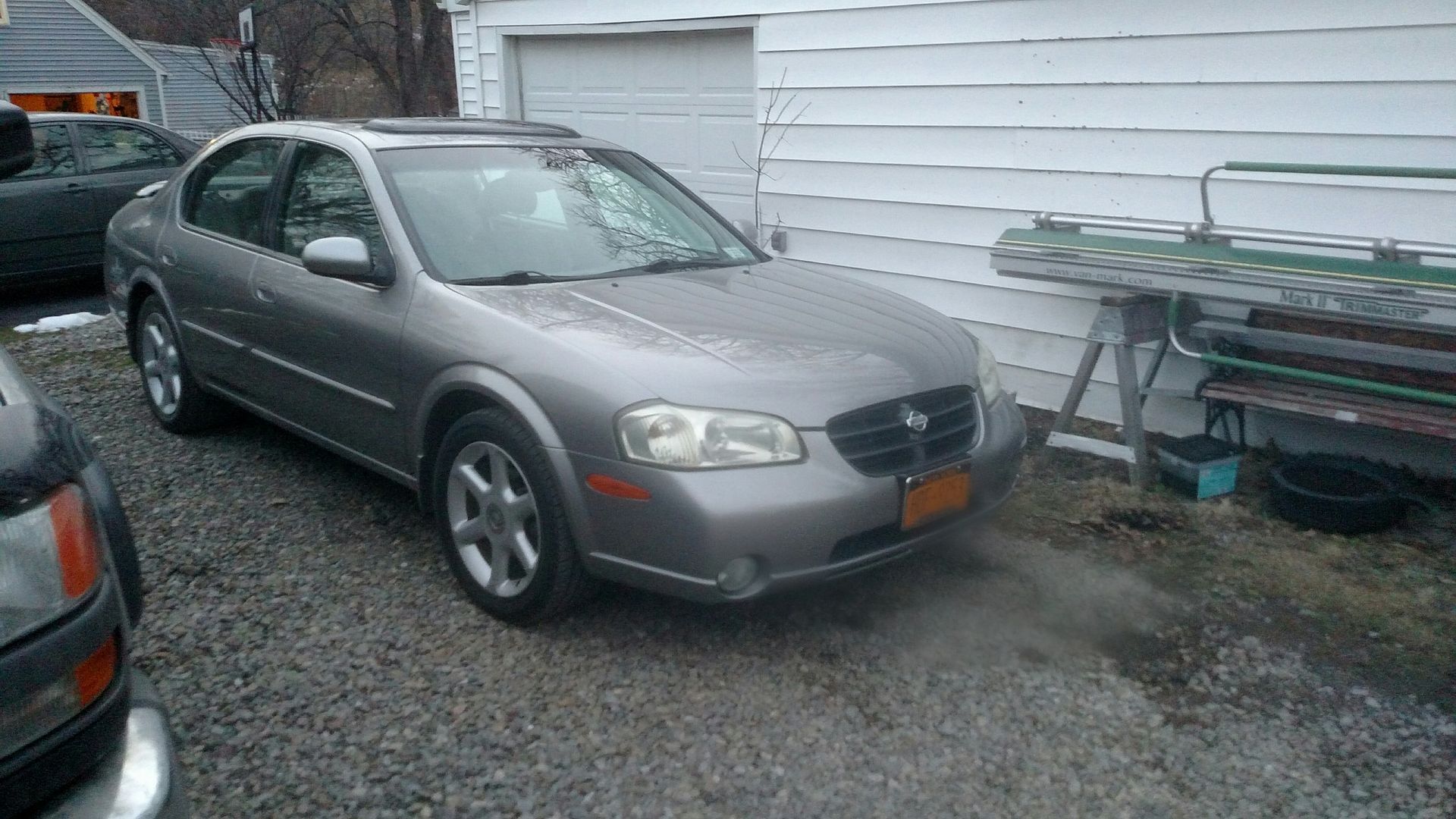

I have been looking for one of these cars for a while. I would have preferred the 6spd but only seen a couple over the last few years. Never seen the 6spd for a reasonable price. So 5 gears it is. The car has 168k looks and drives like it has 30k. I buy a couple cars a year for fun and this is the first time I actually had service records from day one. I've had a few people offer over the years but never took them up on it. Well I got them with this car and I read through them all. It was pretty cool to have a timeline. Almost nothing has needed to be done. All the matinence and wear and tear stuff. The biggie is all the clutch parts, struts and springs, and engine gaskets have been replaced within the last 32k. I paid less then 4000 for it. I bought it last Friday and have put over 1000 miles on it already. Love the car.
Ignore the work trucks in the background. They pay for my fun!
