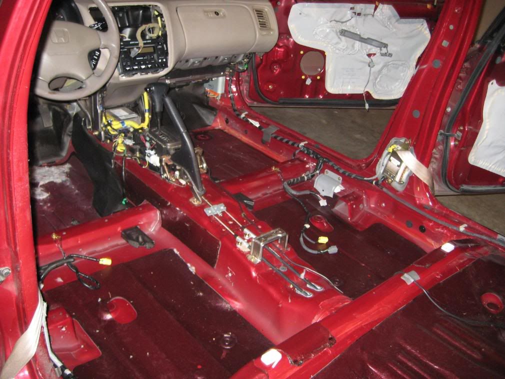

First started with gutting the entire interior:
Front
Rear
Trunk
Roof
1 - 16 of 16 Posts

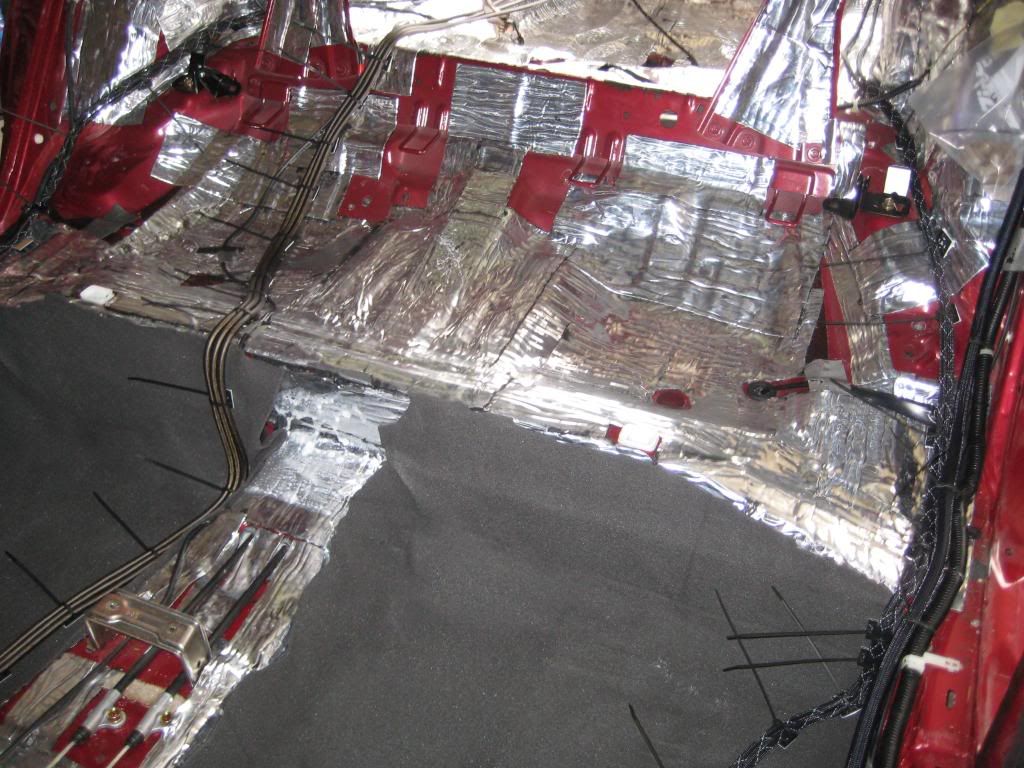

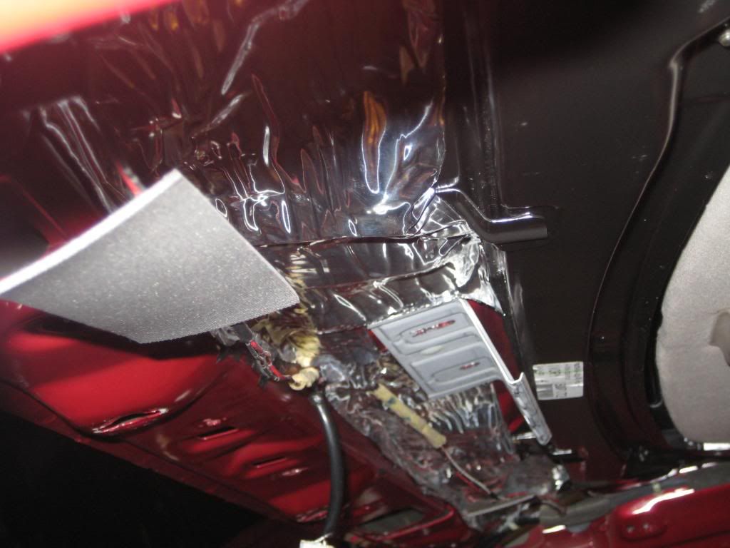

Sound Deadening:
If there was metal in applied a minimum of one layer of RaaMmat and Ensolite. Ordering from Rick over at raamaudio is a breeze. Even though I have used him before its shocking how quick he ships.
An observation, on my next vehicle I think I would start with a sludge or Mooble's elastomeric goo down first. Next time I’ll use luxury liner too.
Unfortunately I had a computer crash and lost many of my pictures documenting my build. Not pictured is the doors. I applied three layers of RaaMmat to the inside of the outer shell of the doors, one layer to the outside of the inner shell of the door, and two layers to the inside of the inner shell. In addition I used a metal screen material to cover most of the door holes and covered that with a couple layers of RaamMat then added Ensolite over the entire door.
Floorboards covered RaaMmat:
Part way through on Roof:

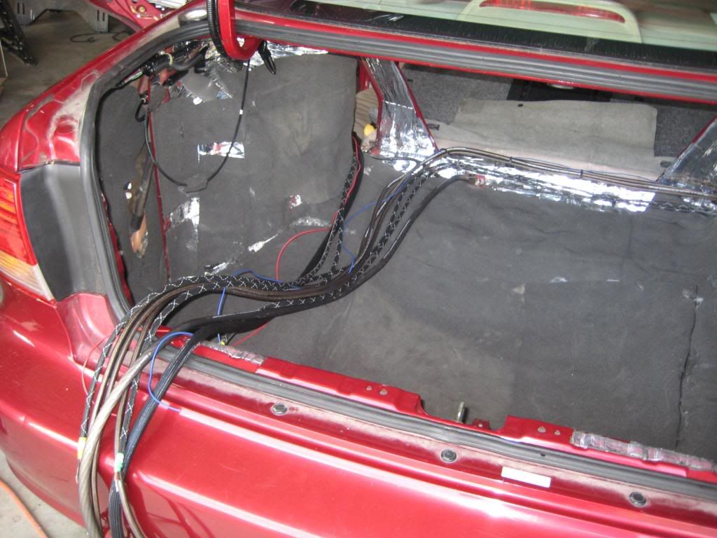

Trunk covered in RaaMmat (it also has a layer of Ensolite but no pictures):
Under Rear Deck:

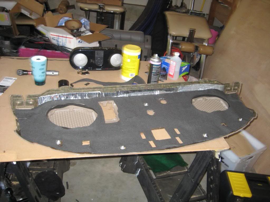

Rear Deck Trim Panel added RaaMmat for weight and Ensolite to help with rattles:

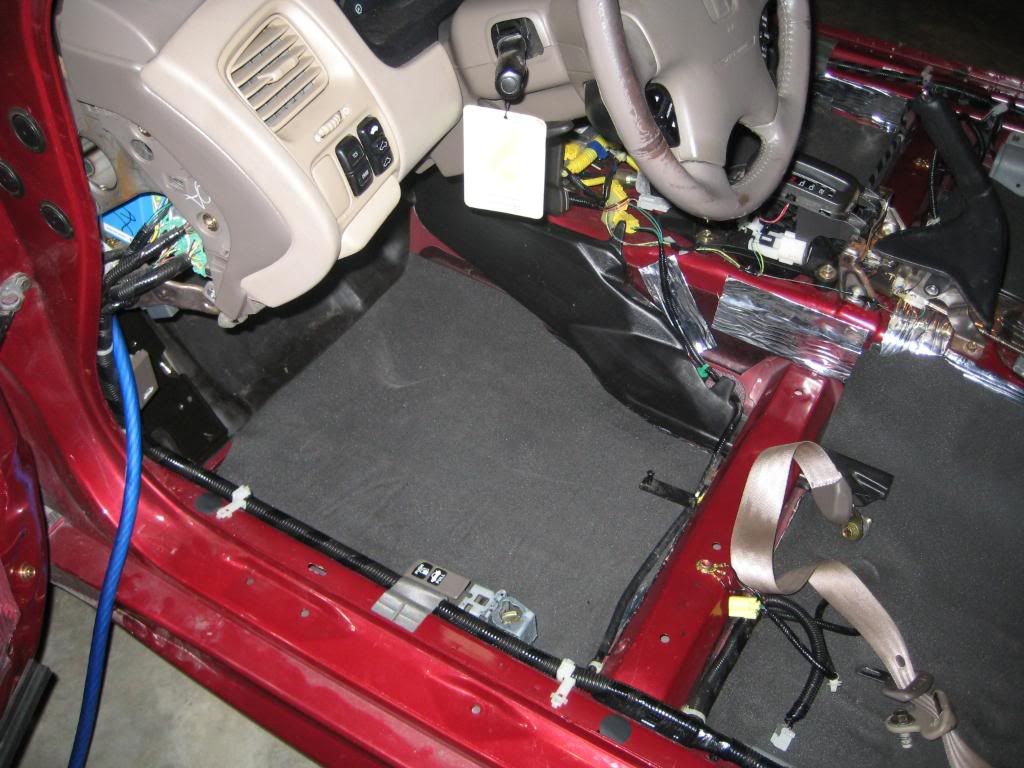

Drivers side floor boards covered in Ensolite (you can see 0 gauge wire too):
I like the deadening job, that thing is going to be quite!
Good times!! It does look quite familiar. Let me know if you come across anything or need help. I've had my 98 four door stripped to do the same thing. I'll be interested to see how you bring it along.

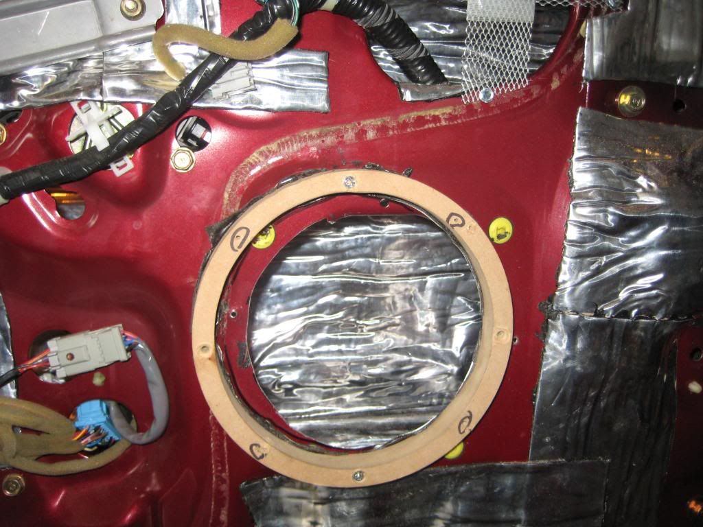

Problems installing my CDT ES-6’s into the doors. First the speaker would not match up with the door card opening. I had to make some minor changes to the door by cutting the stock location a little larger. If this wasn’t enough the speakers were too deep and wouldn’t let the window roll down. I had to cut the stock speaker grill off the door card.
Initial baffle fitted to door:
Traced area where door needed to be cut with magic marker:
Cutting hole larger with my trusty jig saw:
Hole finally cut and sharp edges sanded down:
New baffle affixed to the door:
GREAT SUCCESS speaker finally installed:

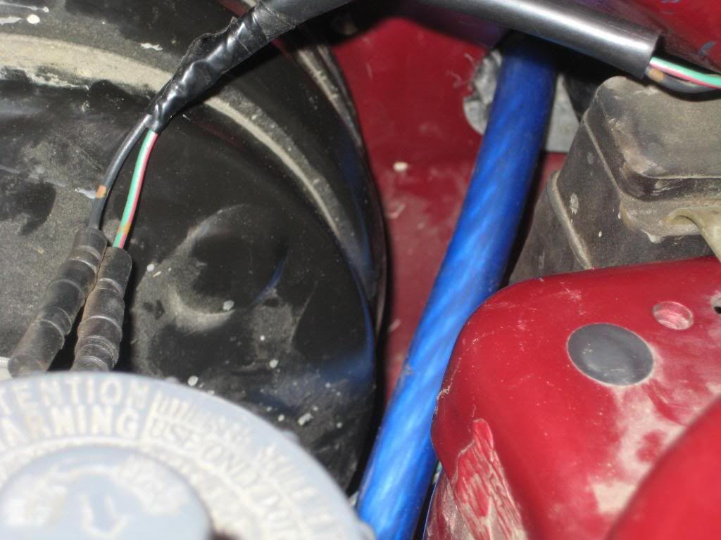

Here are some pictures of wiring that I have done. I put a circuit breaker right off the battery and ran 0 gauge down the Drivers side to the trunk into a fused distribution block. RCA’s ran down Passengers side, and speaker wire ran from trunk to doors. All wire from KnuKonceptz.com. Head unit is an Alpine 9887 running active. Eventually I would like to purchase an Audison Bit One!
Everything but RCA wires has been tech flexed, shrink wrapped and labeled. I found the the 1/4 in tech flex from parts express fit everything except the 0 gauge.
First pictures are test fitting the 0 guage power
Pictures of Power run down driver side. RCA's run down passenger side and speaker wire run.

Techflex that bish! No seriously, you have a sharp edge there. Over time it will cut into the insulation and you could potentially have a very nasty short. Either wrap the wire in something or put something around the lip of the firewall.
