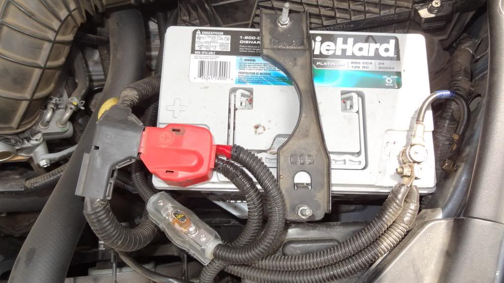

Big 3 in engine
Diehard Platinum battery

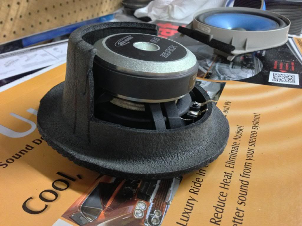

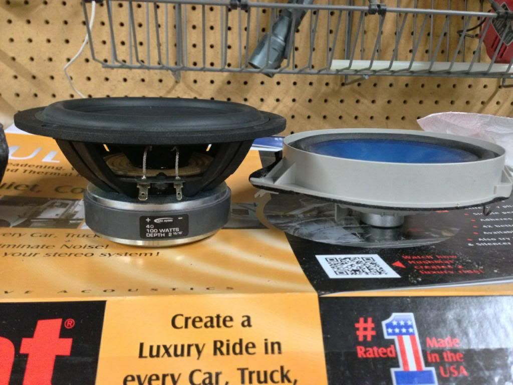

The Black 6.2 midwoofer compared to stock:

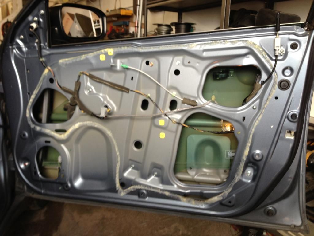

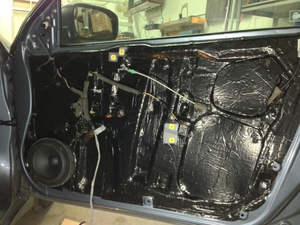

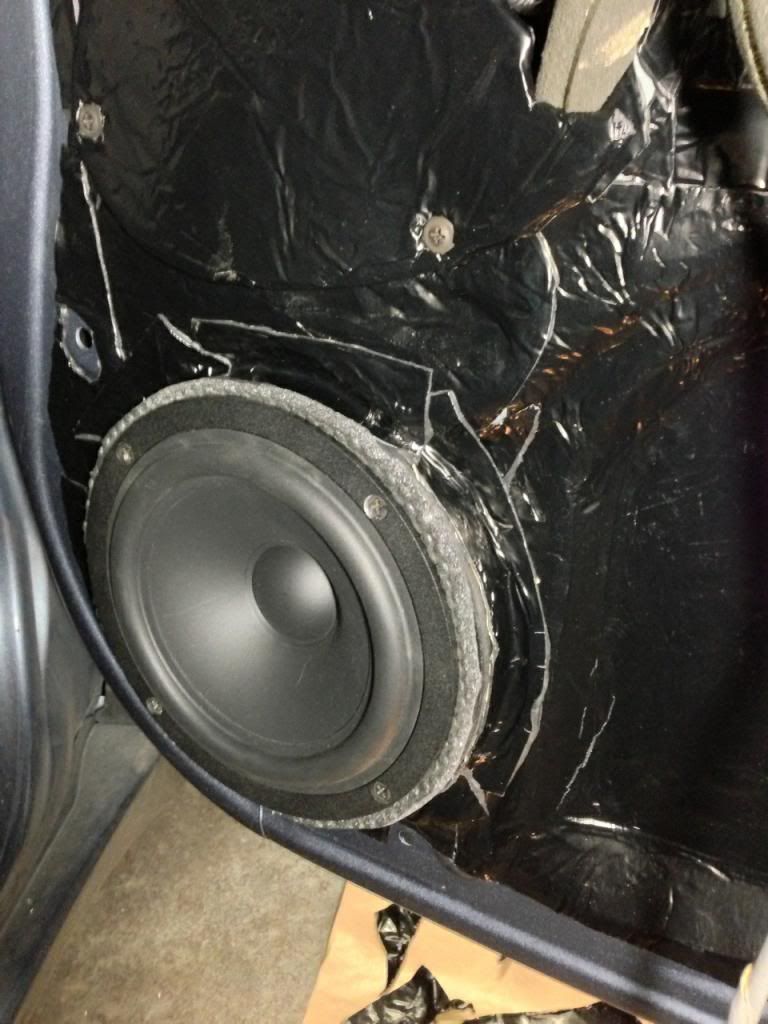

Doors:
Easy access compartments:

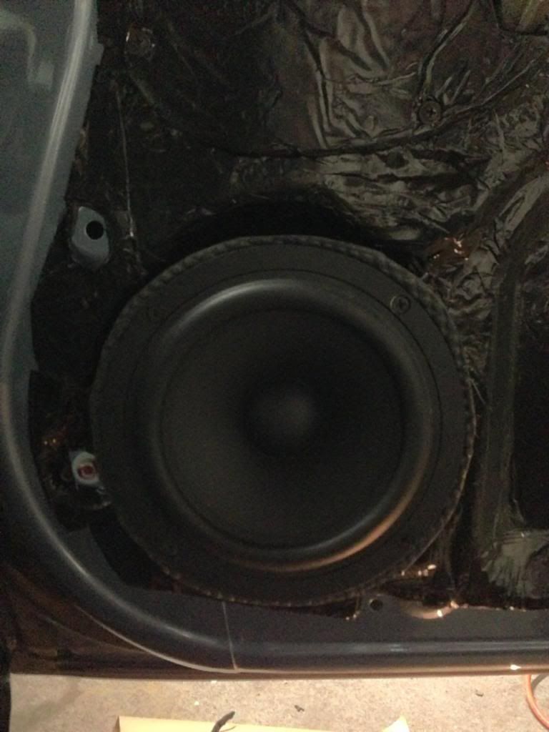

Doors continued...

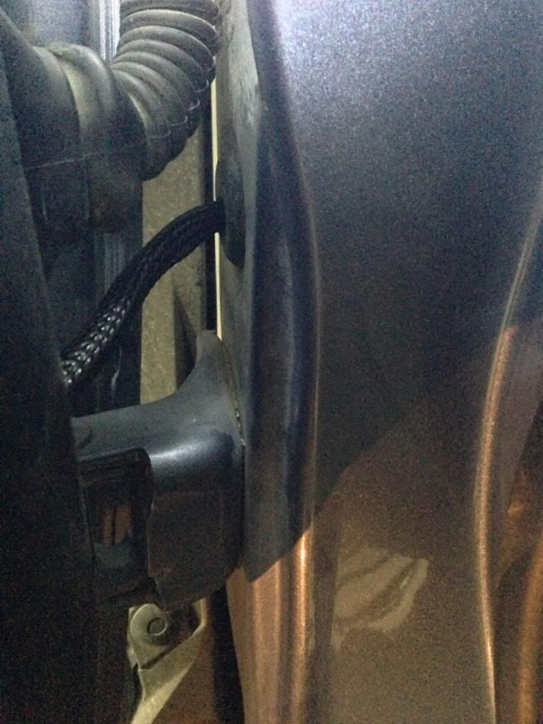

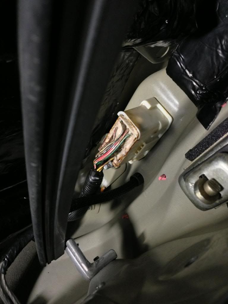

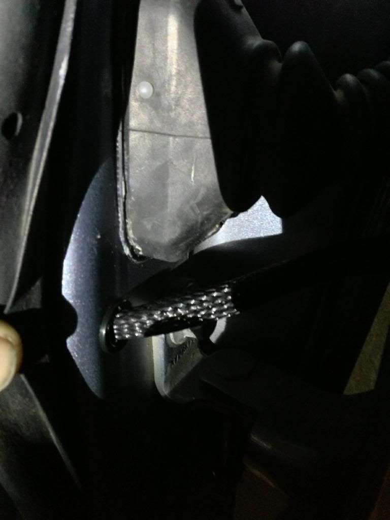

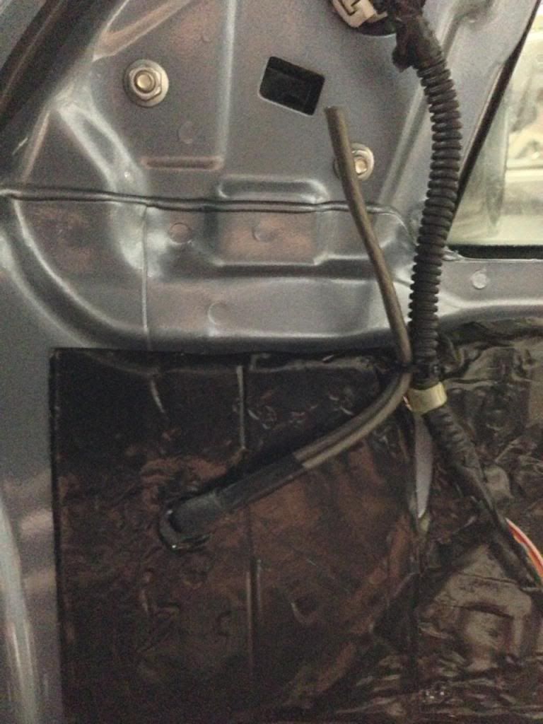

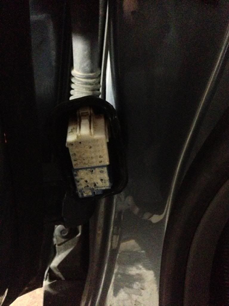

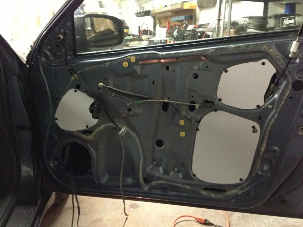

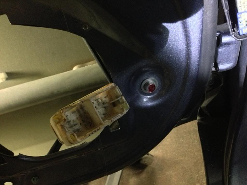

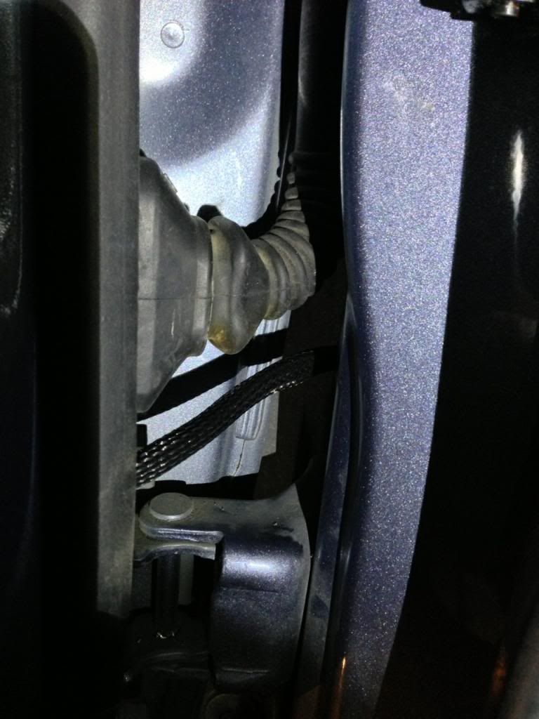

Molex in driver side rubber grommet blocking path for new speaker wire:
New hole:

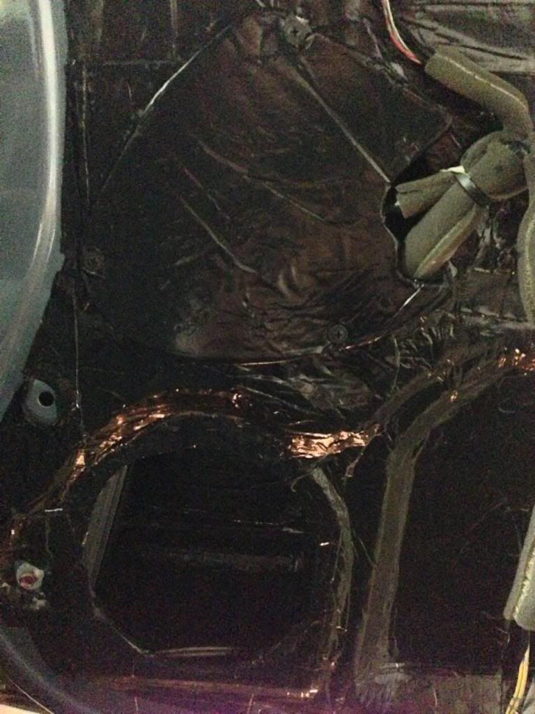

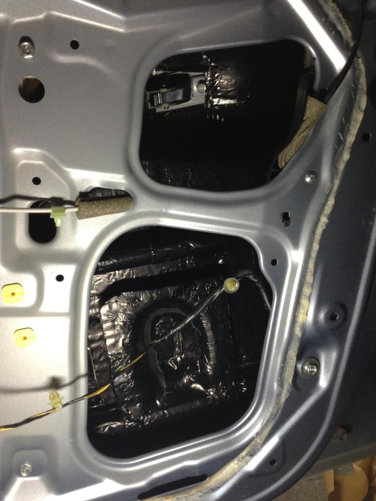

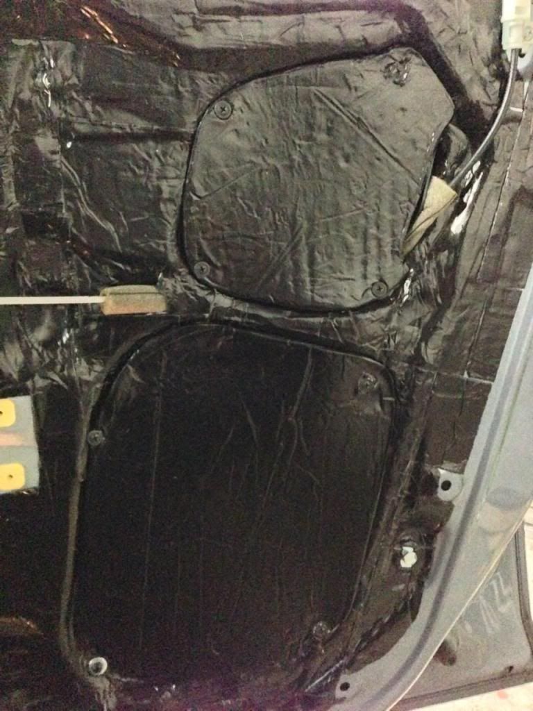

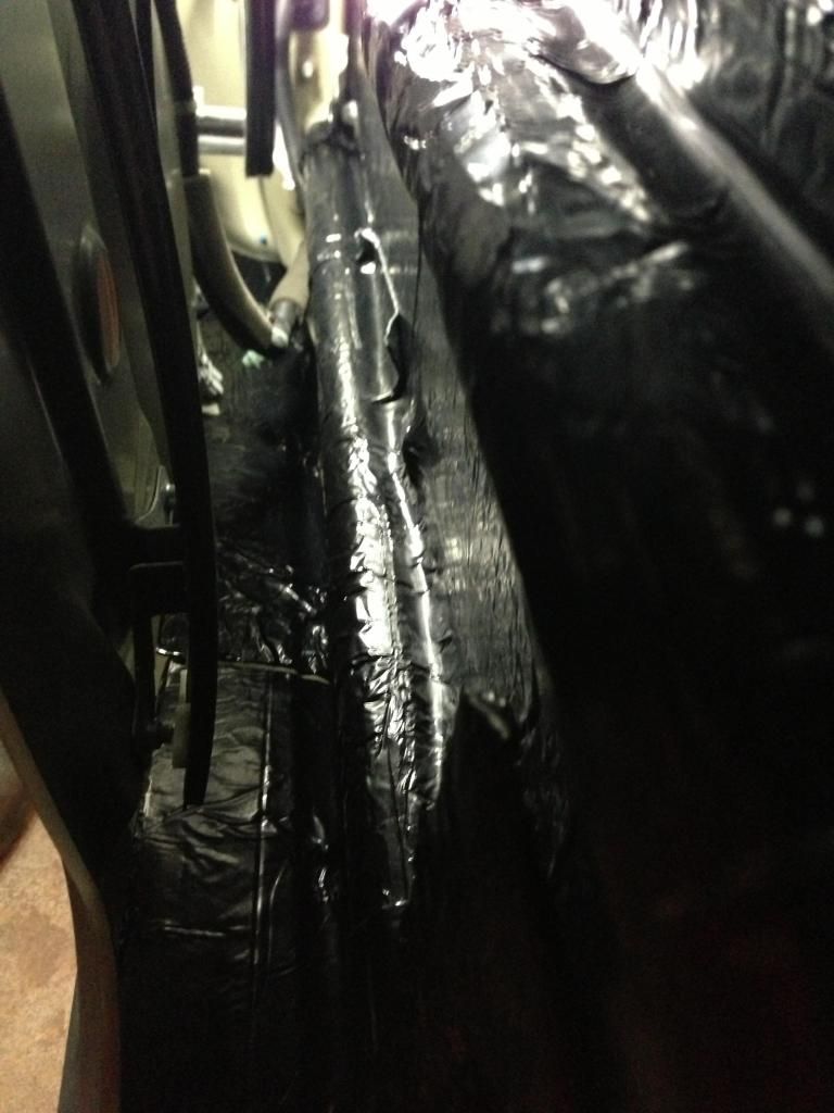

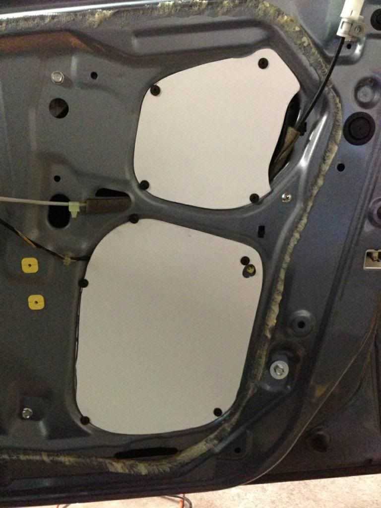

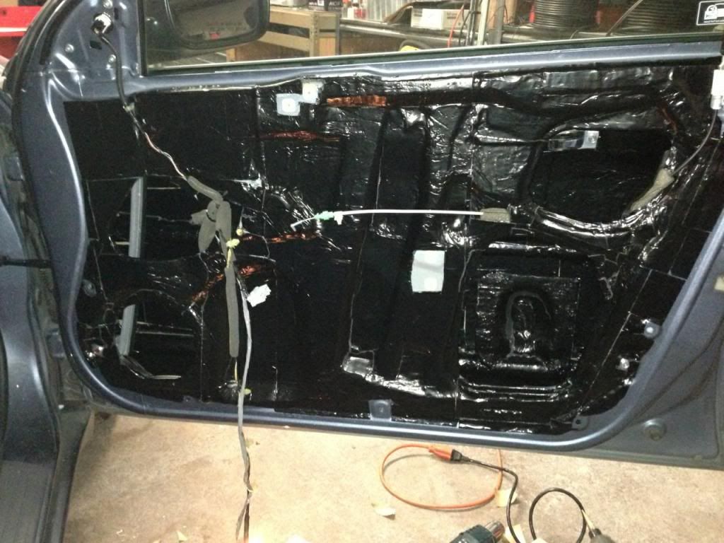

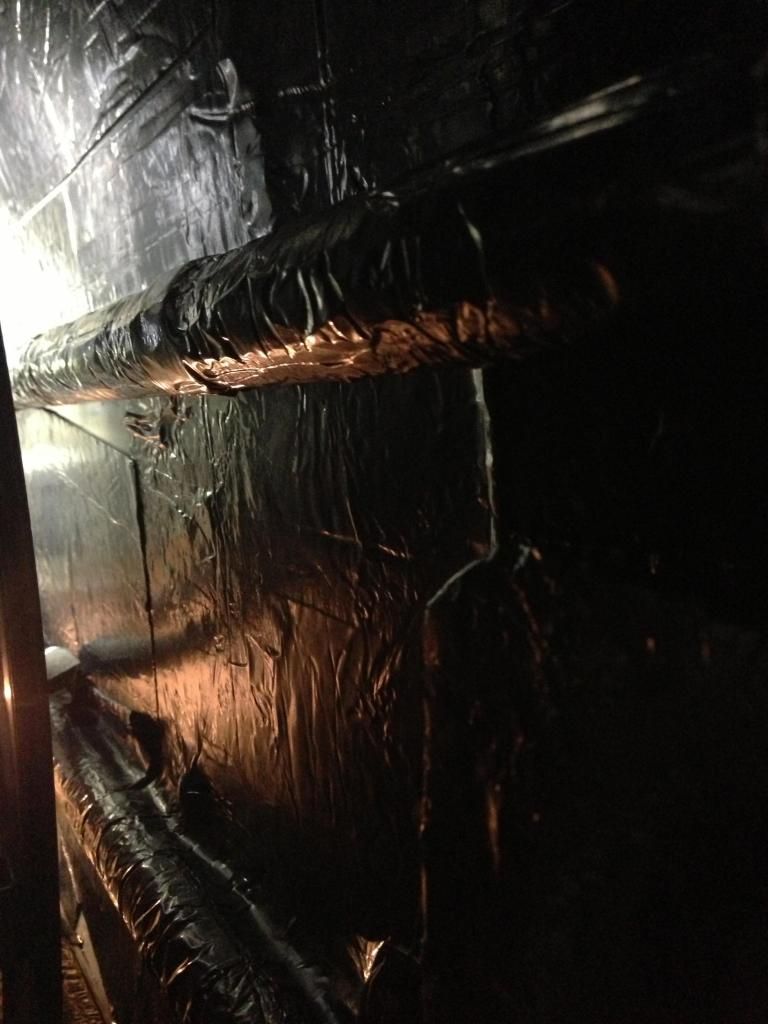

Finished Hushmat, little over 16 sq ft per door:

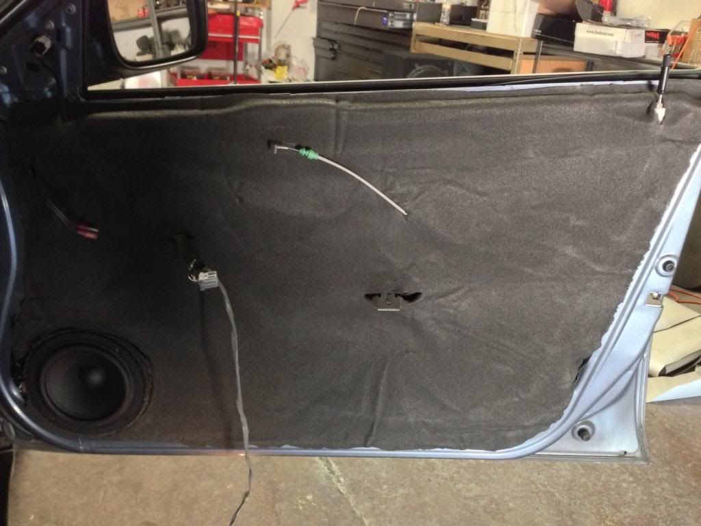

Finished Ensolite:
8
Looks good. I'll probably have to do the same thing on the drivers side door in my 03 accord.
Lovin' how you put in the speaker wire (driver side). I just drilled a hole in the white harness connector thing. How big is your wire?
All credit for this build goes to my installer. He's been my installer for about 3 years now and he's a great guy. I've learned a bunch from him and plan to have my own go at installation at some point. I'm not sure how big the wire is, but he thought about drilling a hole in the harness thing, he had done it before, but chose not to this time.

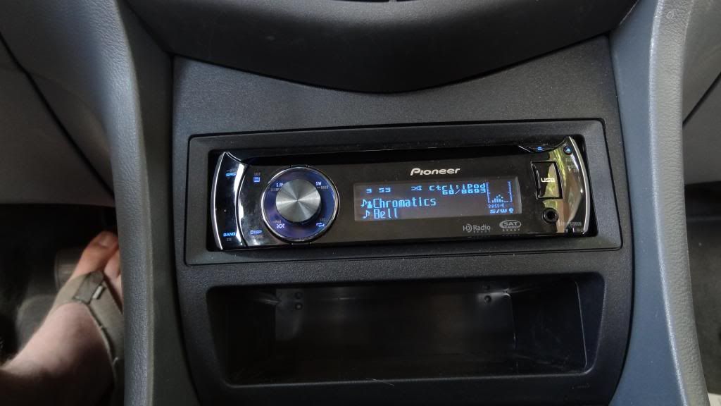

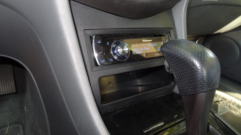

Honda Accord harness kit and Pioneer DEH-P5100UB installed

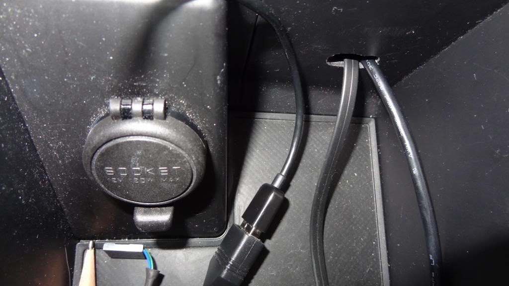

Hole drilled in large center console for iPod USB cable and BitOne console from headunit

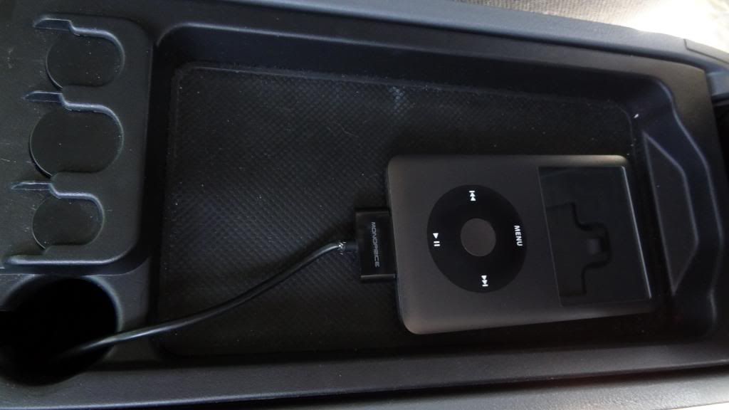

iPod in small center console compartment. The iPod cable is loosening at the end, replacement from monoprice is in the mail. Lifetime warranty ;)

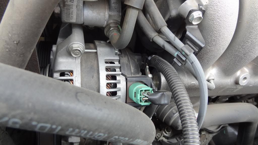

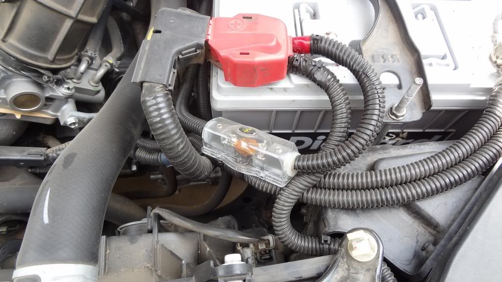

Engine power upgrades:

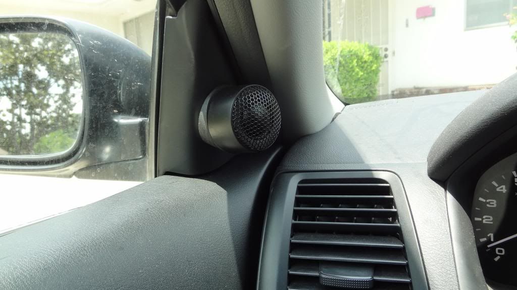

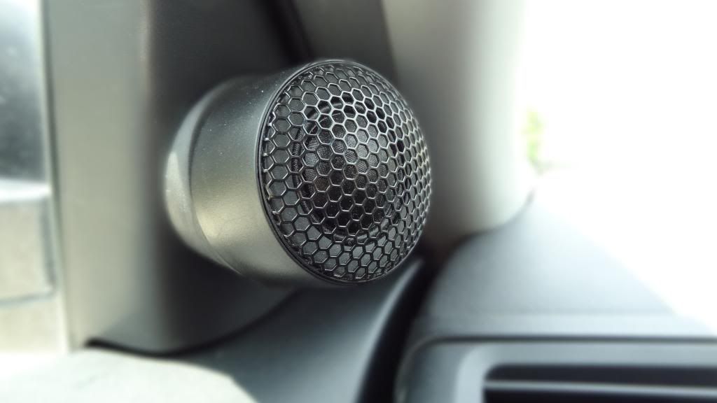

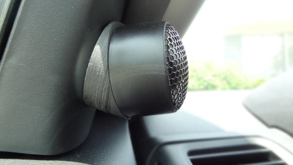

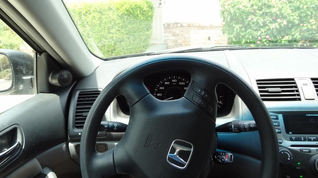

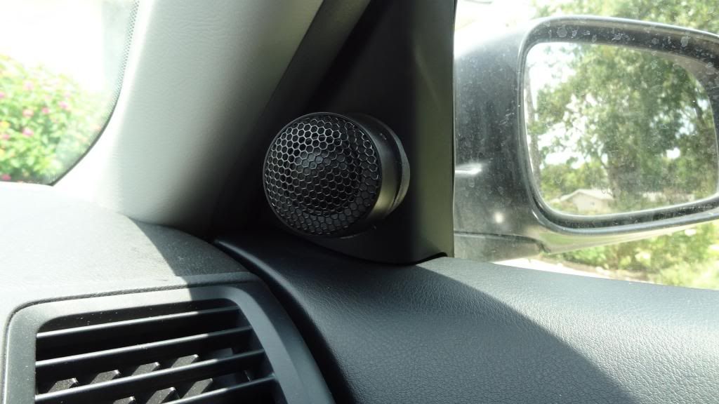

Tweeters, was a quick install, my installer wants to wrap them and make them look nicer, but I'm in no hurry. I'd rather put that money into another sub or dif amps ;)
9

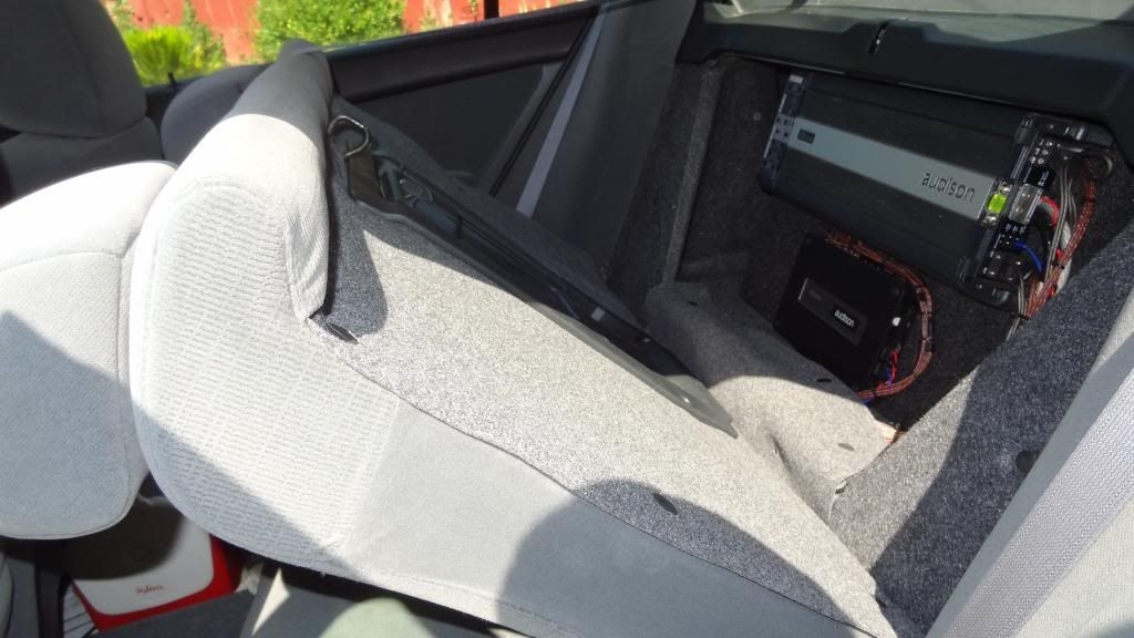

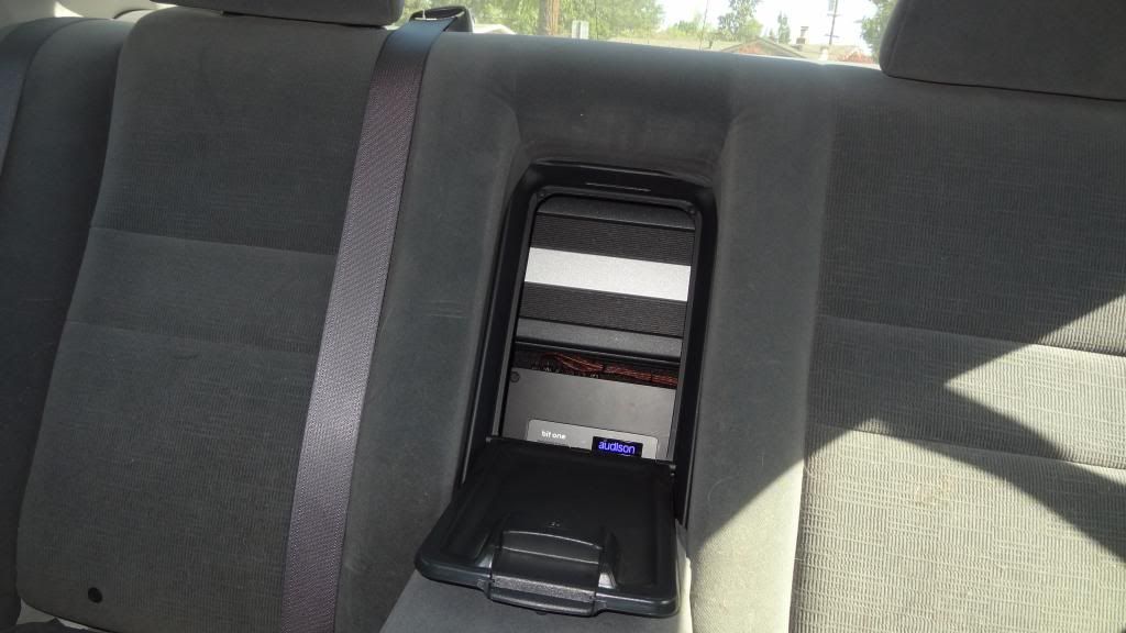

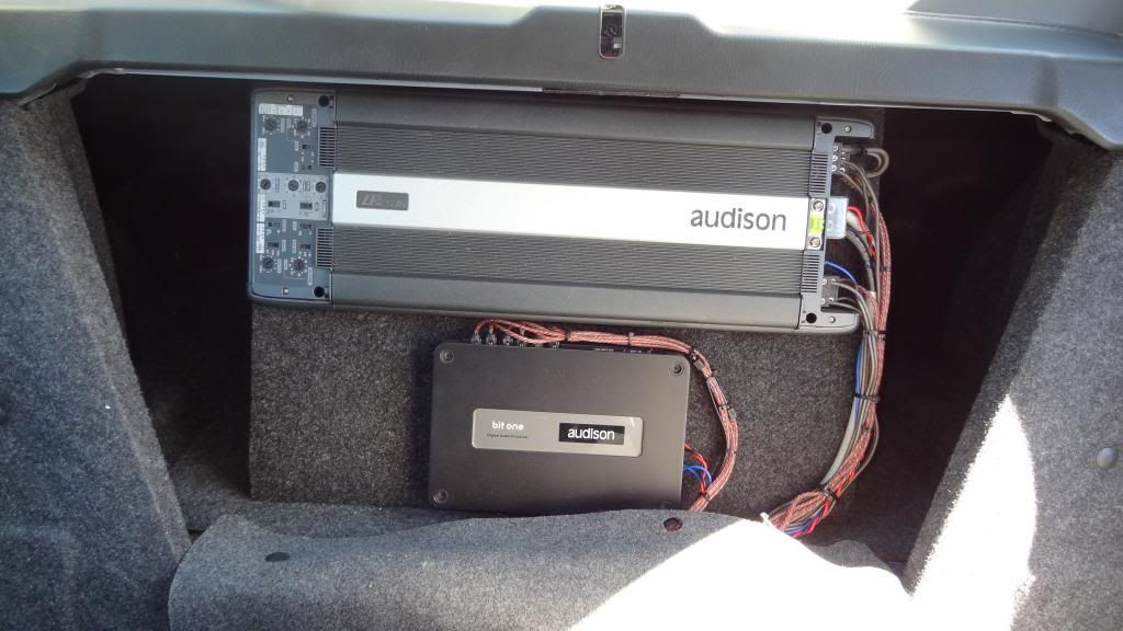

More pics...
6

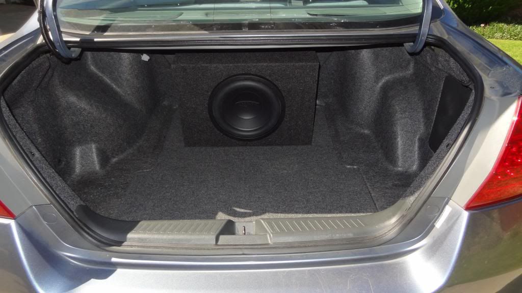

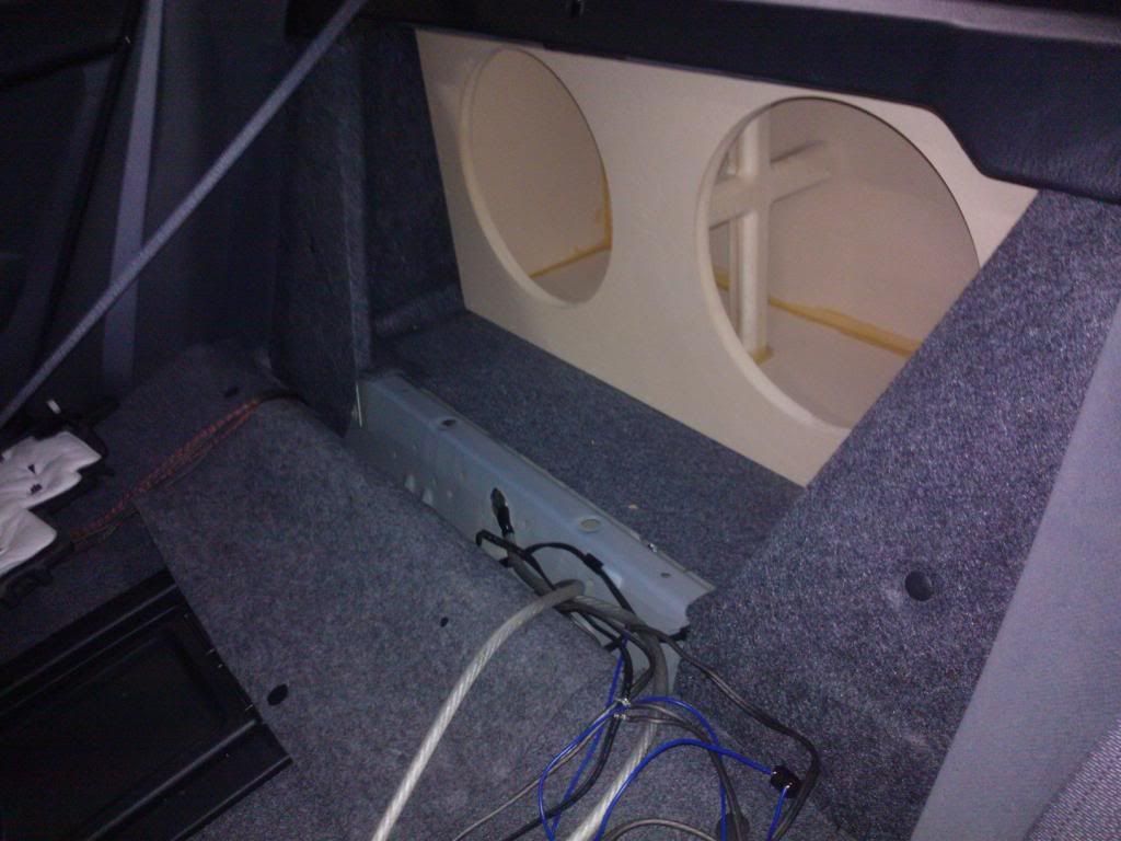

Pretty stealthy looking install outside of the subbox, nothing is really visible. I hope you have that box bolted right down to the car frame however. If you don't, one good box slide and you could have serious issues. I am sure you thought of that already.
Funny, I had the ML165 set as my first venture into true sq as well. I came across a deal on a set of Morel mt22 tweeters and it was like my high end clarity was 100x better instantly and that is one of their lower line tweeters! I have since moved up to Scanspeak D3004 tweeter which is very similar to the Morel but with more hi extension - a little ah... airier? In my battle to get solid midbass/subbass in my last vehicle I grabbed a set of Morel mw265 8 inch home drivers and had them installed. There was a gigantic difference in midbass punch and clarity too. I was hearing things I had never heard before in songs especially subtle bass electric variations. Truly worth the effort to get larger midbasses in your doors. Floor would be even better. I got to hear that in Florida (thanks Steve!) and it was very impressive. Much better imaging and no rattles!
As for subs, I had a Hertz ML2500 before my Ultimo and it was a nice addition although it never seemed to have much output. I think it does alot better in the upper ranges than the lower and that vehicle had a drop out in the upper sub frequencies so I think that was the major contributor to that. Funny you mention that JBL sub, I just checked and it is still for sale. Man, if I only had the money to spend. Would be an easy fix on the box with all of the glassing stuff I have here and it would make an awesome spare. I probably would of offered him something for it if it was not a truck box. the box would have to fire up and it would take up more real estate than I am willing to give. If it was an IDMax, I probably would have grabbed it if I liked its sound. I would love the extra 6 db or so of sensitivity for one and the fact it is about 3 inches less deep. If only I could here one. Maybe on my return to Florida next March for SBN. Really looking forward to that and I really hope I can cross off alot of these 'must listen' items off my list then.
Yeah, that box is bolted down with a couple L brackets, you can kind of see it in the last pic.

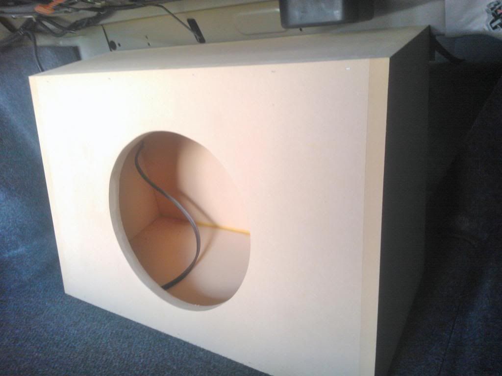

I haven't taken many new pics, no point really, but here is my new sealed box I'm using for my IDMAX, came out real good, props to my installer for that, didn't want to spend extra on carpeting since it is just a temporary thing, and was going for as cheap as possible :)

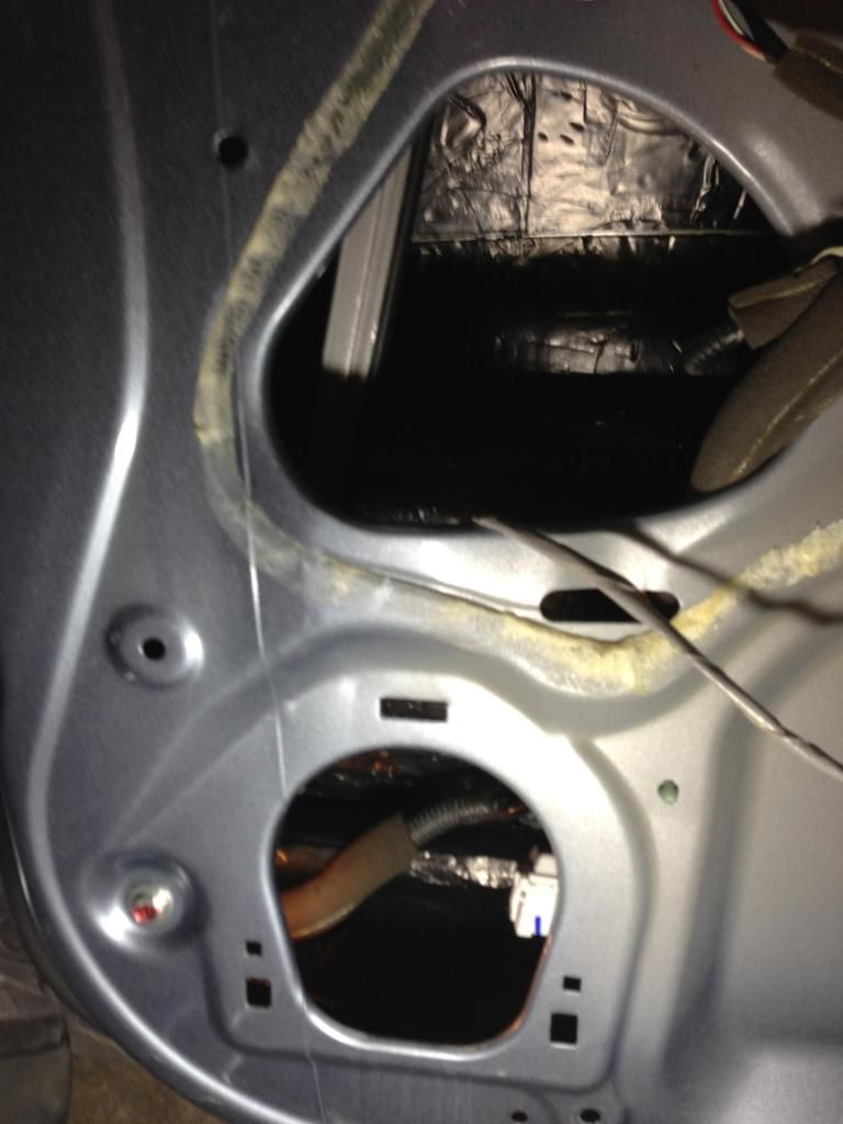

I’ve always had major buzzing/resonance in my doors during certain songs, even though they are super deadened (Hushmat inside/outside, and Ensolite over that on the outside). I’ve read others on here giving up on their Accord doors because they are just ridiculous with resonance, but only certain songs. When it happens, if I just press on the actual window, or crack the window a tad, it goes away. So to try and improve it, Focal Blackhole Tiles will be added inside the doors around the back of the speakers, and the door cards will be mass loaded with Hushmat.
So it’s not finished yet, but here are some pictures so far
9
Reactions: 1
Looking great so far man! Nice job on deadening the trunk too. I am also glad (or is that sad) to see that I am not the only one fighting door resonances even after some serious deadening. Funny how we are both considering the same solution now - Focal Black Hole tiles.
Oh, and my vote is to turn that box around. It will look so much better not seeing all the wiring and the amps as you crack open the trunk; especially if this is your daily driver. I guess another solution could be a beaty panel on the back of the box covering over the amps too.
Very interested in hearing how the subs sound firing into the cabin.
Sent from my SAMSUNG-SM-N900A using Tapatalk
Thanks guys. If I love the way it sounds firing forward, I'll probably have the amp rack carpeted or painted, but I actually really dig seeing the amps and wires like that, has a very industrial look to it. It will also look a bit cleaner when everything is hooked up and you won't be able to see all the wires that are currently laying around the trunk floor. I'm all about placing the most importance on how it sounds, and the least importance on appearance, and my wallet sort of thanks me for that. :p
I have a 7th Gen accord also (2006)
nice to see a build log with so many familiar things :cool:
I was running the Arc KS Amps for awhile myself good choice on those.
p.s. Did you manage to fit the Arc mid in the door with a single 3/4" mdf baffle? I'm not sure the exact mounting depth we have to work with
