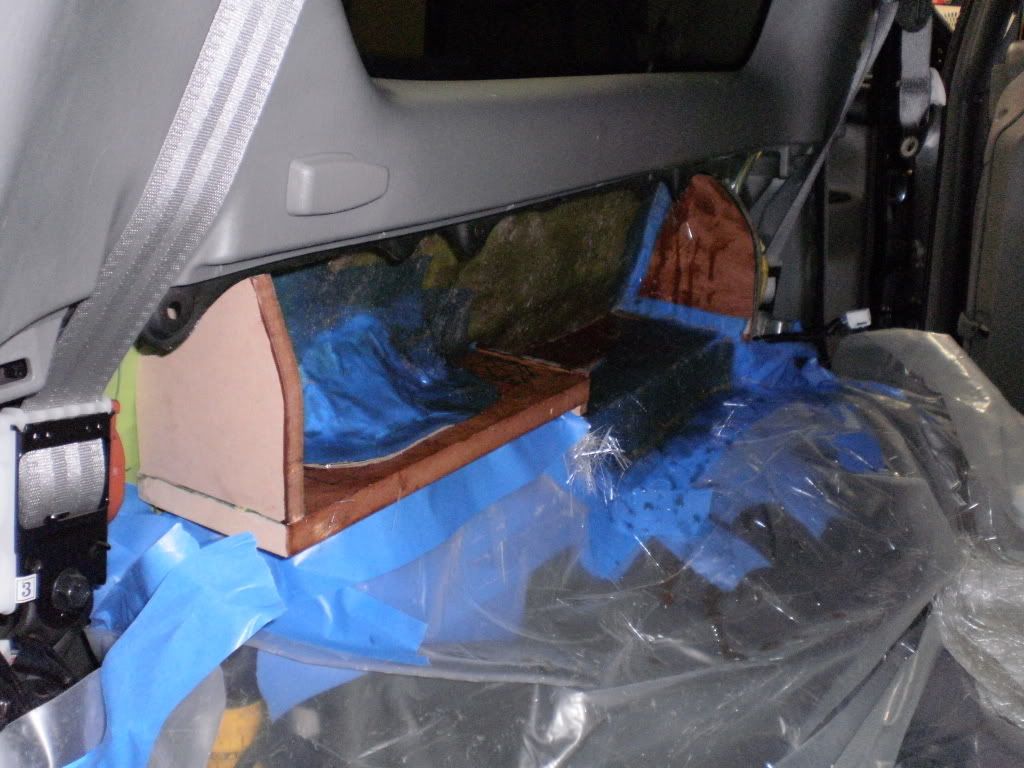

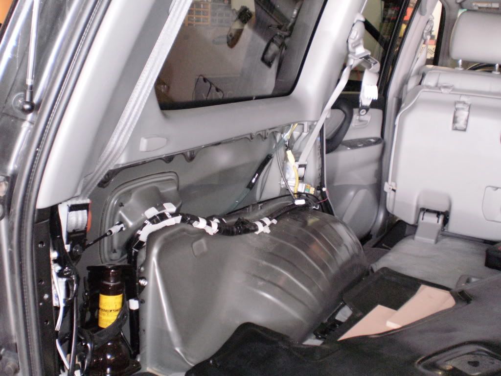

Arc Audio KS125.4 Mini & KS 125.2 mini
Installed In Rear side pannel pocket
All Wire'n Finished up (For the Most part)

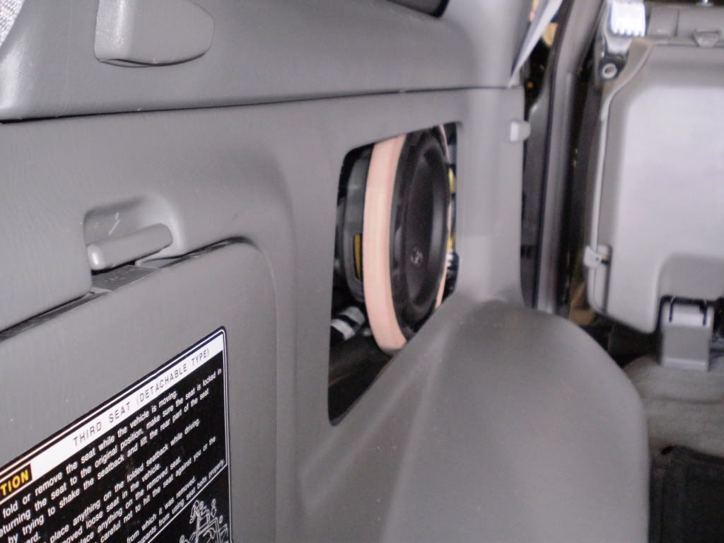

Sub
JL Audio 8w3
Install In OE Location of JBL6"
Check it..

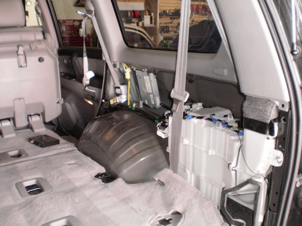

I know this is a few years old but I am about to emulate your awesome work in my own Land Cruiser.
Looking at the long, narrow storage compartment on the right side cargo area, how did you mount / fasten the amps?

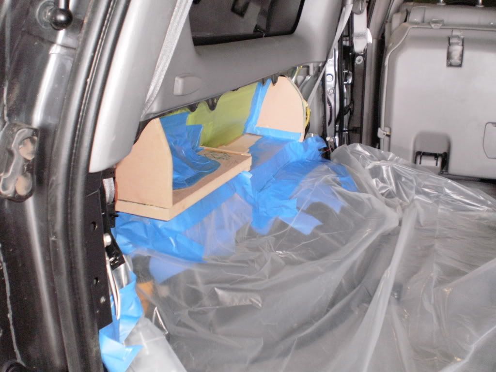

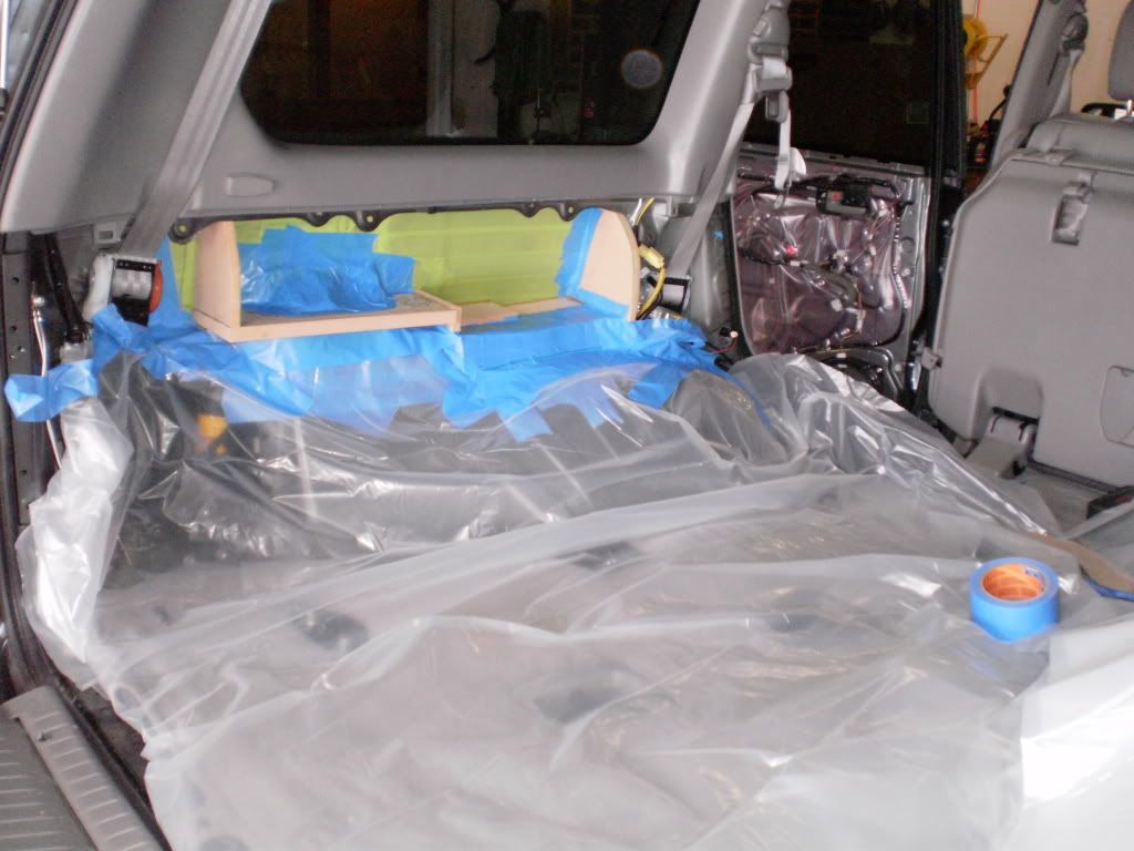

I would change a few things since I have learned alot since I did this install..
I would have made a 2-Part foam mold of the enclosure it would have fit much better and the finished would have been more OEM looking.
for the amp I used 1/4" with "Kent Tape" dbl sided tape with small screws from the under side.
