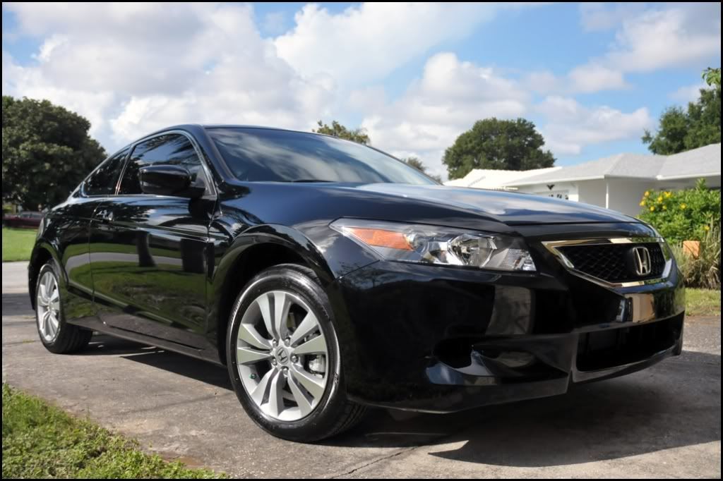

This will be my official 2010 Accord Coupe install/build thread. I've been planning the build for several months acquiring parts and components. Plans have changed a couple times since the beginning and may again, who knows but for right now I think I'm ready to go.
I have been into car audio since the late 80's and have had several moderate systems over the years but this is going to be my first real install with the idea of competing in the future. I will be going all out with sound deadening the entire vehicle etc.
The system will be an active system built around an Alpine IVA-W505 feeding a Matt Roberts modified H701 processor via digital optical. I considered going with a 9965 but really wanted the all in one nav,dvd etc.. with the 505. Amplifier duty will be all Zapco Reference and DC Reference. Speakers are Dynaudio MW162 (mids), Scan Speak D3004/602000 (tweets), Tang Band 4" bamboo cone (rear fill) and a pair of JL Audio 12W6V2's (subs).
This is probably going to be a long term affair as I will only be able to work on it in my spare time. Those of you that have families with small children know how "spare time" is an oxymoron. In any event I will update this thread whenever I make progress.
Here is the car in question...
