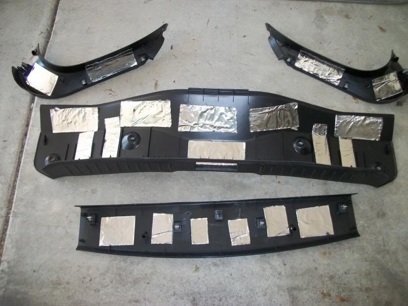

Meanwhile, I dove into the hatch and rear door. Layer of mat on the floor, with a layer of Ensolite ontop. All plastic trim panels got a mat layer as well. No more buzz when the hatch shuts, now its a very solid thud.
I did pull the panels for the sides on the tire well, and there was significant factory foam back there so I left it for now. If I feel the need to add more later I will.
