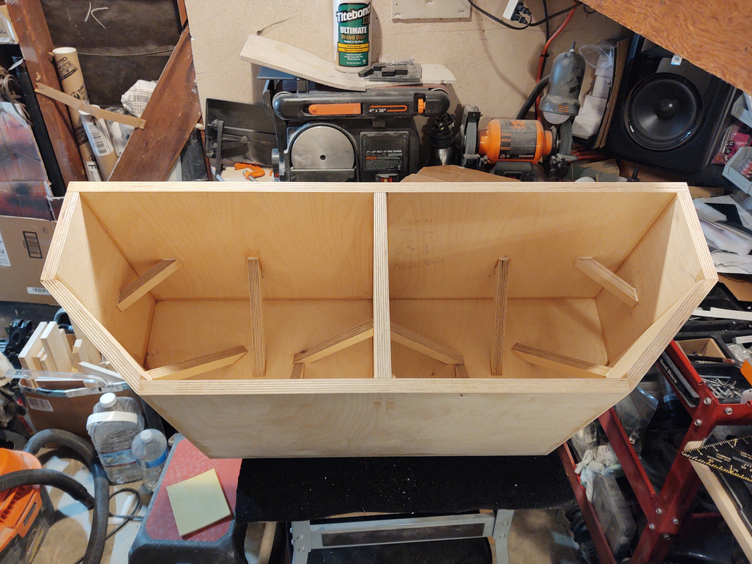

Just some simple sealed boxes I'm working on right now - first, one for a pair of 12" Brahmas & next, a sealed box for a 15" Brahma. Power is 2,000 @ 2 ohm from an Mmats M2000.2.
The two 12"s will get 1.15 cuft each, in separate chambers. As always, 3/4" Baltic Birch... :)
I know, I know. I didn't miter the joints properly... I didn't feel like doing all kinds of geometry! ;)

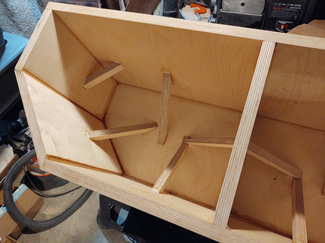

This box doesn't really need much bracing as the individual panel runs are pretty short, BUT I decided to have some fun with some wood scraps!
All the joints are really clean and tight, I'm extremely ocd about that. I don't like to fill in cracks, if it doesn't fit tight I cut another board...

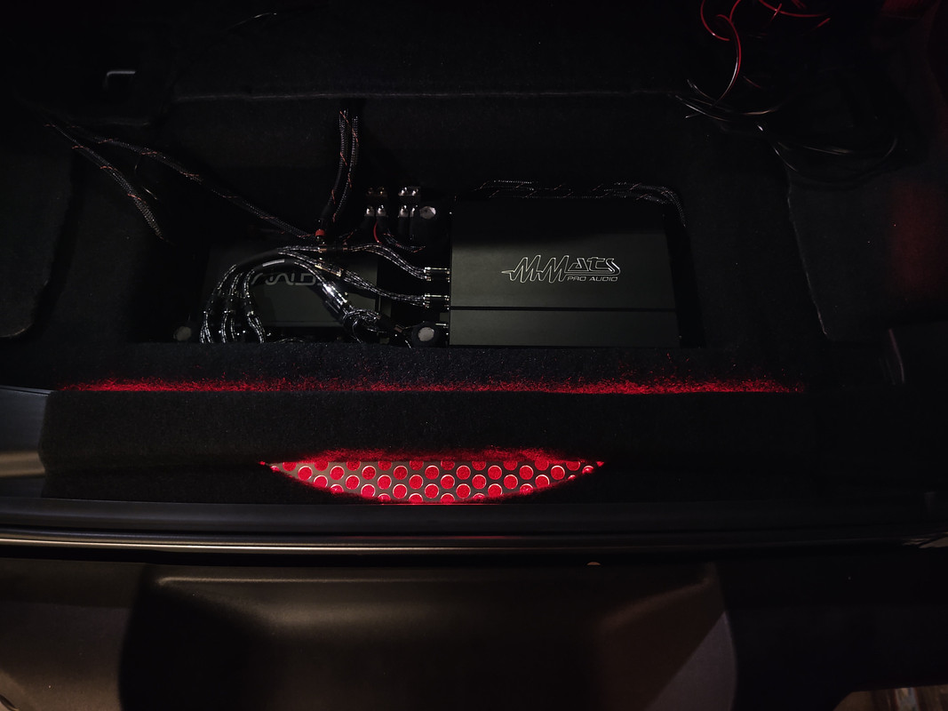

That's as far as I got for now. It will be finished with carpet, perforated aluminum and red LEDs...
The destination:

Hmmm nice 👍 .. got 45-degrees angle/design there like a gaming product 🤩
Hmmmmm, you're right. I never thought about that...

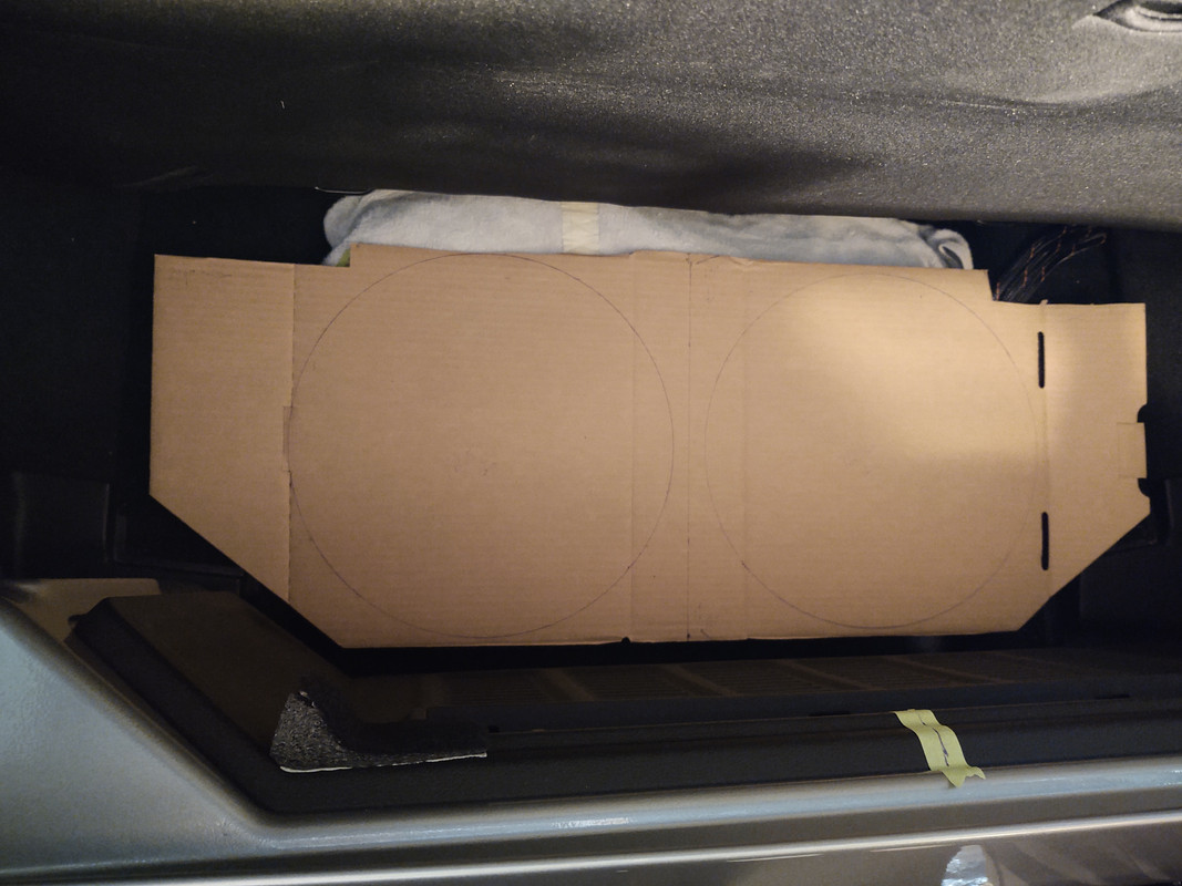

Regarding the upcoming 15" box build... I'm pushing it trying to get the 3.4 cu.ft in my little 2 door Jeep. I'm thinking of facing the sub towards the tailgate? Is that good or bad for sound, compared to aiming it forward nearly pressed up against the back of the seat?

I have my sub/box facing the back panel in both my CX5 and in my Sienna and it works well, especially with cabin gain. An external port for a bass reflex box is nothing new and can save a lot of space because you don’t have to subtract the ports displacement from within the box, which makes for tidier box dimensions.
You can also always build a test box too to try out different positions before you commit to one. A DSP also helps with minor phase adjustment.

i would face the sub towards the rear if you can.

Rear facing generally gives you more output.
Interesting... Rear facing is the most convenient for building the box, too. So rear it is.

Yes, gonna have to have it modeled to see if I can even fit a port, as the box itself is gonna take up almost the entire trunk volume... Which would make the port have to stick up and be visible through the rear windows.
Or I could poke it out of the roof like a periscope!
