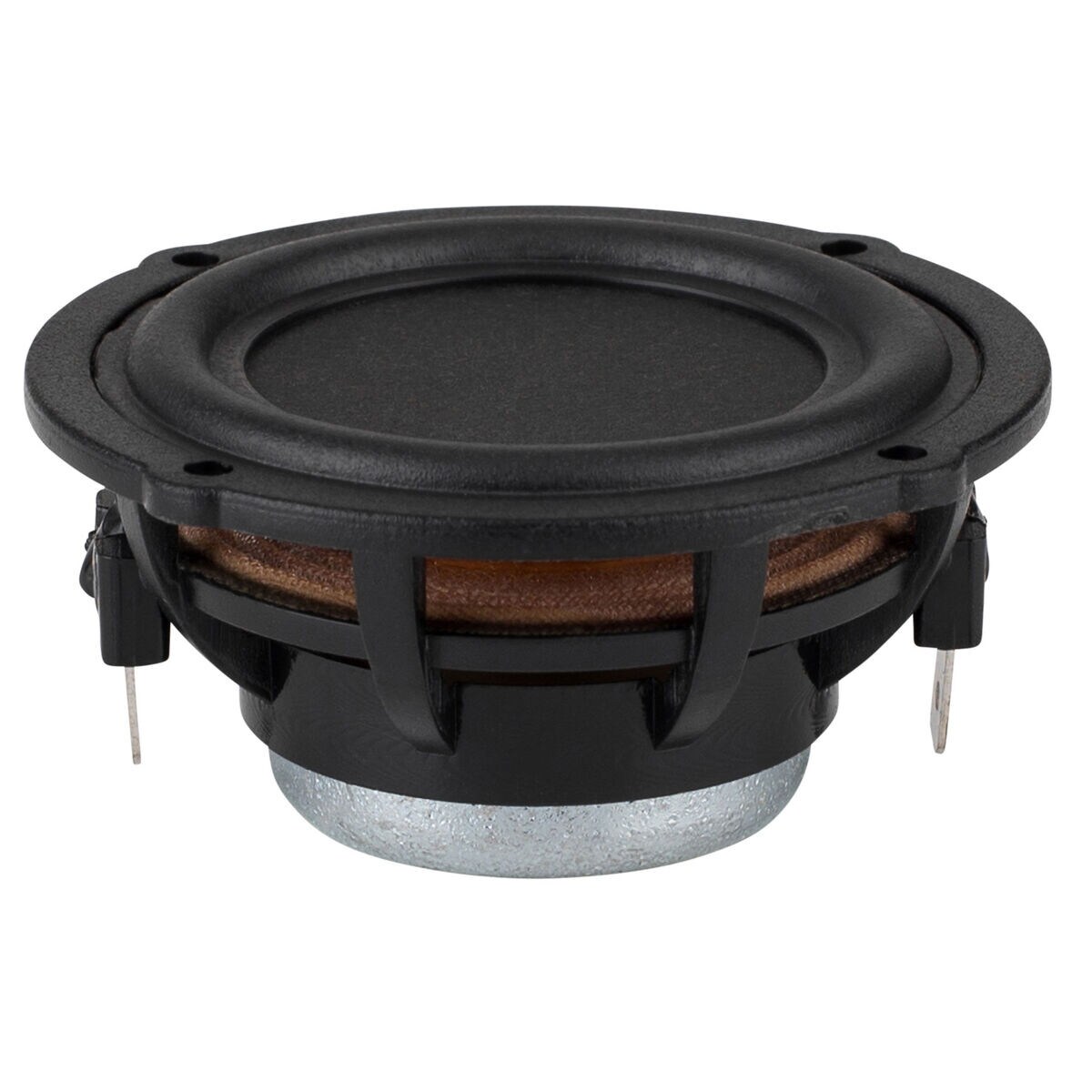

Sorry, a small wideband to take the place of a cheap tweeter.
I have no experience with widebands, but from what I've read, that definitely can be an option.
It’s generally agreed upon that it’s the better compromise in an active 2 way. This 2” has been praised and there’s a favorable review on it by one of our resident street legends erin h.
