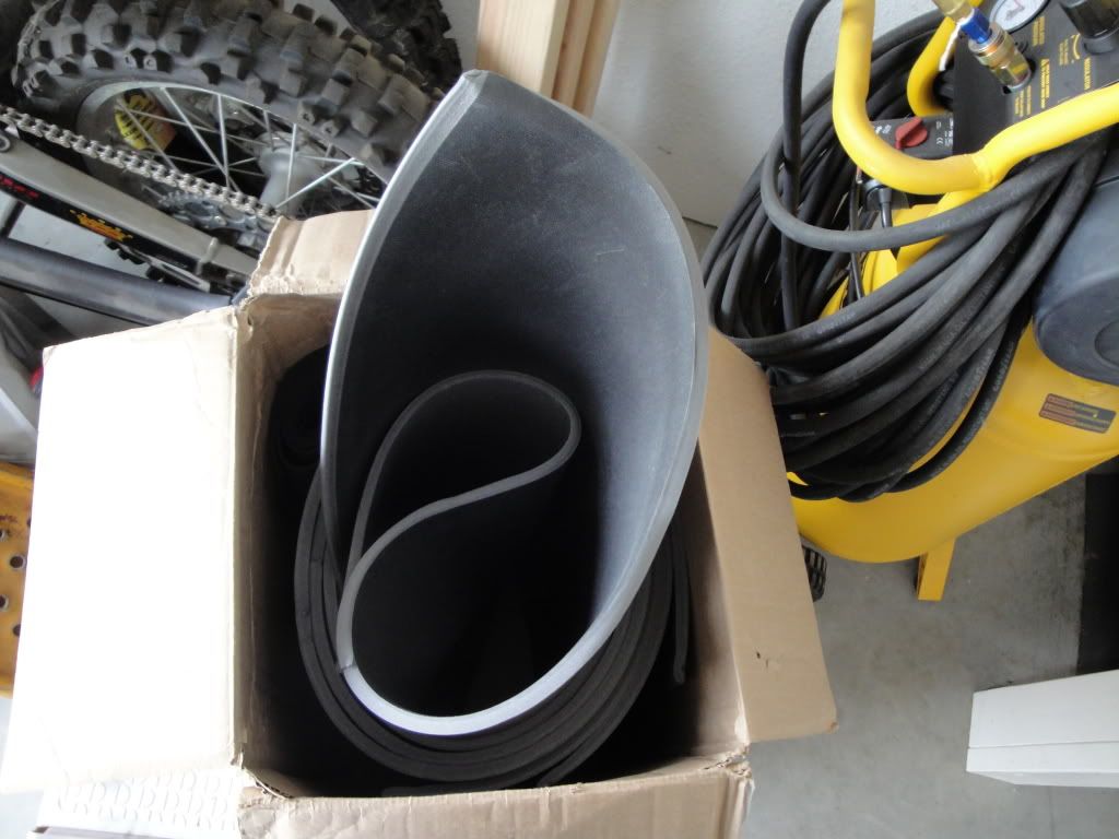

36 Square Feet of Luxury Liner Pro
9 Square Feet of Overkill
