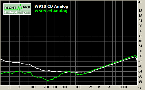

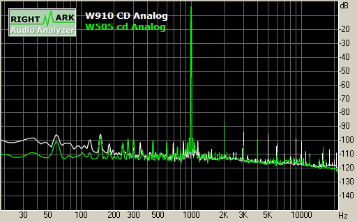

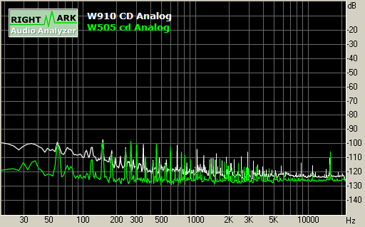

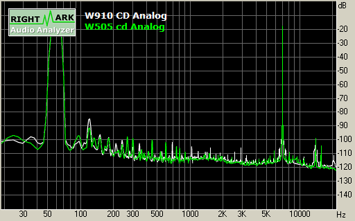

Following along the same methodology of testing that I do with the other test units, I've tested the alpine w505 and w910 units for comparison purposes.
Here are other tests:
http://www.diymobileaudio.com/forum/bikinpunks-product-review-forum/107814-pioneer-p99rs-pioneer-deh-p9-pioneer-800prs-testing.html
http://www.diymobileaudio.com/forum/bikinpunks-product-review-forum/105710-alpine-h800-vs-h701-vs-audison-bitone-1-technical-comparison.html
I tested the CD source and the ipod source and plotted the results of each source between the decks.
The test was done with a power supply in line. Signal from cd and ipod routed directly in to my m-audio audiophile 2496 sound card RCA inputs on my PC via the headunit's "Front" RCA outputs.
iPod file was .wav format (lossless).
CD as Source:
Summary:
FR:
Cross-Talk:
Dynamic Range:
THD:
IMD:
Noise:

Wow! With all the hype associated with the 910 I expected it to whip the 505's butt.
THe CD section on the 505 is nice. The IPOD seems pretty good but I would rate it a push.
It looks like the used 505s just got an increase in resale value.
me, too. the lack in resolution over the previous alpine unit is about 70% of the reason I'm sending it back. the other 30% is that the h800 flopped on me and without that, the 70% of the reason for getting rid of it became 100%.
It was most certainly a surprise given the fact that we were told here on the forum that the w910 was built with SQ in mind. Well, it may have a few crossover and t/a features, but the internals don't measure any better than the w505.... surprise, surprise.
