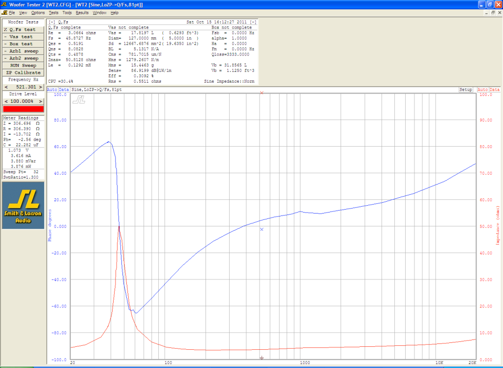

T/S and Impedance:
  • Re = 3.0664 ohms
  • Fs = 45.8727 Hz
  • Zmax = 50.8128 ohms
  • Qes = 0.5191
  • Qms = 8.0828
  • Qts = 0.4878
  • Le = 0.1292 mH (at 1 kHz)
  • Diam = 127.0000 mm ( 5.0000 in )
  • Sd =12667.6876 mm^2( 19.6350 in^2)
  • Vas = 17.8197 L ( 0.6293 ft^3)
  • BL = 5.1317 N/A
  • Mms = 15.4463 g
  • Cms = 781.7015 uM/N
  • Kms = 1279.2607 N/M
  • Rms = 0.5511 R mechanical
  • Efficiency = 0.3114 %
  • Sensitivity= 86.9507 dB @1W/1m
  • Sensitivity= 91.1153 dB @2.83Vrms/1m

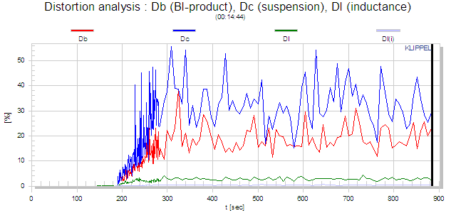

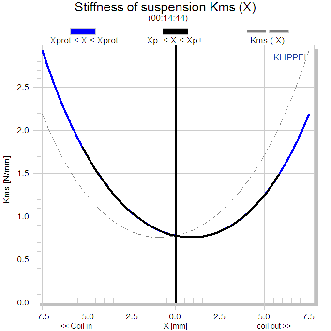

Klippel Distortion Parameters:
  • X Bl @ Bl min=82% 4.4 mm
  • X C @ C min=75% 2.4 mm
Sample Klippel Data:

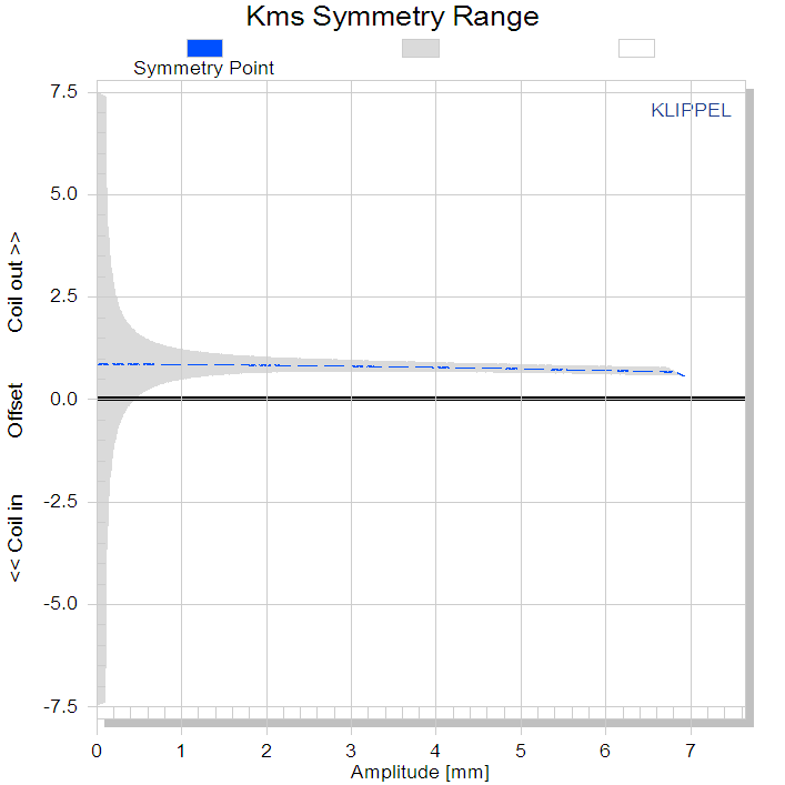

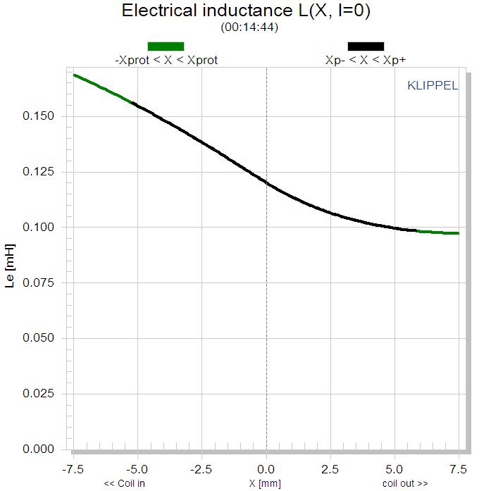

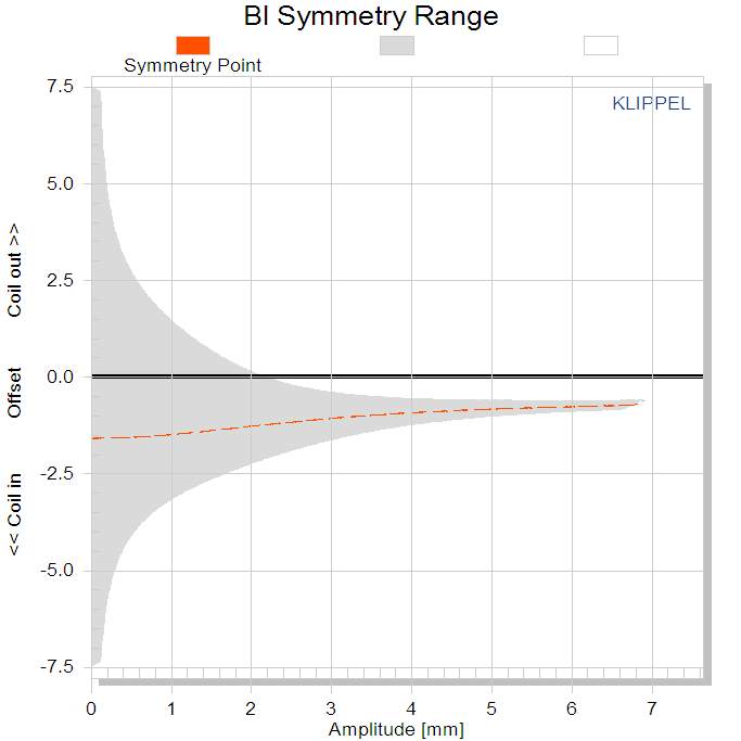

Yes, and the offset differences are what drives that. The 4" has less offset in both K and Bl than the 6". Therefore, the % of those parameters is reached quicker on the 6" version.

The information is all there. The SB reached a thermal temperature of 18k while the Arc got to 24k. Once you account for the excursion differences between the tests the thermal capabilities look the same. There is an overwhelming amount of similarities between the two.
