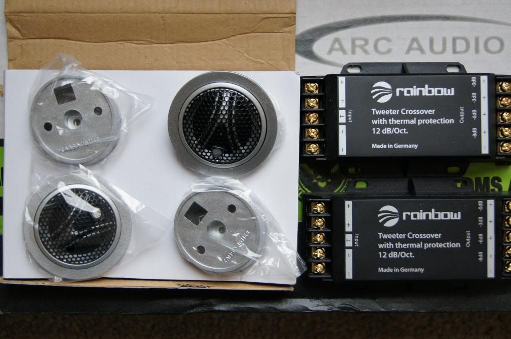

Rainbow Cal 25 Silk with crossover

Are you going to use the Rainbow or HAT crossovers? - Curious why you bought both.

For the tweeters I have currently installed the Rainbow tweeters and crossovers. Nelson sent me these tweeters when I just moved to a new place and the USPS guys lost this package. That's when Guy (sound suggestions) sent the L1 pro's with the Arc amp as a Christmas present. They Delivered the package to my house few weeks later. I haven't tried the L1's yet.Rainbow sounds pretty good so far.
