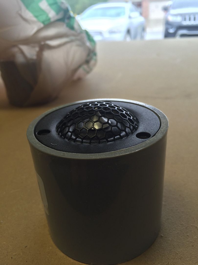

Made some tweeter pods that will get glassed into the sail panels. The tweeter is almost the same size as the panel itself so they needed to be low pro as possible. but, for aesthetic purposes, flush mounting is a must.
Turned to the trusty ol PVC couplers since I didn't have hole saws that were the diameter I wanted.
They didn't fit so I had to route the edges a tad so the tweeter would sit flush
And like magic...
Then I used the closest hole saw I had and sanded the crap out them to fit in the coupler so the tweeter will have something to mount to.
And like magic...

I cut the pvc couplers down to about .5" deep. I'm just gonna glass them onto the panel, similar to my RAM.

Admittedly, I have done some very sketchy shit with a router in my days. In my old age I'm learning value my fingers and finding ways to work smarter so these rings weren't very dangerous.
Whip out the trusty $99 router and table combo I got 4 years ago...
Adjust so the coupler doesn't move too much...
Spin the coupler. Shaved just a bit off at a time u til I got the width I needed. Fingers stay out of harm way.

That's a great idea with the router and pvc... I usually spend 18 weeks looking for the right diameter and then cry when I can't find it.
I used to do that but I got tired of looks I would get from people when I was walking around lowes trying to jam a little speaker into random things. Had to learn to improvise a bit. Lol
