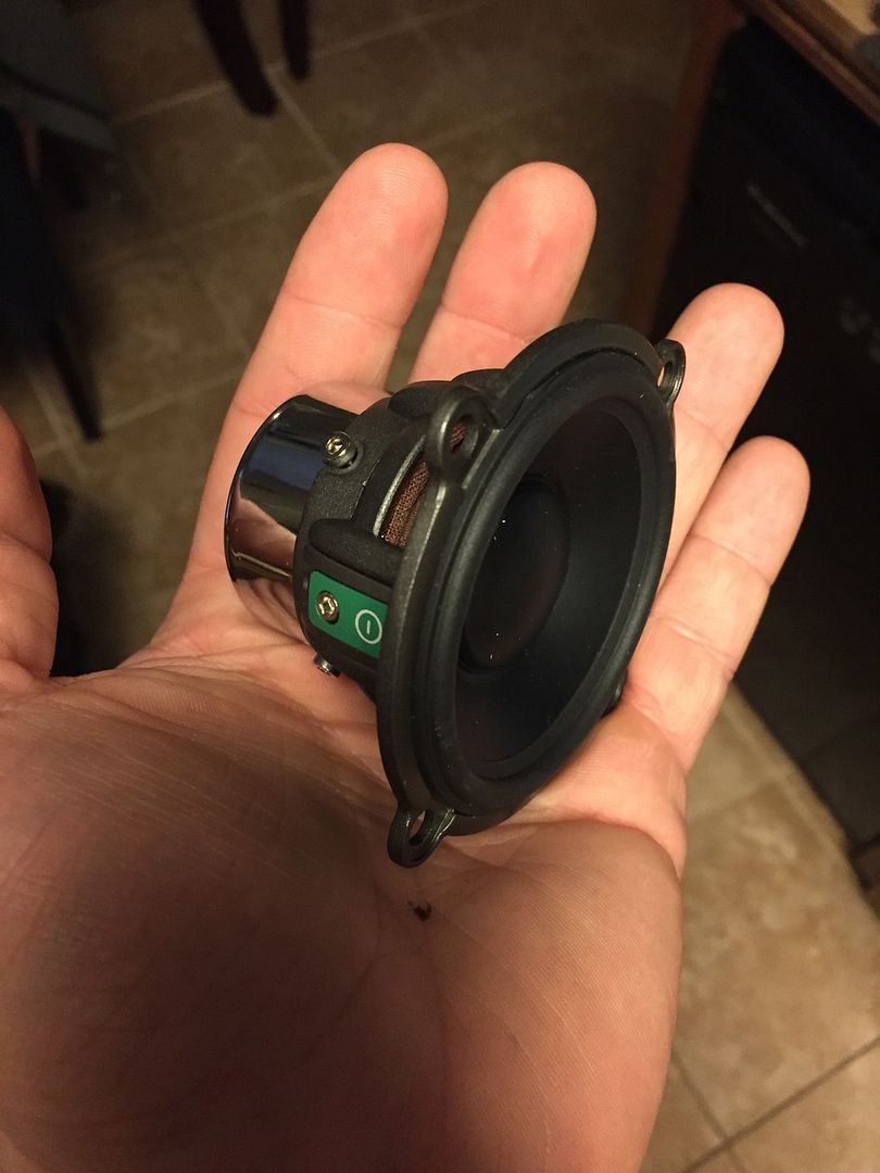

I also got these lil cuties in yesterday. Audiofrog GB25. They will go in the pillars. I ditched the scan tweeters for a set of Audiofrog GB10. These should be in today and will go in the sail panels.

I'm anxious to hear your thoughts on the gb25. I've seen it in a few other threads and about to pull the trigger on a set myself.
Yea can't wait to hear them either. May have to throw them in my desk top setup at work. May be a little while before I get them into the jeep.

I got the GB10s in yesterday also.
I may be able to fit them into the factory sail panels without much modification, which would be badass
Did a quick text on my desktop setup at work and they sound very nice and detailed. I'm hoping this weekend I'll be able to get the door panels off, run wires in there, add the ccf and MLV and splice the wires into the factory amp. Not sure I'll have the time tho.
