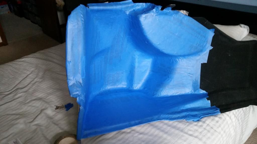

So here it is, I have started working on the sub box, I had to tape everything up (this is my backup mold carpet that i bought) and after I did my taping, i have apply aluminium foil over it. PTA~!!!
Plan on having a good output out of it, with Illusion Audio C12XL sub.
Got that done over the weekend.
So this is here i stand with my box build, I need to get some fiberglass stuff and sub ring and ill be good to go.

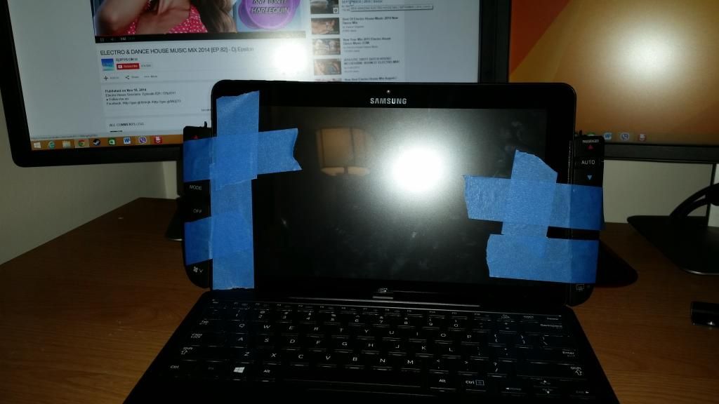

As some of you have seen my build with 11.6" Samsung tablet, well TL wont be any different, the only thing is, I will be doing some fabrication work and modding my controls and moving them over. Here is what I have came up with and I'm sticking to it.
First I have tried to put the controls on top of the lcd, but it looked so bad, I even took it to my car to see how its going to turn out and did not like it at all. here is a pic.
I have decided to see how its going to look if there will be enough of space for me to put the controllers on the side of each other vs being on the tablet or any other location and i think I hit the jack pot!
It was rock on, after doing some fast fitment, I will be able to put the cables where they being (they will be extended) but other than that, it will look awesome.. So time for cutting!

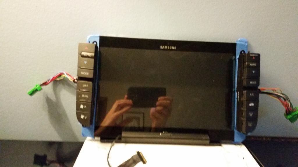

I marked down with the tape and cut out the controllers from one OEM HU displays that I have.
I have cut out the controllers with the plastic trim around them, after that i did quick sanding and it turned out great!
After getting the idea to put them on the side, I have decided to do some extra measurements and fitment and it turned out really cool I cant wait to fabricate everything.
side view for measurements and see how is going to look just to get an idea.

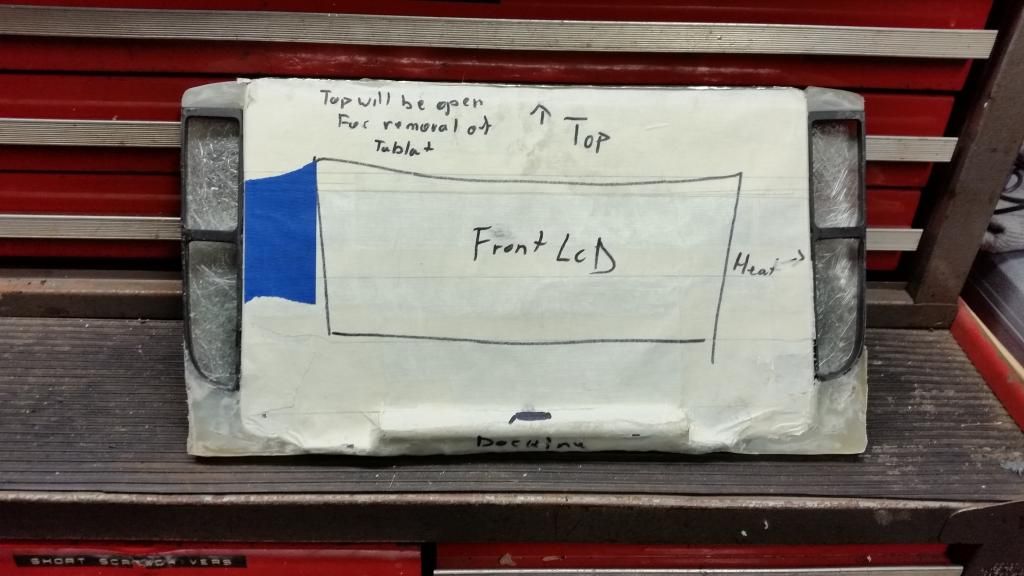

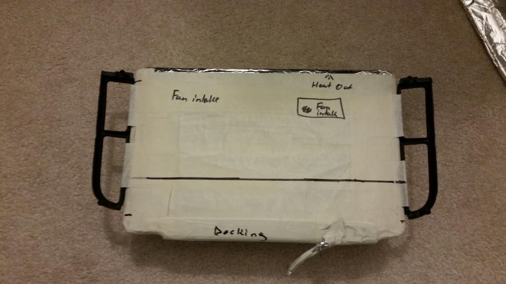

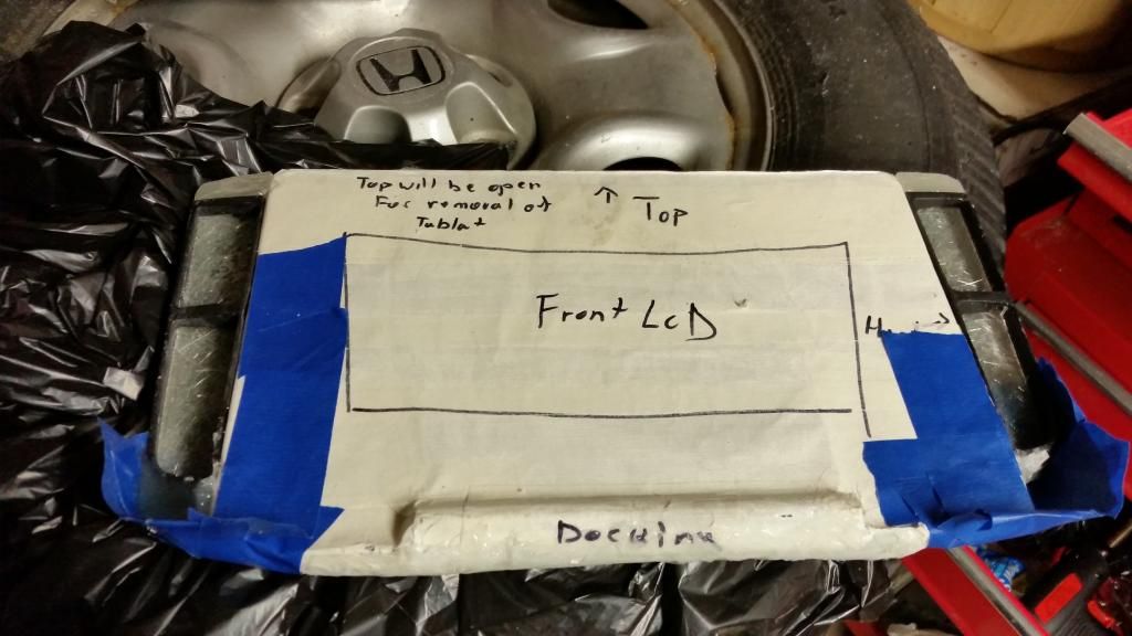

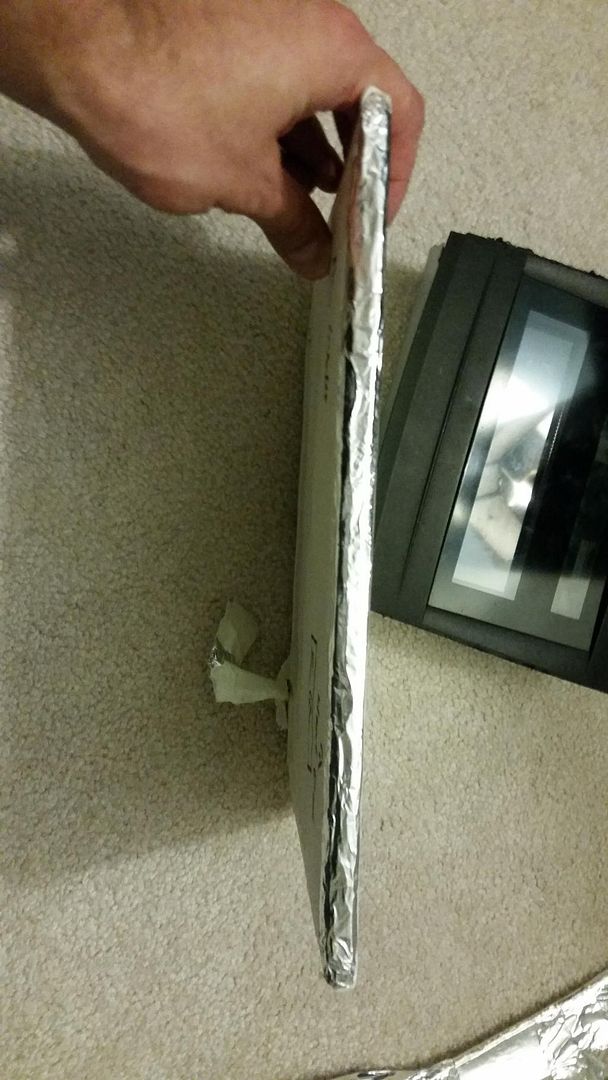

After getting that idea, I didn't wait any longer, I have wrapped my Samsung tablet in Aluminum foil and some tape to have it ready for fab work and glassing.
This tablet will be movable from my car, so it will slide through the top so i'm leaving that open and there will be no glass adding on to it...
Final progress after measurements and fitment:
Front:
Back:

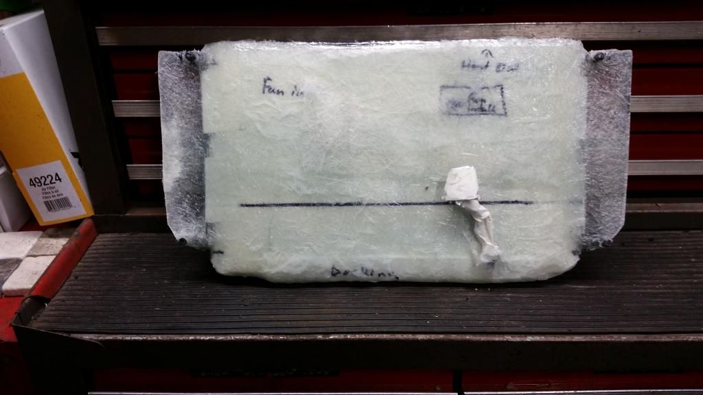

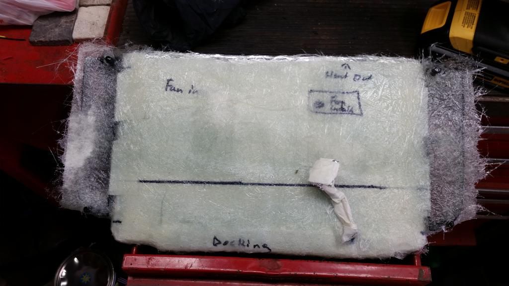

I had a some what productive day,

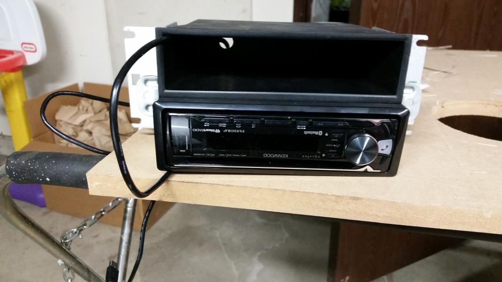

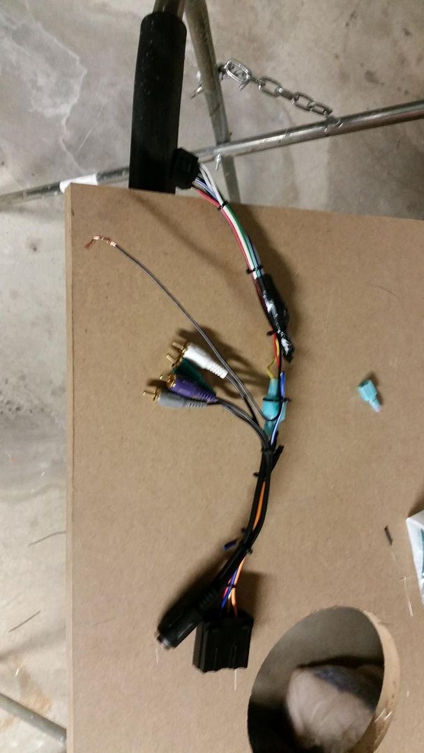

1st, I bought a Kenwood head unit for my GF car for her B-Day and I told her that I will install it after work, It took me about 20 min to get everything ready and test to make sure everything works before putting the HU unit in.

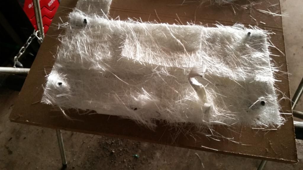

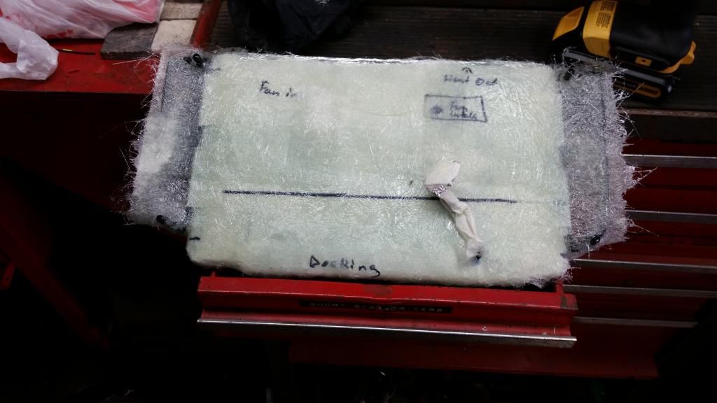

2nd. I started working on my tablet, managed to put 1 coat of fiberglass on the back of it, and also started making some side corners under the controllers, I had no idea of how to get that done, but i came up with some conclusion, its not perfect, still lots of work to be done, but at least its a start.
1~ Hu Install pics
I hate using electric tape, but i had to, she has a older Eclipse and infinity system, so I had to get wire harness with RCA plugin to factory amp. Kenwood pre-output for speakers wasn't in use, so I had to cover them up, that's the only thing that was taped up. and some unused wires so there isn't any spark behind the unit.
Made a hole in the back for USB wire in the bottom tray.
HU Installed

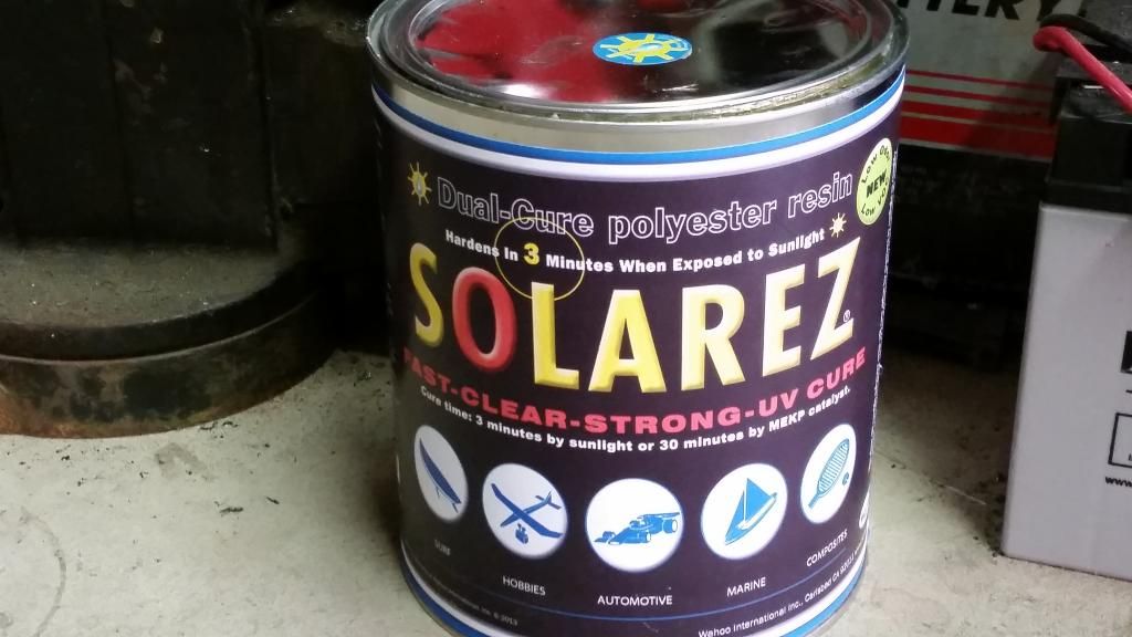

Prep work before glassing:
It was a nice day, sun came out, so i was in a rush to get that done, since Solarez resin needs uv to cure.
Test Fit
It took 5 min to cure
Made it Celan

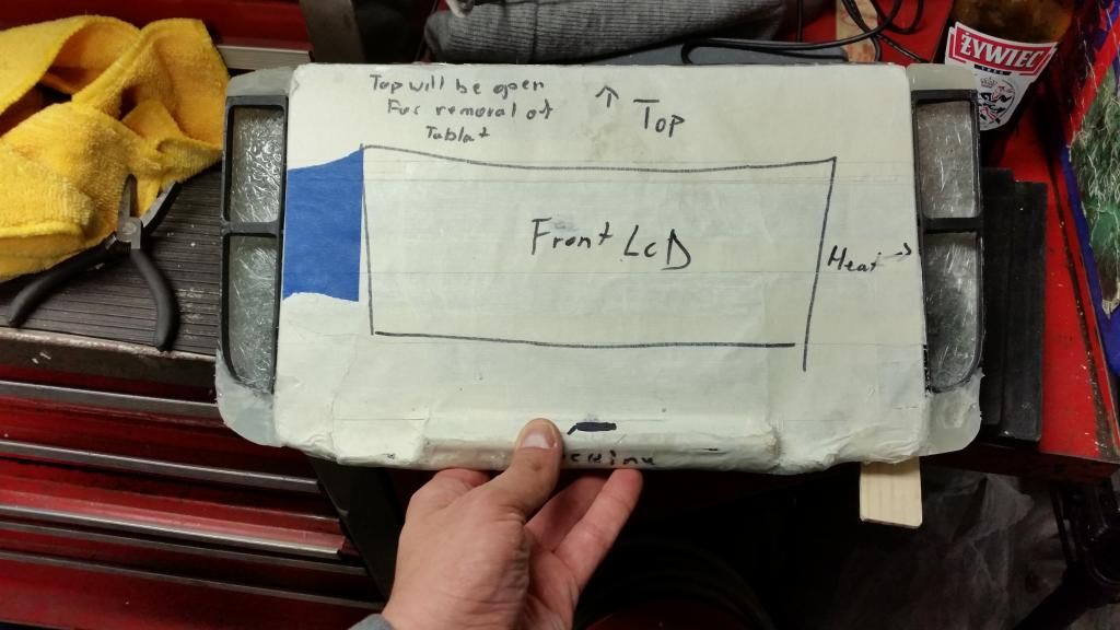

At night i decided not to go out or do anything crazy, and just work on the tablet and see where i will get with it. I wanted to fill in the gaps on top left and right side and also create some kind of better look or more filling round shape towards the bottom of the tablet.
I used hot glue, made the shape and than simply shoot hot glue in to the empty spots or shapes that i have made, I know they are not perfect, I don't have all the tools in the world and also it was late, so I didn't want to make too much noise since i live in a condo.
More to come, more filling to-do before adding more glass in the front, and make a better shape, this was a test and it turned out ok,,, but i'm not happy with it.
Than i started playing with it some more, tomorrow i will create a round shape if everything goes well.
More to come!
