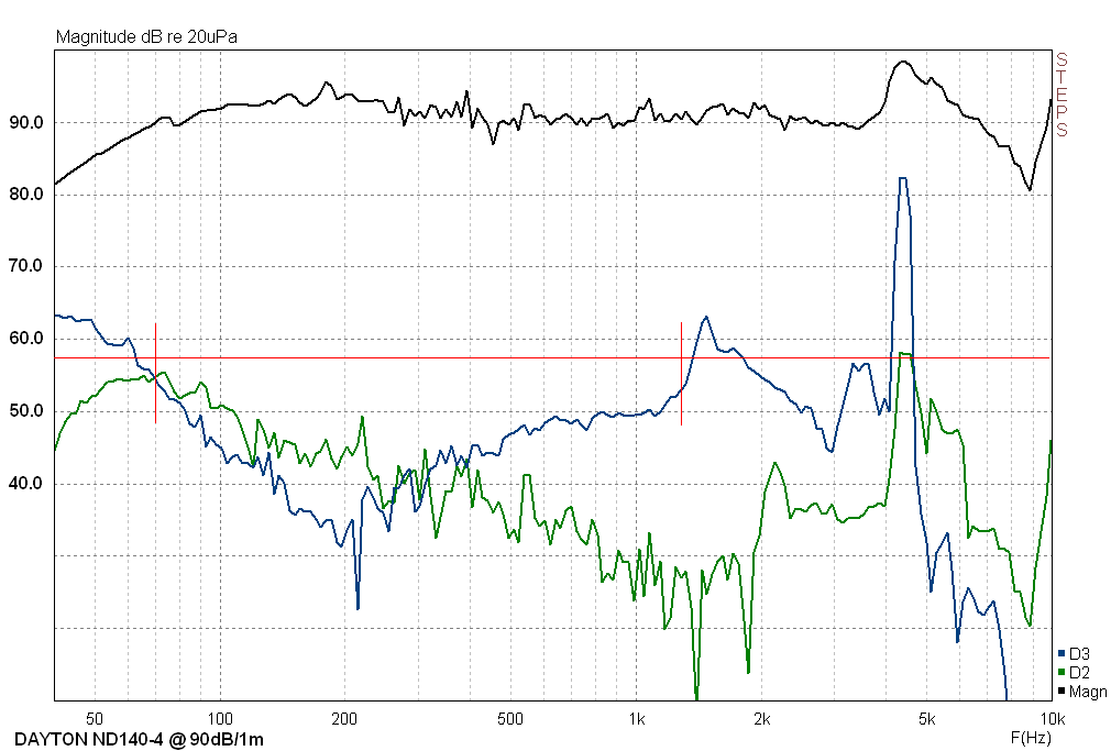

A great neo mid-bass driver, for the price. High 3rd order HD in the midrange due to the cone breakup limits its usage. The small magnet is great for tight installs.

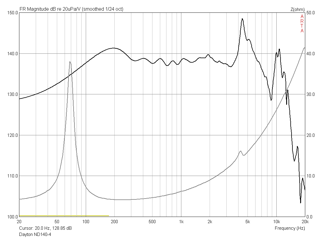

Nearfield FR & Impedance
Frequency Response

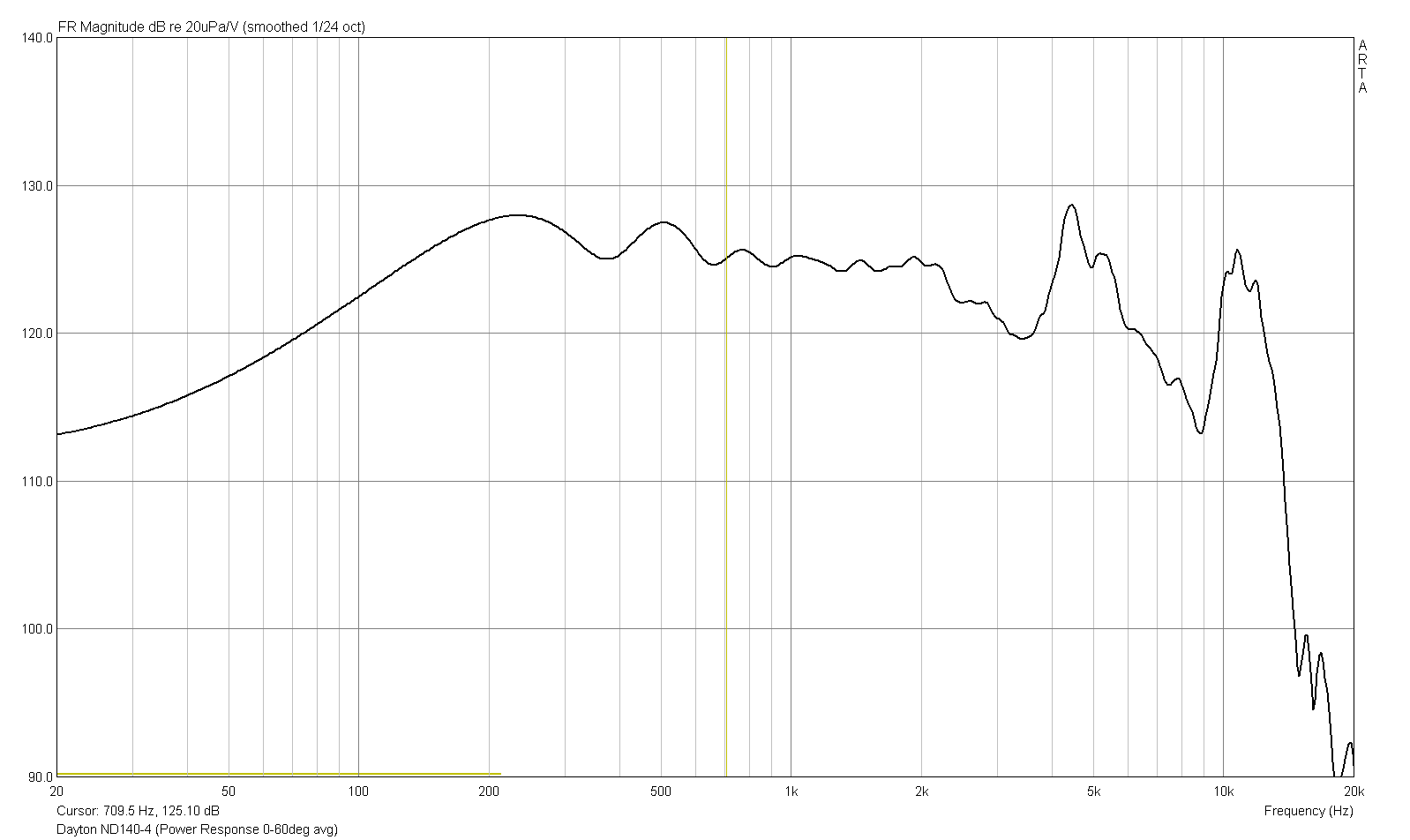

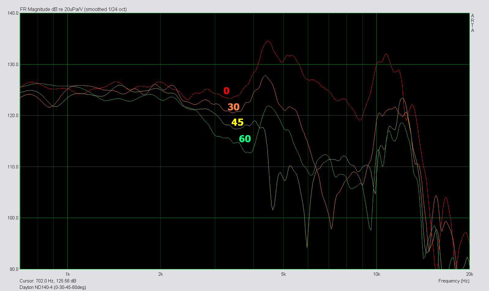

Power Response

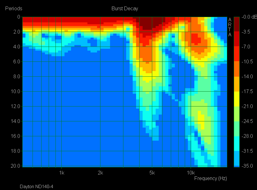

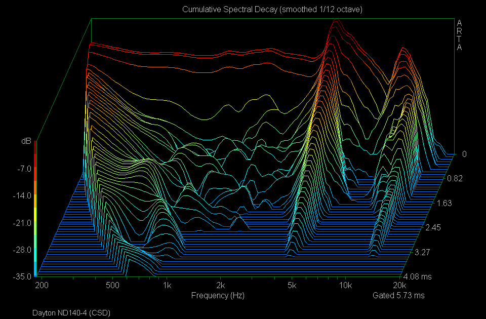

CSD & Burst Decay

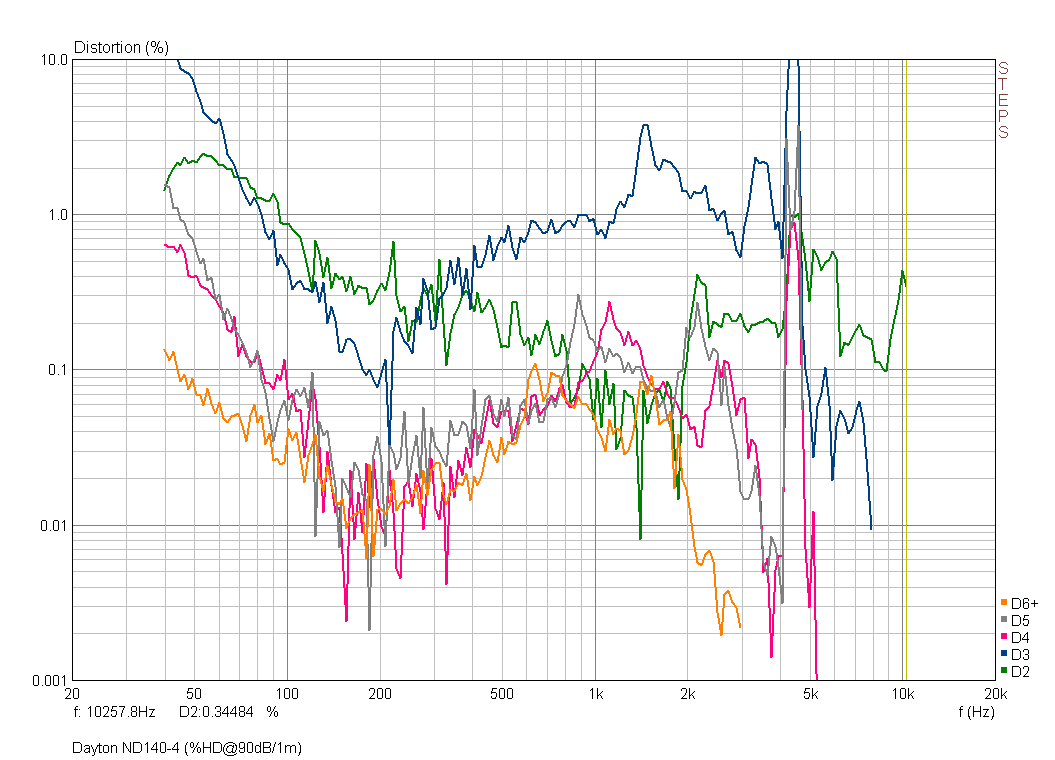

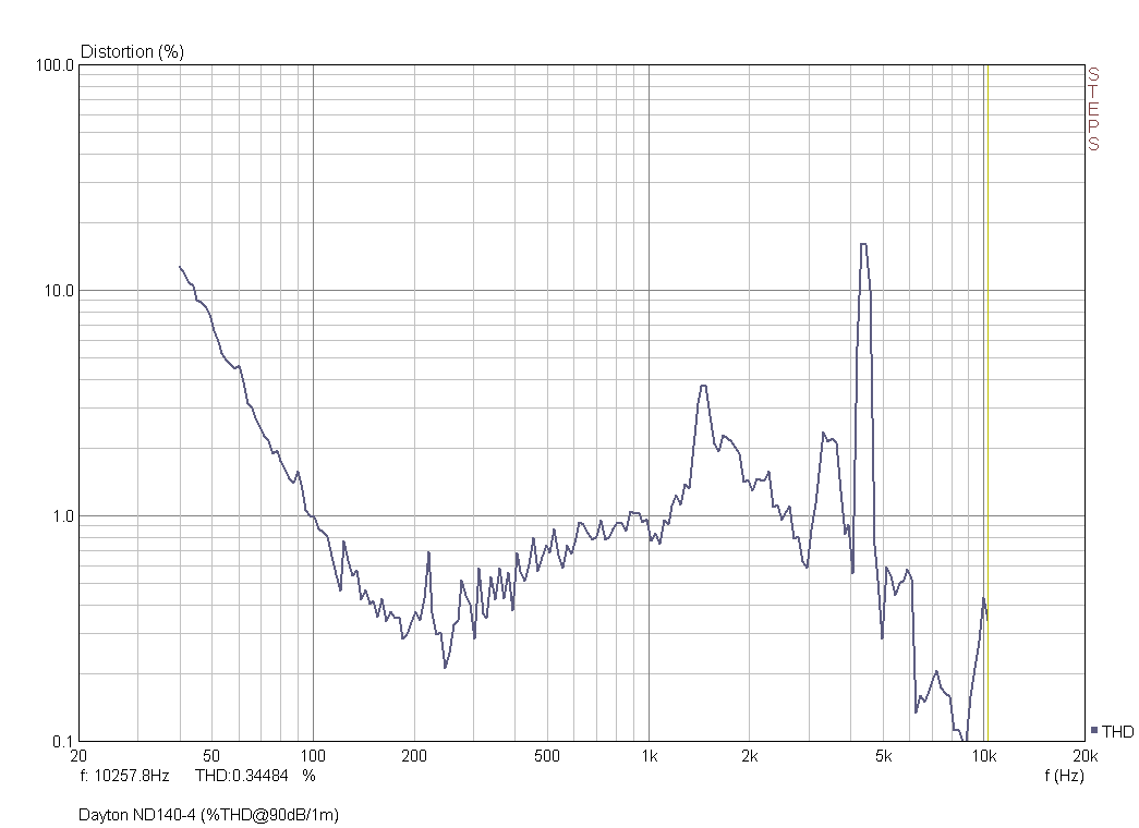

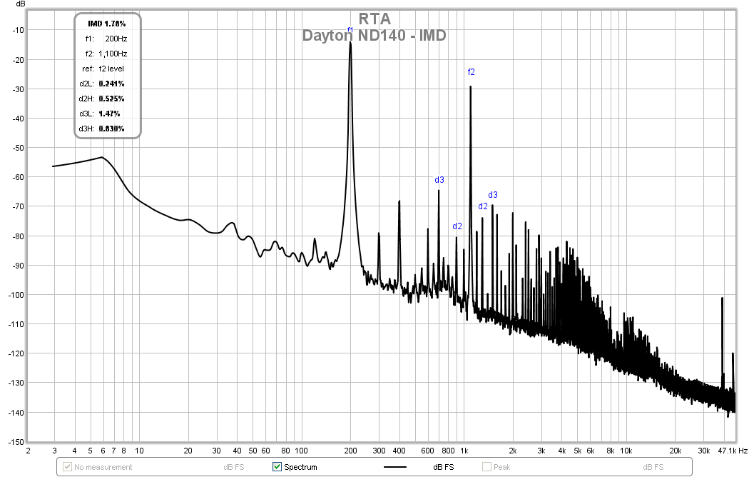

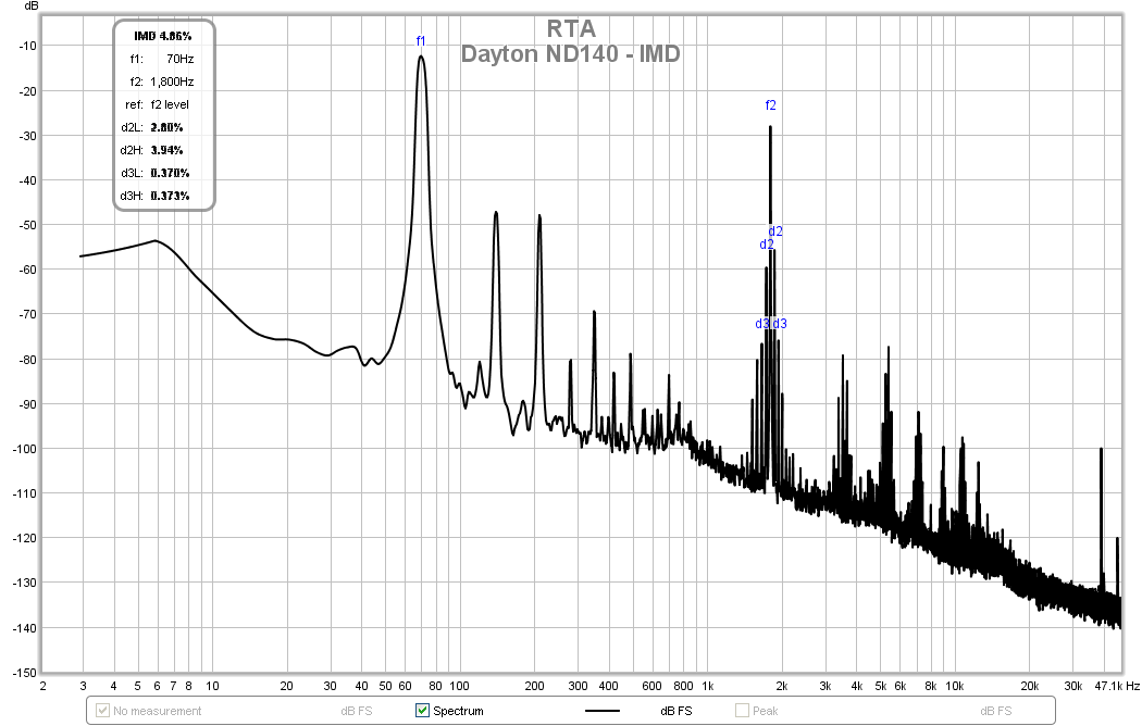

Non-linear Distortion (90dB/1m equivalent)

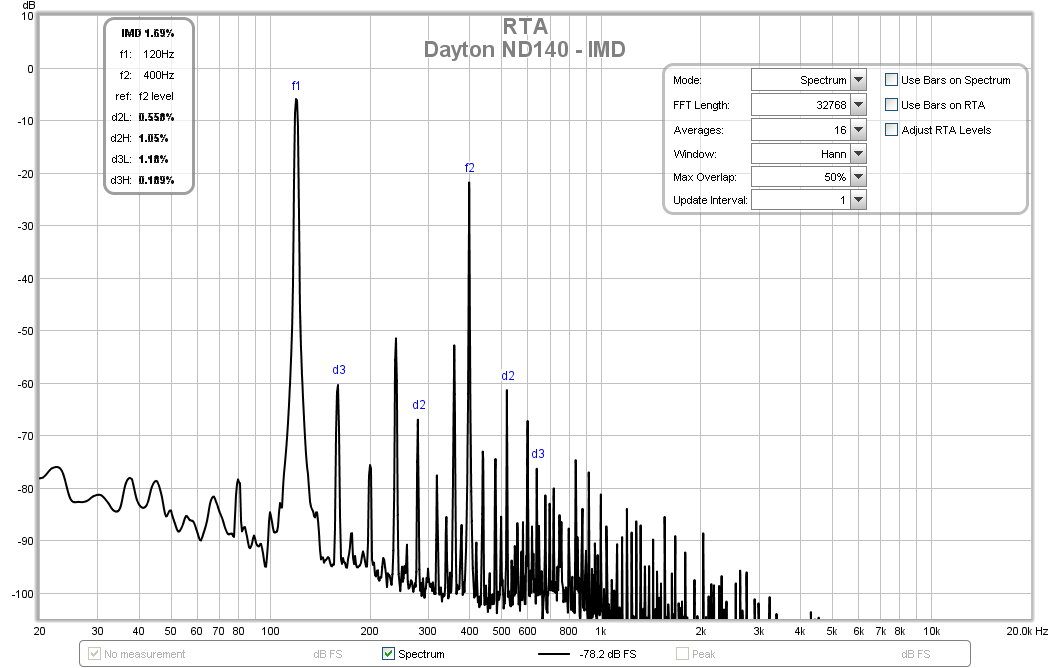

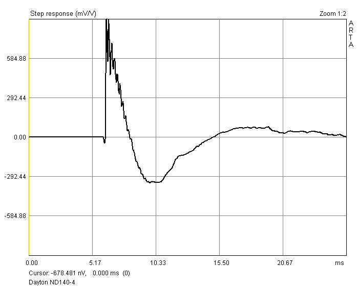

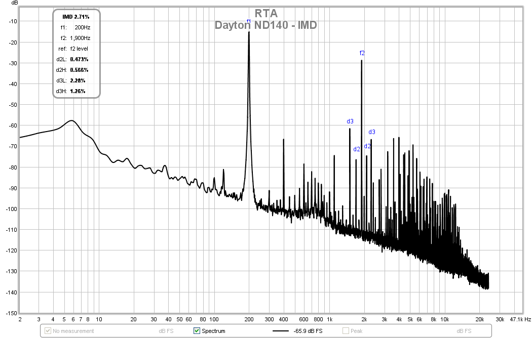

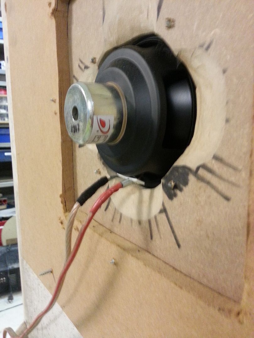

Optimal range; 80-1200Hz with steep slopes both ways. Good power response up till ~2500Hz if you can accept some distortion. Best used in 3-way front applications, very clean in the lower midrange. High Q and reasonable low Fs for its size will give you decent output in the midbass region with decent efficiency. Use it in sealed or in "IB" alignments.

Amp; Onkyo D1 2ch
Mic; Calibrated ECM8000
Preamp; Scarlett 2i2
Software; aRTA and REW
Baffle; 120x240cm
Soundcard has been calibrated with the 5m mic cable in place.
Response is gated, mic is 100cm above the floor so about ~200cm can be gated out as reflection free. The low rolloff has been bafflestep compensated, but some ripple still remain. For accurate LF response use T/S parameters to model it.
Distortion measurements are done in semi nearfield to avoid too much of the room to show up.
