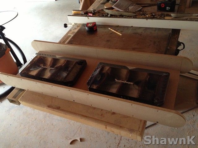

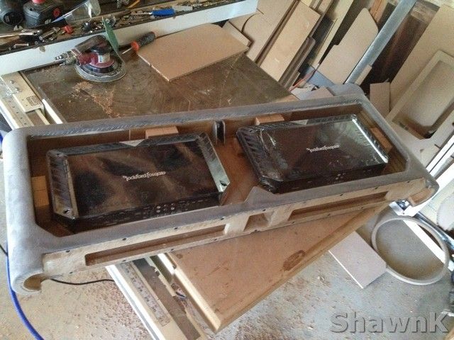

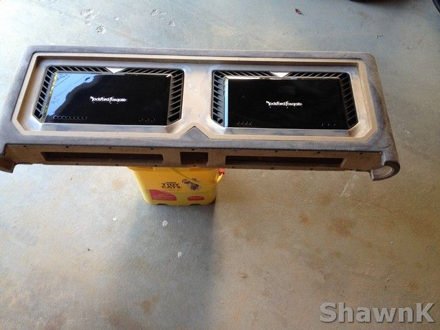

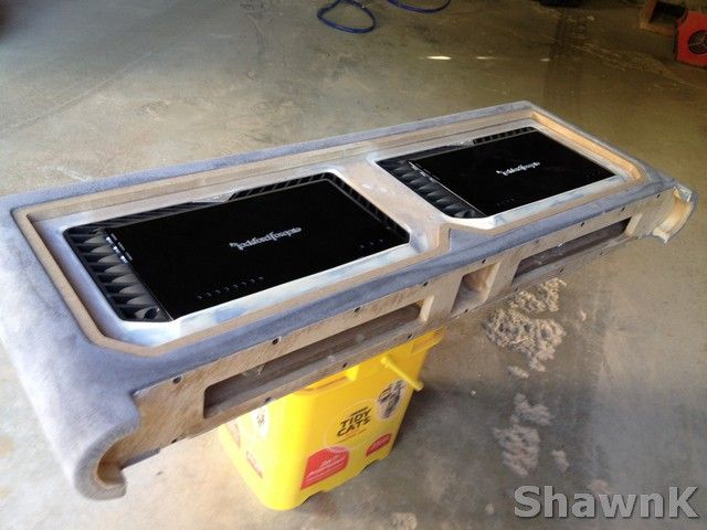

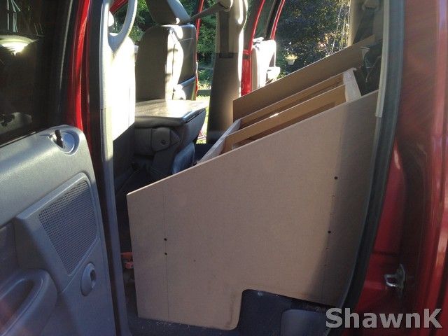

Just finished this one. The owner has been a great client of mine for over a decade now. The job went way over budget, but it's all good especially considering he's a veteran and I respect that greatly!
On to the pics!

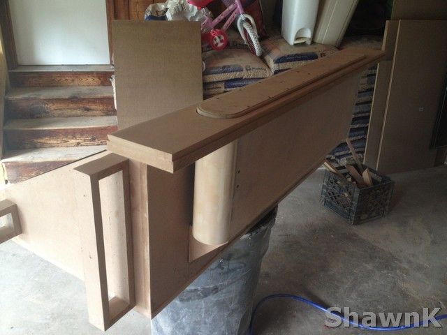

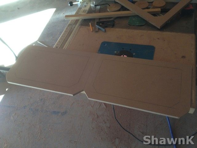

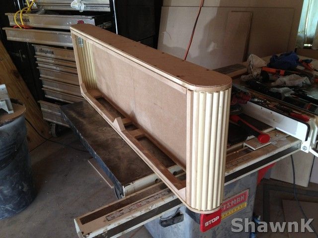

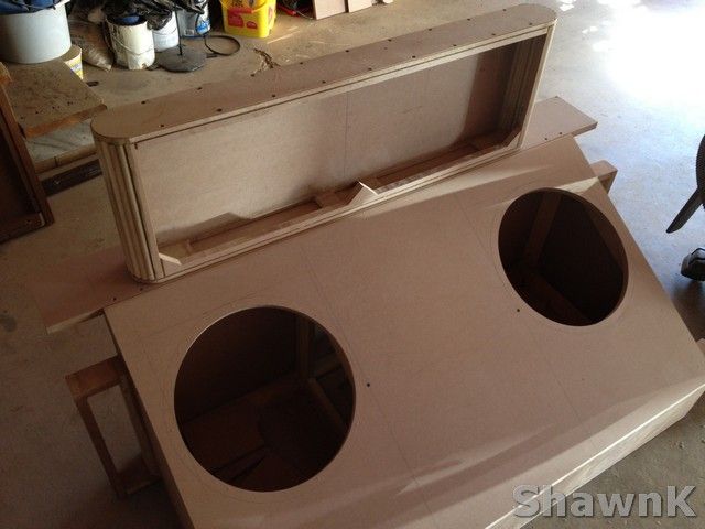

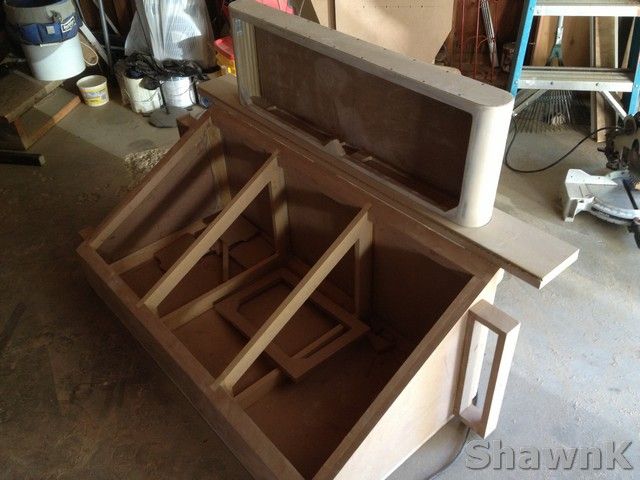

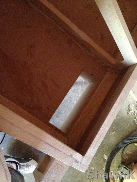

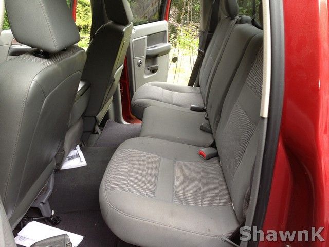

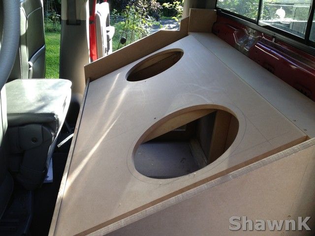

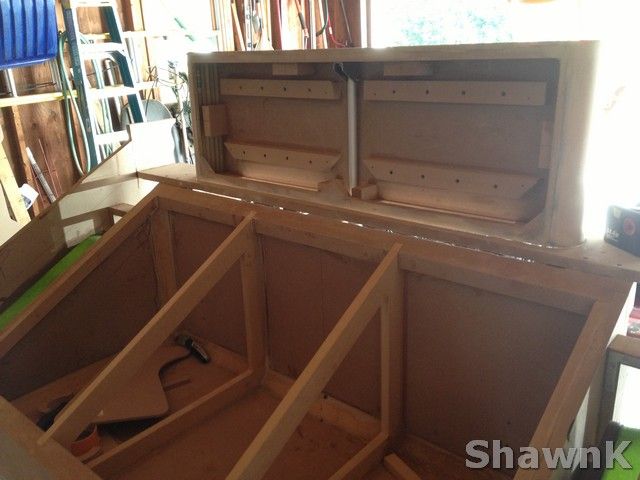

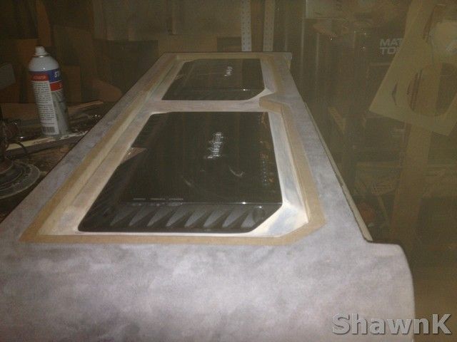

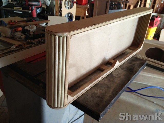

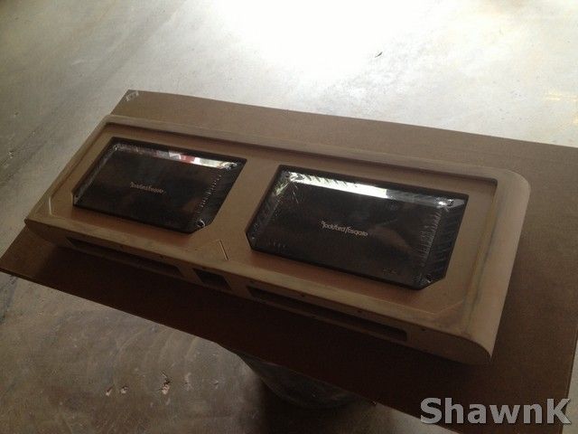

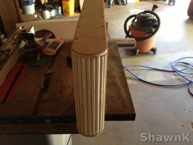

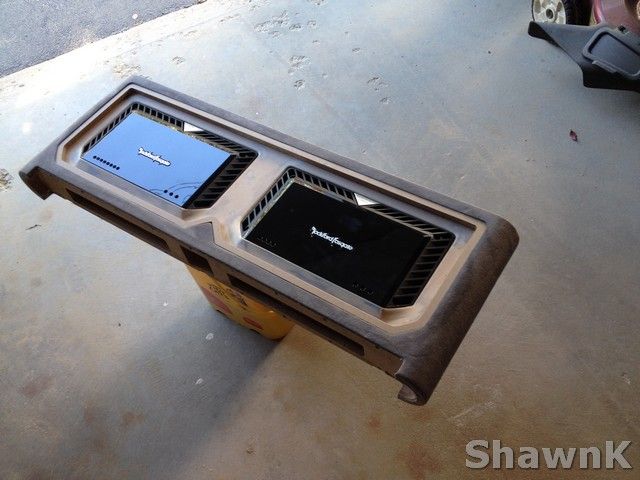

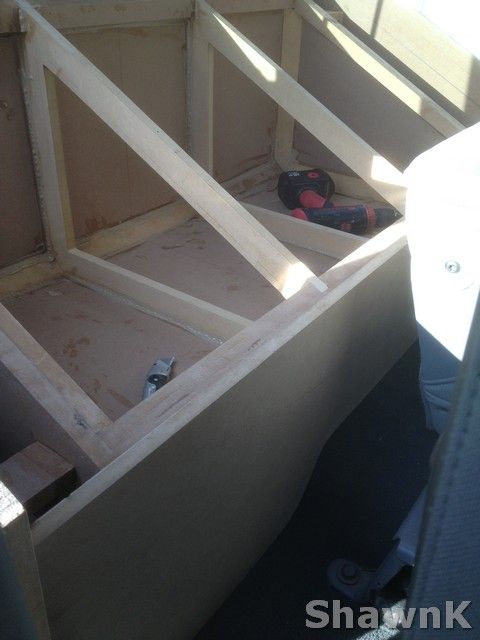

The owner gave me permission to completely remove the rear seats in favor for some BIG BASS I removed the middle sealt belt bracket via drilling so it can be welded back into place if ever needed.

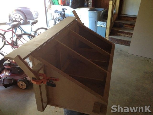

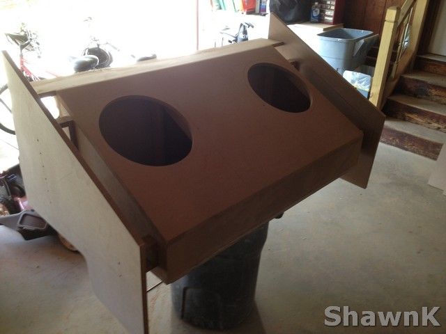

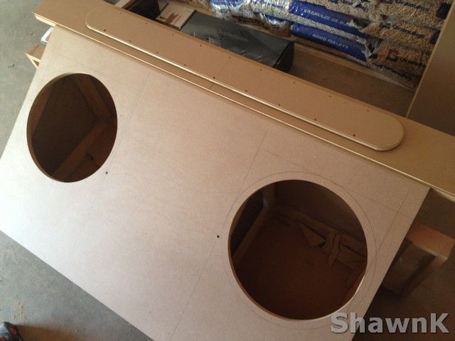

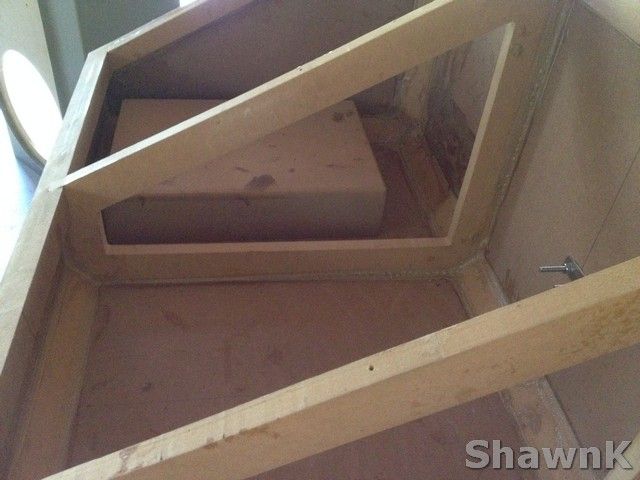

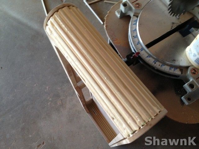

Then it was time to start on the large vented enclosure for the two custom built 15" subs:

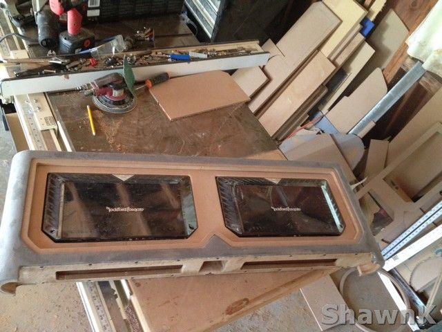

Pics? Pics? We want VIDEO!!!!! Amp rack, Amp rack, amp rack (everyone join me..)..
haha.. looking good, can't wait to see that thing moving!!
Ha! Thanks! I'll get a video of it for sure. I just couldn't stay awake any longer last night lol.
