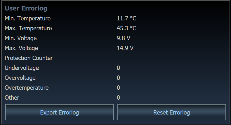

It looks like Arc Audio PS8/12/16-PRO workflow from left to right.
And like Arc Audio, it now have datalogger.
Other than that, I don't see anything new.

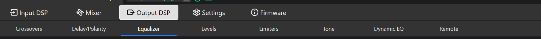

as for high pass and low pass, ensure channel filter target has a cross in it like so…
but I can’t make it work in my pc in demo mode, I’ll drop the guys a message 👍🏼
