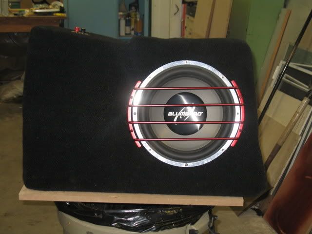

2- Alumapro RX SQ 12" powered by Audison LRX 1.1K in custom FG\MDF boxes

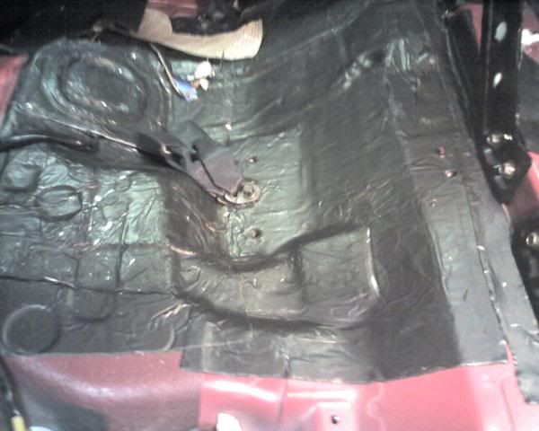

Lots of cascade VBmax and VB1 liquid sound deadener (the best)

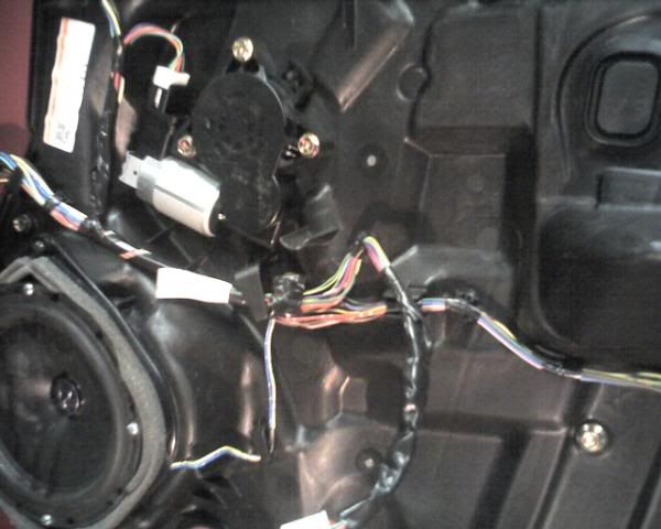

Karma SS 12 Gauge Speaker Wire twisted pair running to each speaker. Yes two 12-gauge twisted pair thru molex connectors into each door) How? Wire relocation in molex connectors to make room.
