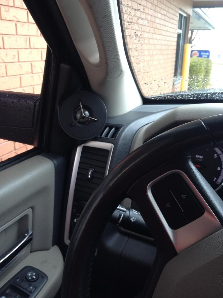

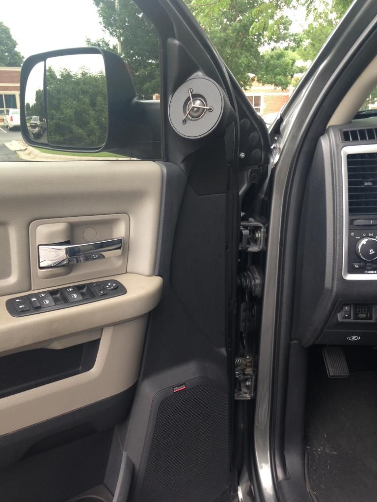

Not the Esotar 110's, but the Dyn T-380. Jerry Niebur made new face plates for me that a little smaller in diameter...opened up a few more options for mounting. These are my sail panels in my Dodge Ram...I don't know how you H3 truck is set up on the interior, but I thought maybe this would help....prob really tough having 110's sit around not being used!!

Yeah that looks NICE! I like the darker emblem-less faceplate so that it kind of hides the tweeter from would-be thieves. I don't have much of a sail panel in my truck, unfortunately.
I am thinking of adapting an MDF baffle to my A-pillars for them and then wrap the whole thing in speaker grill cloth. I am attempting to avoid fiberglass because it is in the 20s-30s in Seattle right now. And if I go with fiberglass, I'd want to add a pod for the mid too.
