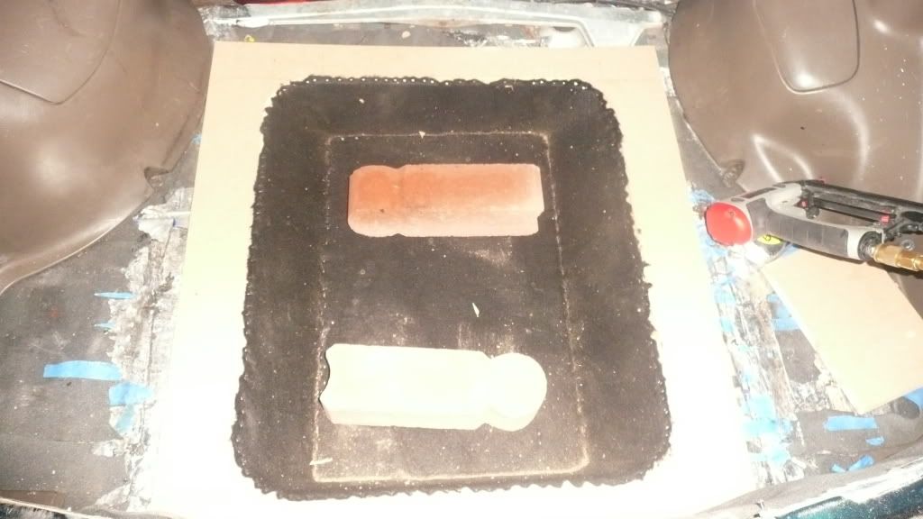

I am in the process of making a fg amp rack and am having concerns. This is right after stapling the fleece

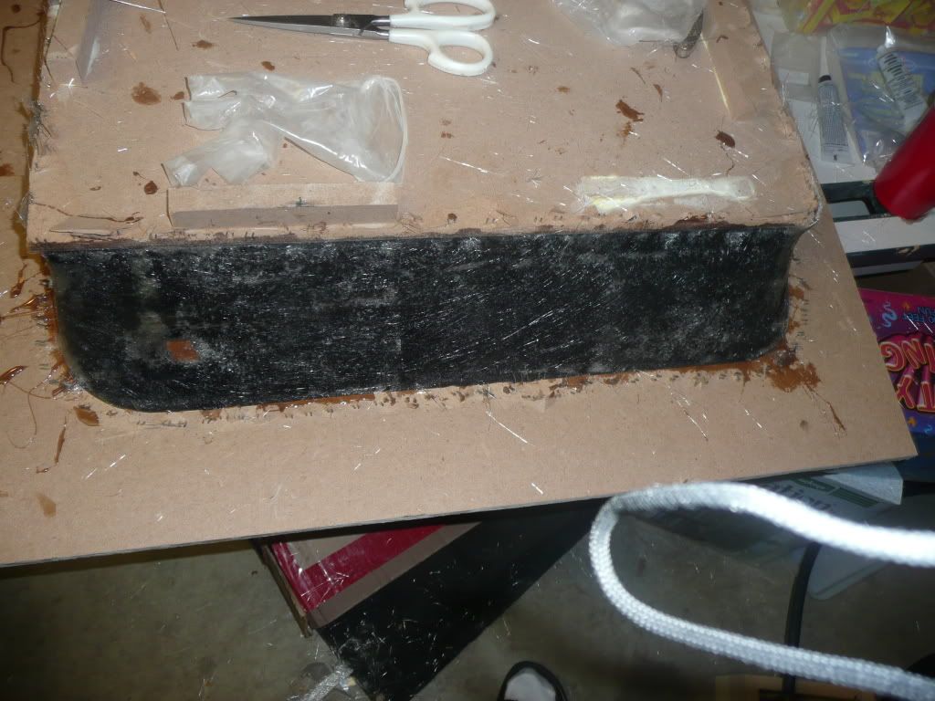

Then I took it out and re-enforced the back with 2 layers of mat( 1 layer in pic)
The problem is that I didnt wrapped the fleece around the bottom like Bing did here
So now I dont know where to go from here as far as if the bottom will be ok like that or if I should some how wrap fleece on the bottom or what. Another issue is with trimming. My plan was to cut out the fleece is the middle so i could just paint the mdf wrap it with something and have less bondo sanding, but I dont know if that possible and i should just coat it with resin sand and filler it?

Nothing wrong with the way you did it. Everyone has their own style and what works for one may not be the best for someone else. I wouldn't worry about cutting the fleece out of the bottom. It doesn't look that deep, so you should be able to cover it in one piece no problem.

What do you mean by cover it? Should I resin the bottom piece, I only put resin on the side walls. I actually just started to sand the inside walls with 60 grit and I noticed that they were far from straight with couple big abnormalities.

This is just for amps right? If so you don't have to build it like a tank. Just strong enough that it doesn't flex when you push on it. The 2-3 layers of mat are plenty.
By covering, I meant finishing it with vinyl,carpet/suede or whatever you had in mind. If you are going to carpet it, stop sanding now and cover it. Unless you have a mountain of a bump the carpet will hide anything else.

As long as the walls are strong just make sure that the visible sections are straight.
I would use some home made Kitty Hair to smooth it and fill in any large gaps or waves.
