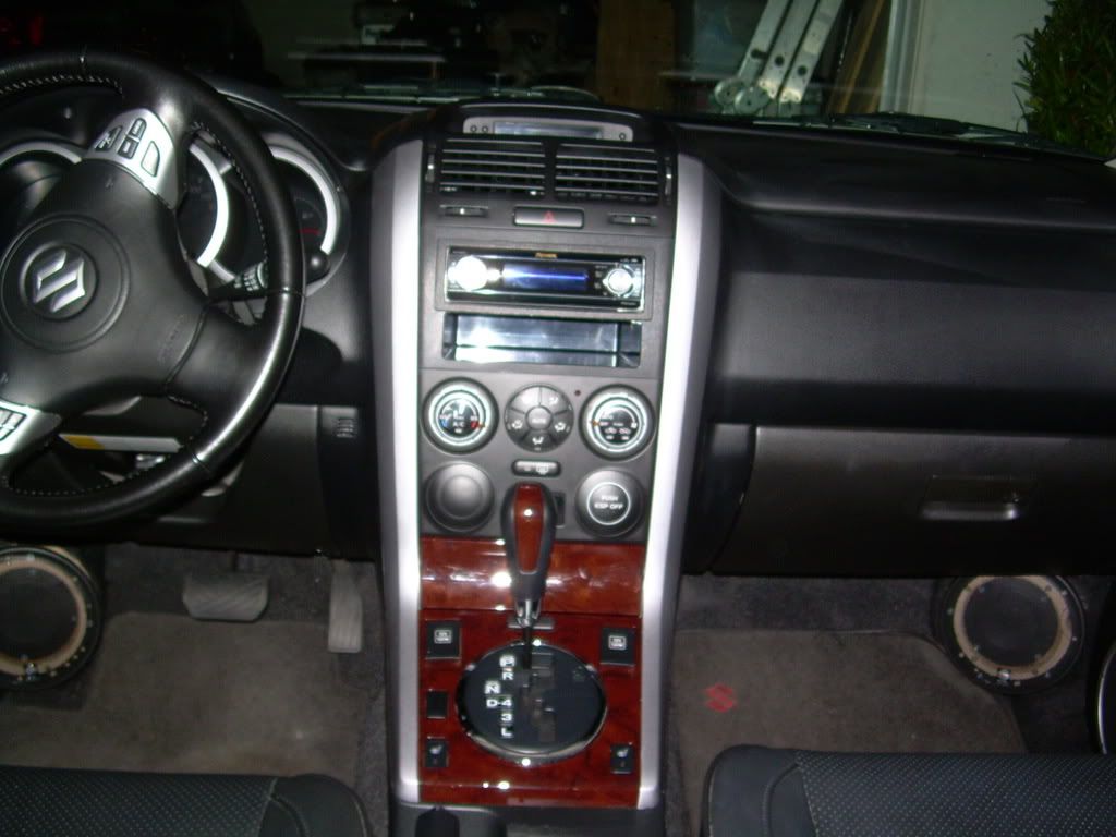

Hello everyone. I posted my build over on caraudio and I was too lazy to post on here as well but now my builds complete so I'll go ahead and post now. I'll start with the equipment that I threw in my car. The Focals I almost got rid of because I didn't think they handled enough power but it turns out my PPI amp had a bad xover and was just letting all the lows through. Now they seem to hit very clean and can handle a ton of power.
Old setup vs. New
Pioneer 800PRS --- W200/H701 combo w/ C701 controller
Eclipse XA4000 --- PPI PC4800.2
Eclipse EA4100 --- PPI PC2400.2
Stetsom 2k6d --- PPI PC 21400.2
No Rear Fill ---- PPI PC2200.2 (amp is mounted but haven't decided on rear fill yet)
TBI HDSS ---- TBI HDSS
Hybrid Audio L4's ---- Hybrid Audio L4's
Tang Band 6 1/2" Subs --- Focal Reference 8's
RE Audio MX 15 --- (2) 15" Kicker Solo-Barics single 8ohm

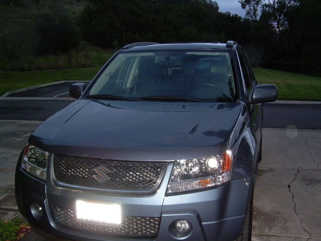

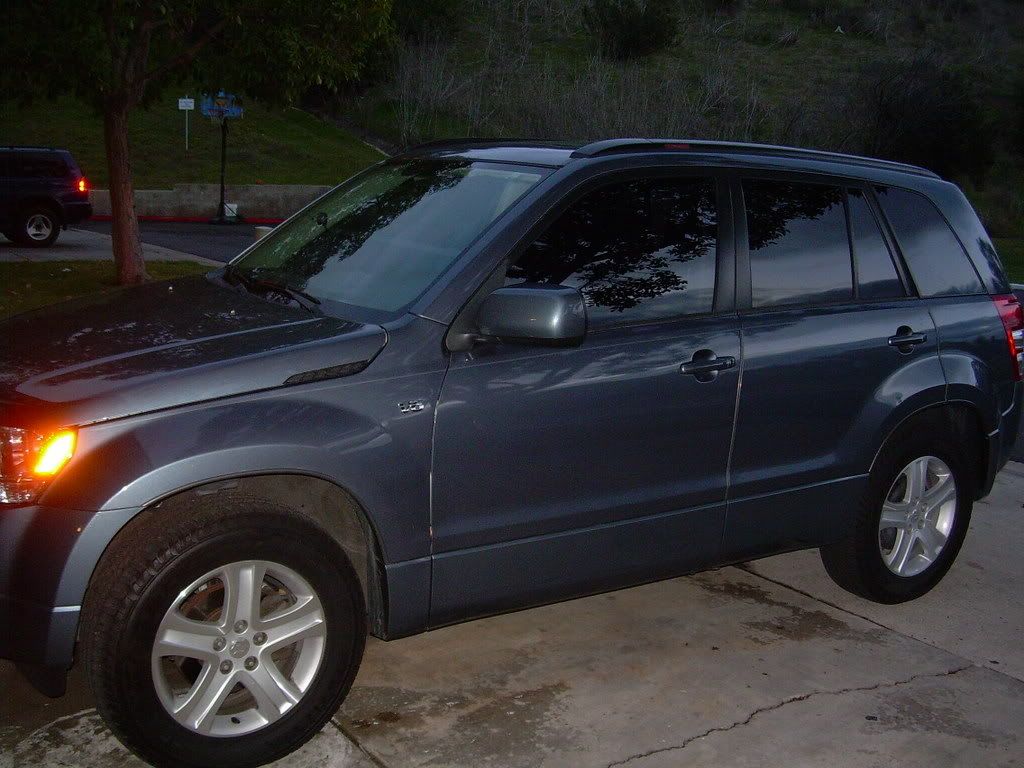

And the vehicle they're going into:

That W200 looks great in your dash- a lot better than it did in mine :) Build looks awesome too man. I'd love to hear it sometime. I'll look ya up the next time I'm in SD.
