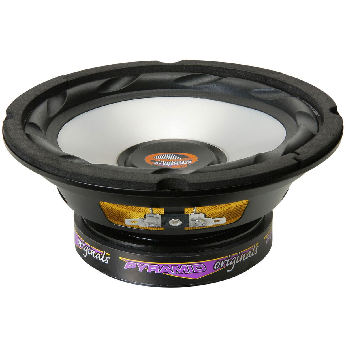

Have you considered parts express?

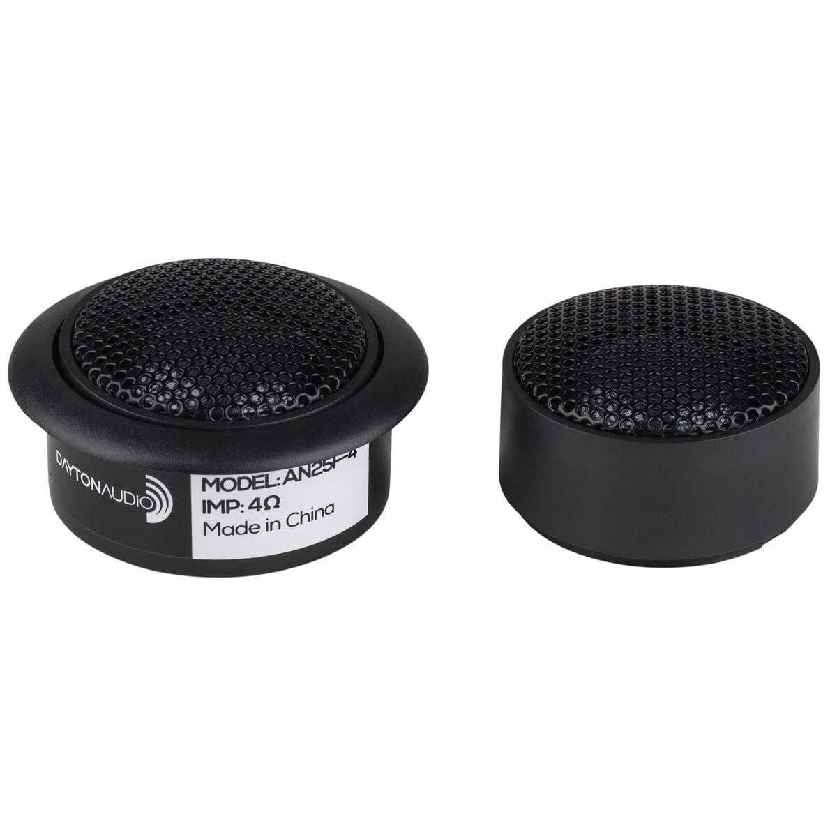

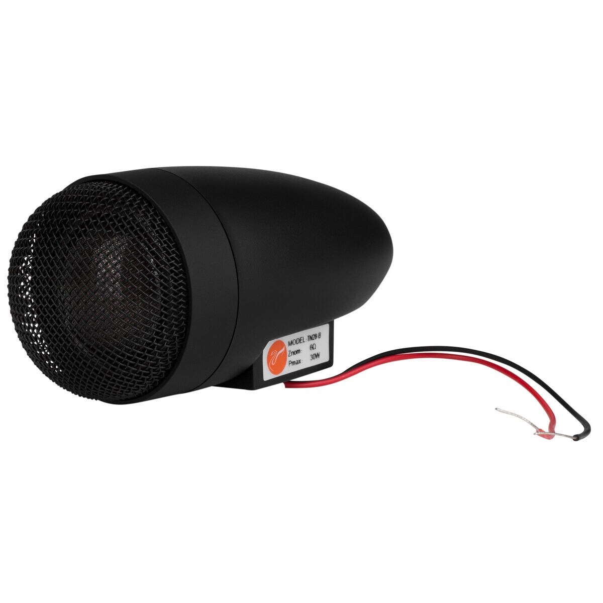

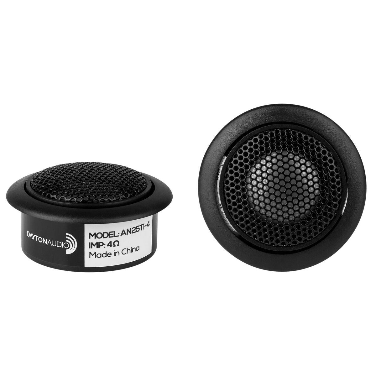

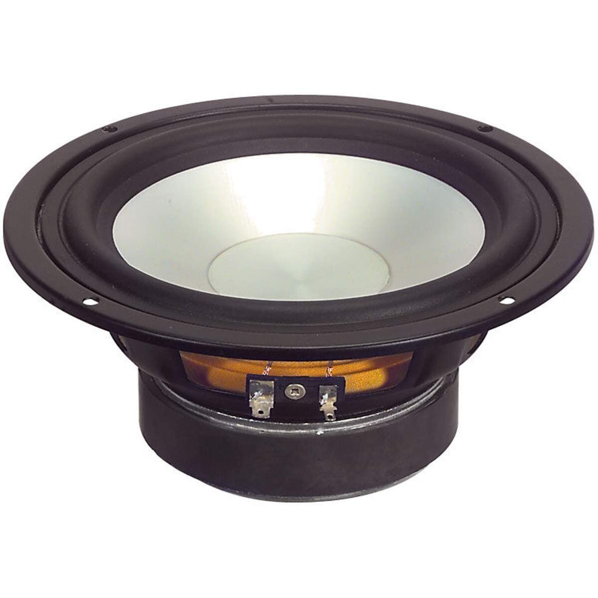

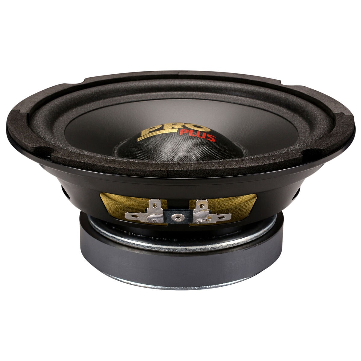

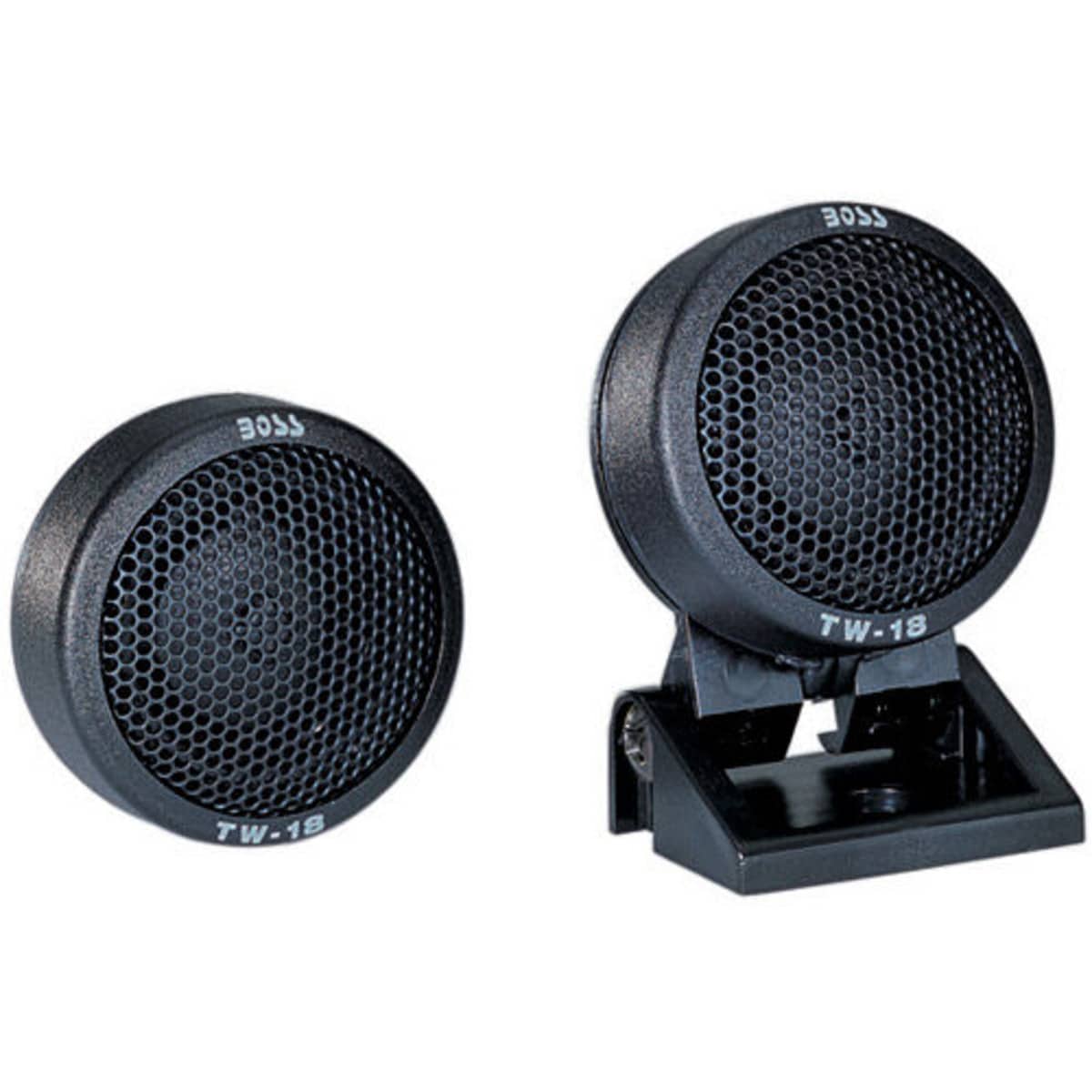

I will assume that the vehicle has 4 speaker locations.... front and rear doors. So, grab some Goldwoods for the front doors, some Pyramids for the rear doors, and a pair each of the Dayton tweeters.

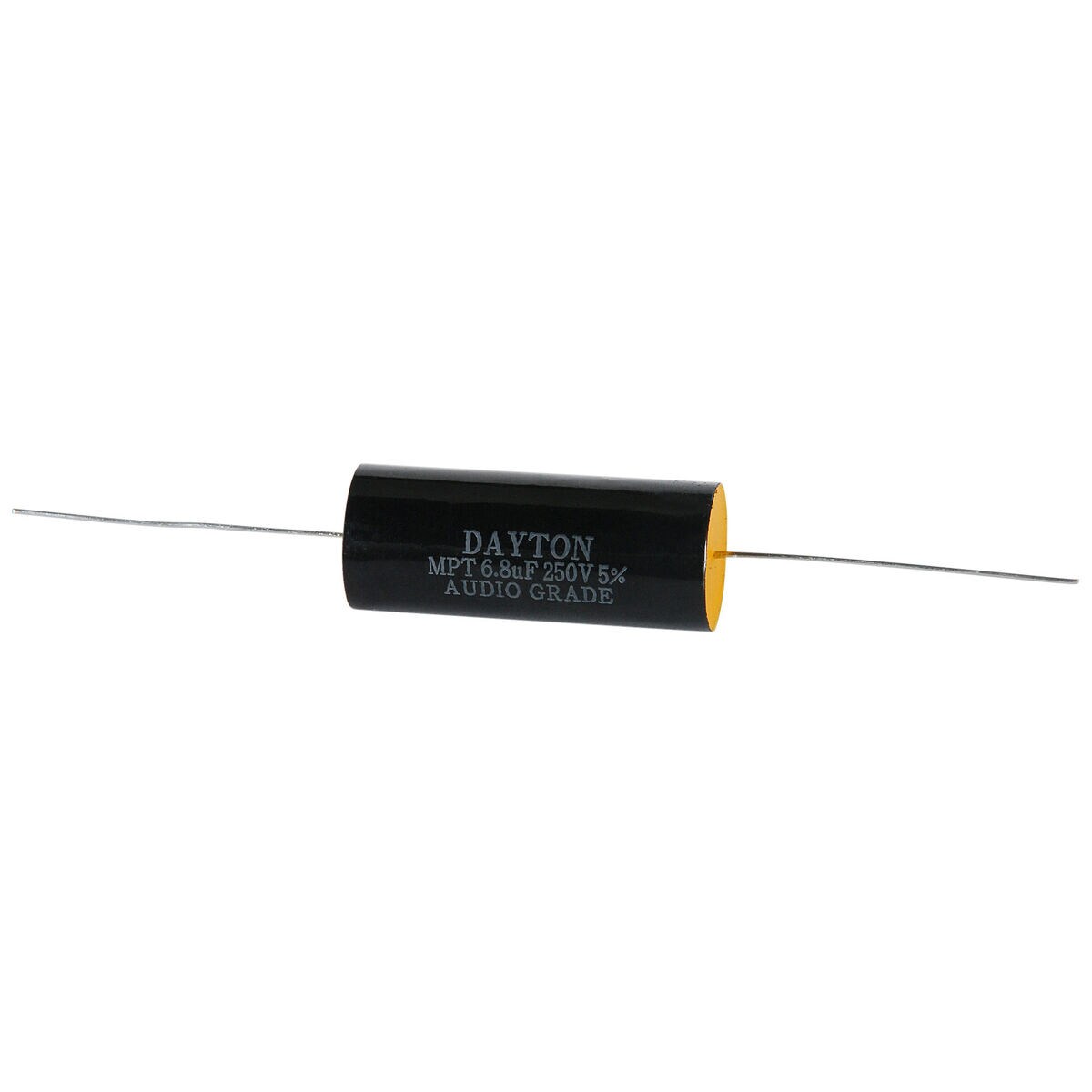

I don't think that I'd waste my money on ANY coaxial under $100. Any of the above tweeters should get a 6.8uf bass blocker capacitor. Woofers can roll off naturally and run full range.
And, you'll need 4 of these(1 for each tweeter)
