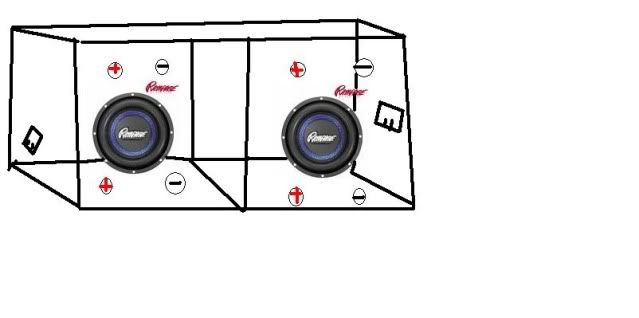

Discussion Starter · #5 ·
Ok like this the squares on the sides were terminals and yes my paint skills are horrible the picture is supposed to be the wires going to the terminals all positive going to positive terminal then positive in the amp same with negative
2,298 Posts
You missed one negative wire between the amp and the 2nd speaker but otherwise that's correct.
