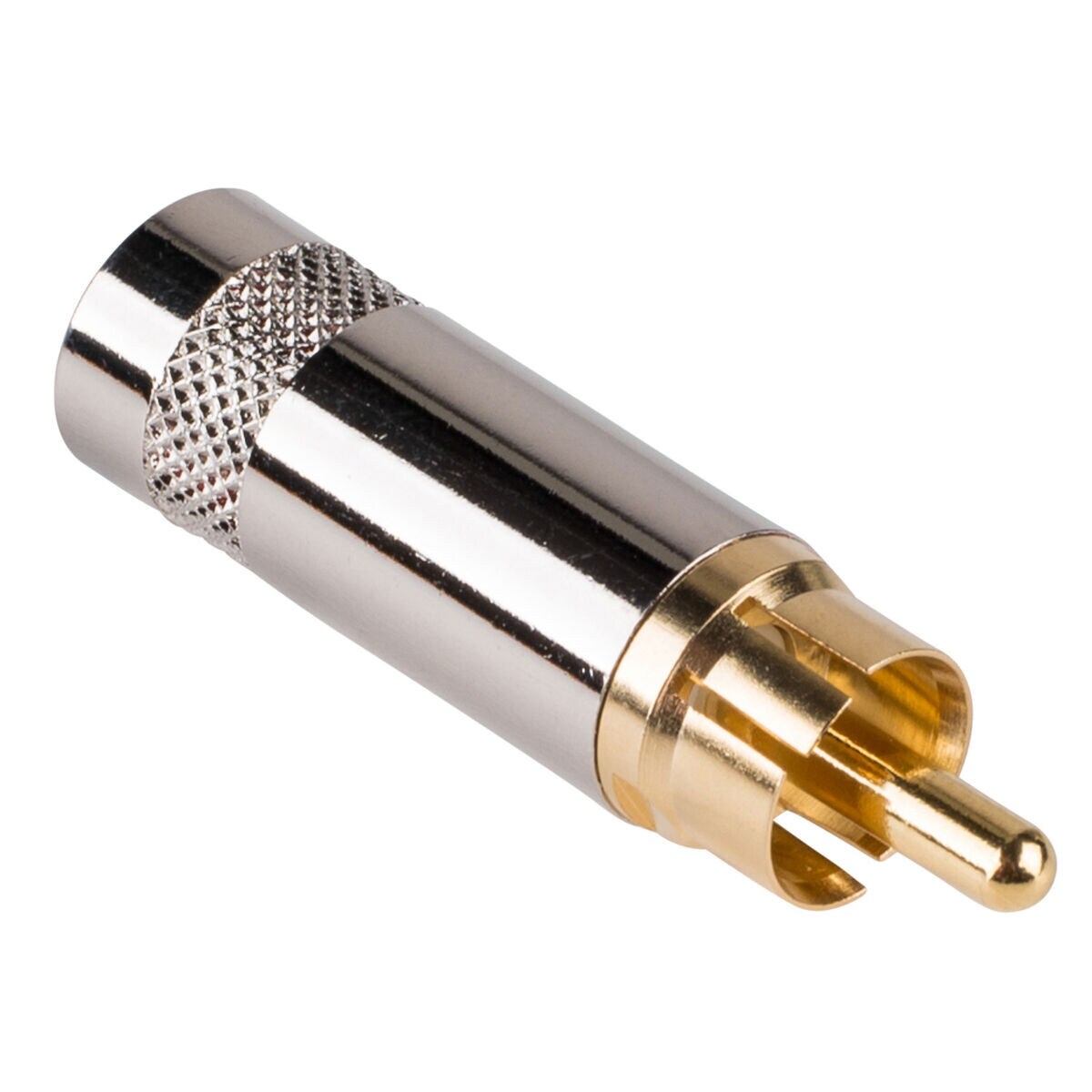

If I had to do them again, I would use Amphenol or a connector similar with extra crimping points.
I had two cables that needed the crimp point really pushed in for a good connection.
The Neutrik only has one on each side; if you're doing a sharp angle, the extra grip helps keep the rca in place.
If you go this route, get more cable and connectors than you need( I learned that the hard way).
