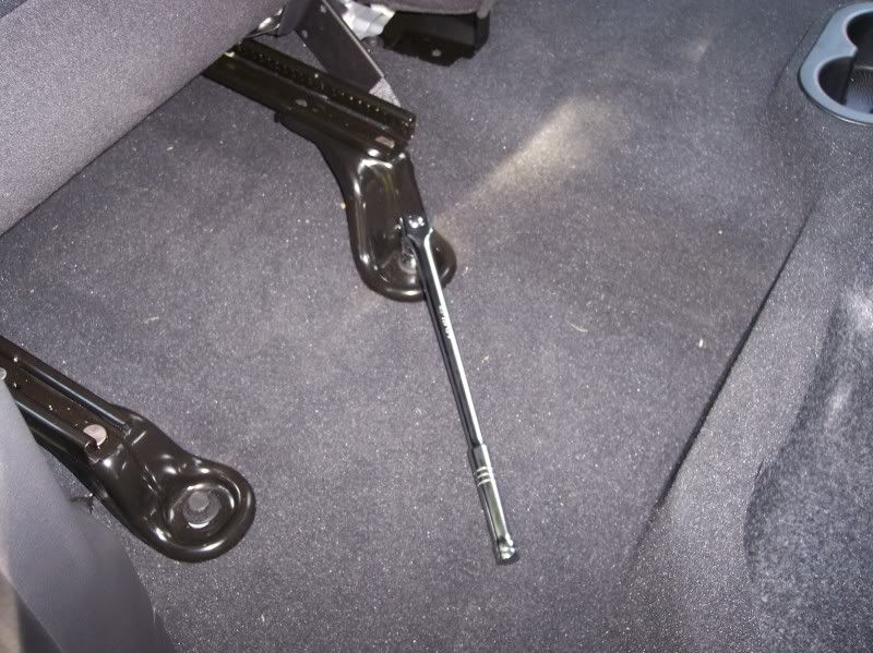

Loctite on the bolts made me have to use a swiveling breaker bar. It worked barely.

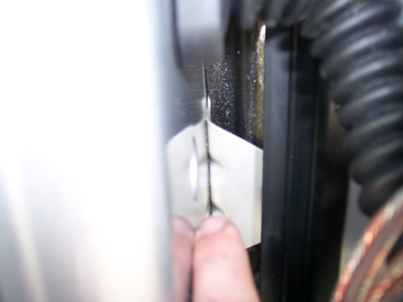

Brought my wires through an empty grommet going into the cab and under a piece of weather stripping. Had to step the wire down to 18g to make everything go back together right.
See how the 16g is keeping the trim from going back like a should from the thick high quality jacket. The 18g that I forgot to take a pic of has a really thin jacket so all you see is 2 pieces of wire going behind the panel. There wasn't a way to get in through the boot
