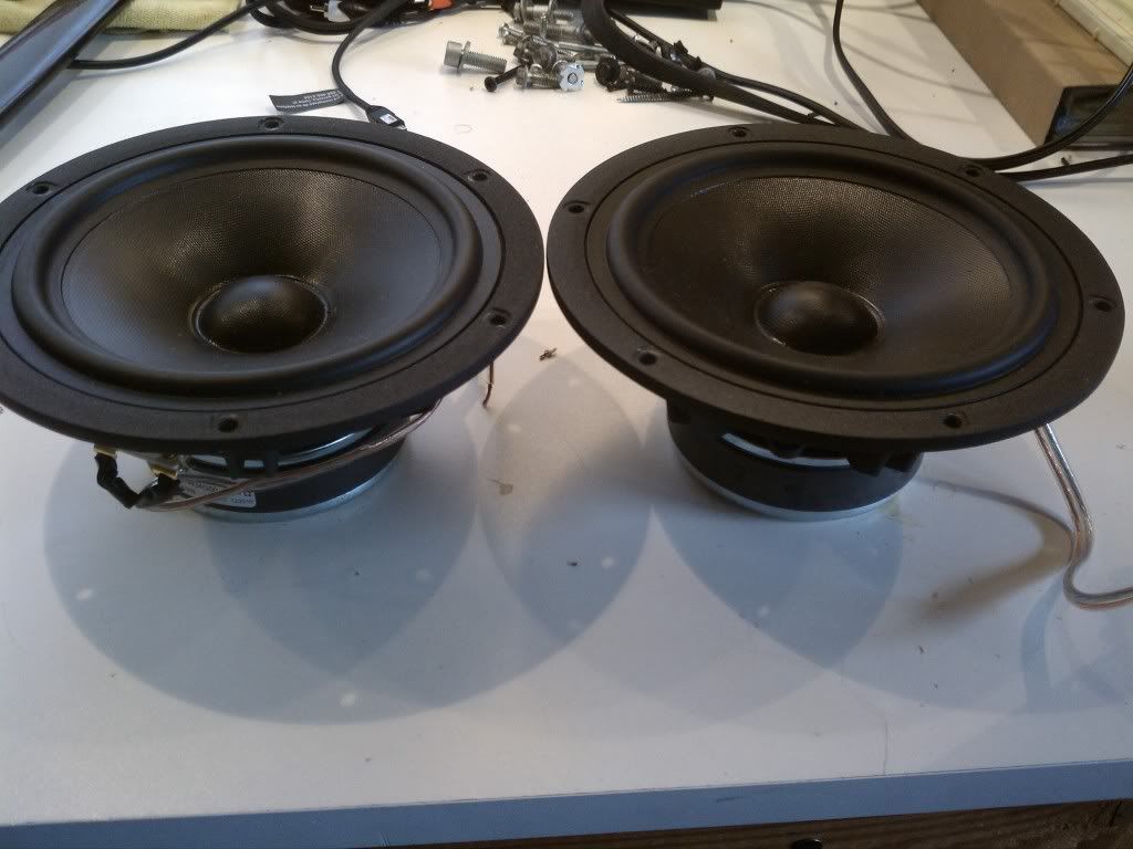

I've spent most of this year listening to a pair of Hybrid L6 mids.

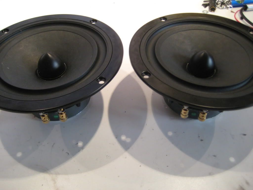

Yesterday I switched them out for some Scan-Speak 18W/4434G-00 7" midwoofers.
Scanspeak Discovery 18W/4434G-00, 7" Midwoofer, 4 ohm: Madisound Speaker Store
Although the Scan-Speak is described as a 7" midwoofer and the Hybrid is a 6.5", they are exactly the same size, with exactly the same bolt circle diameter, and the same depth, and the Scans dropped right in. The only difference is the Scans have 6 screws and the Hybrids have 4.

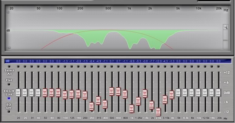

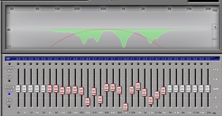

Here is the EQ curve I used for each speaker. The majority of the correction is due to my car's environment, not the speaker's response. In other words, these curves reflect my car's response curve, not the speaker's response curve. However, the difference between the two graphs is solely based on the differences between the speakers, so it is a decent indicator of their differences. Notice how the Scan-Speak is allowed to extend lower.
Here is the correction I had set for the Hybrid L6.
Here is the correction I arrived on for the Scan-Speak, with about an hour of tuning and listening. A few bands had to be pushed down, but I was able to ease up on the 1khz band, which was massively offensive with the L6.
It looks like the Scan-Speak should be a little quieter with more EQ suppression, but this is not the case. Interestingly, though the major EQ dips are shifted a little, the basic shape is the same, which leads me to believe I'm adjusting for my car doors, not the speakers themselves.
