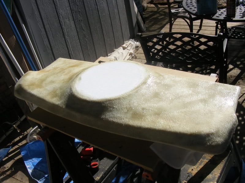

So im wanna try IB, however my car doesnt really have a trunk so its a little more difficult. Im taking a mold of on hatch cover and going to try IB and see what happens
Flush mount ring painted rounded over
Centered and test fit in the car
Wrapped
And resined, now im just waiting for it to dry

ok so im still building up strength with mat, would liked to use mdf but it wont work with what im trying to accomplish.
However i do have a question, somehow after releasing it off the mold, on the right side there is about a 1/4" gap between this baffle and the seats, this as we know if a big no no for IB, im trying to think what i can do to fix it, i thought about foam or building the area up with mat and sanding to perfection but there has to be a method with less material wasted
