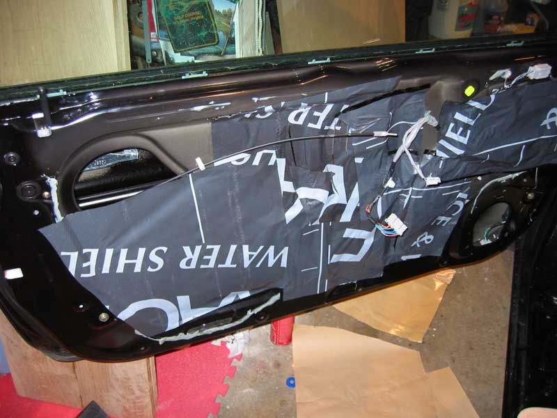

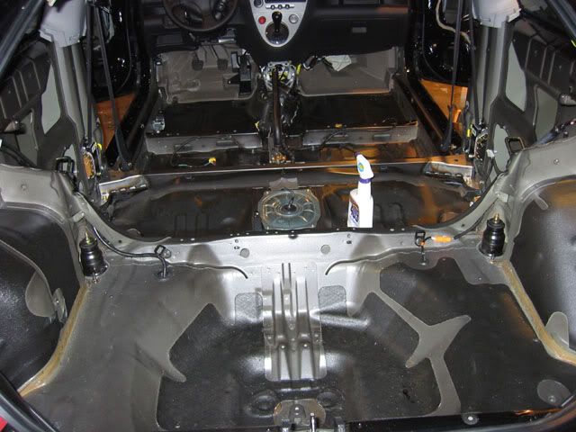

I've done a good amount of door prep, albeit using generic roofing asphaultic based dampening material, but 100 square feet for 55$ can't be beat. Jute also...
that is a good idea about the polarity, I had not checked that and honestly I was rushing through the install as it was beastly ass hot in the garage.
some pics of the 2 different times I had my car gutted for sound dampening, running wires etc...

man I know one thing when you gutted your car you really should have used some butyl based mat and some ensolite or other foam on the floors instead of that jute
man if you have a water spill you are going to hate the smell that stuff gets when it molds uuuughh
and your doors need some mat work also just my two cents--never thought it would maek that much difference till I did my car over three weekends
