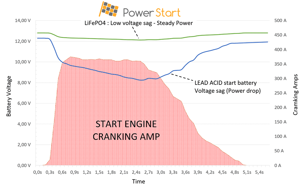

what you think about this voltage sag on these LIFEPO4 batteries?? :oops: :oops: looks pretty legit. i think these are 100 Ah battery comparison.
@Theslaking how much current/power will you draw form these batteries? the ah does matter from understanding,.... as it is a measure of amount of current/power that the battery can safety/reliably output over a certain time. i believe if you pull too high current from a smaller battery the voltage will lower , temp will increase and you would decrease longevity over time. so you would need to size the battery pack for your application. whatever is appropriate size-wise. i do not know what that answer is.... but.....
